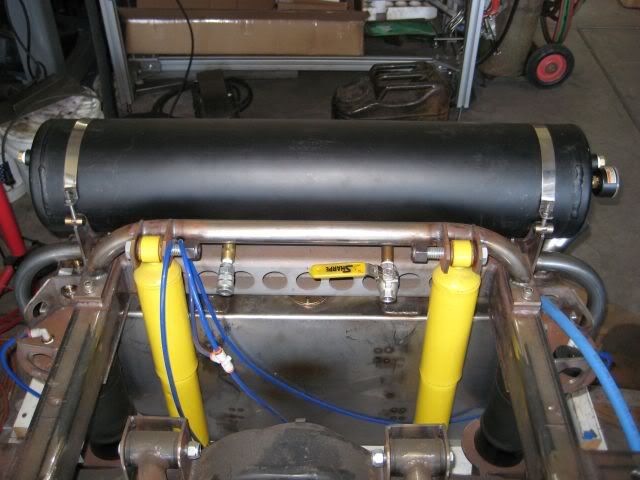

    Here are some pics of the restraints I made for the air tank. I took some sst. band clamps and small dia. tubing to make the ends. Welding the thin strapping material was fun. Here are the pic's:
    This pic shows the one end of the strap restraint. I have some thin sst. strap welded to tubing then some small flat bars to create a double link. Everything is held together with a couple of #6 shcs.
    At the other end of the strap restraint I have the gizmo shown below. To the sst. strap I welded a piece of angle with a hole in it. The bolt shown has been replaced by a piece of all thread and nut to give me lots of adjustment. The all thread is screwed into a piece of round bar with a threaded hole in it. This round bar is slid inot a tube with a slot in it to allow it to pivot.

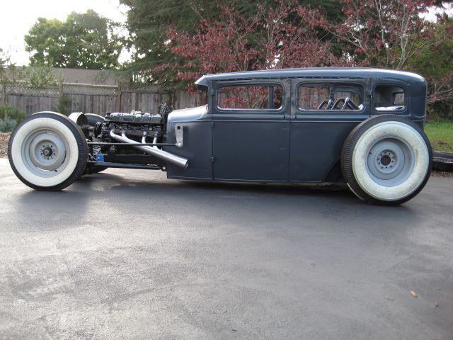

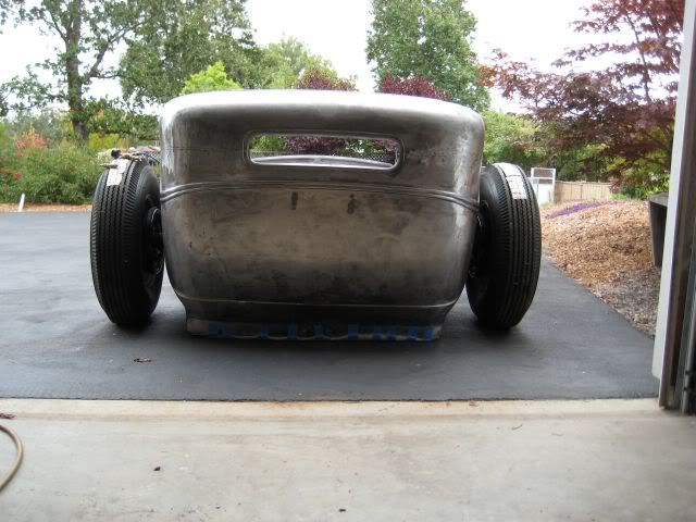

    In a tribute to BilletProof I rolled the car out of the garage for a photo shoot. Well actually I needed to clean the garage around where the car has been sitting for the majority of the past 3 years :D. Anyway here are some pics of the sedan.
    The first four are with the chassis aired all the way up:
    This set of four pic's is with the chassis aired out:

    Lovin it man! So are you able to air up the rear bags high enough to be able to fully open the rear doors?

    beautiful work, how much air do you have between the ground and the body?

    Thanks. It is 6" at ride height
    Thanks J. No the rear doors are more like access panels. The idea is to unlatch and then pull the hinge pins when you need to access the removable sheet metal panels inside the car at the rear kick up.

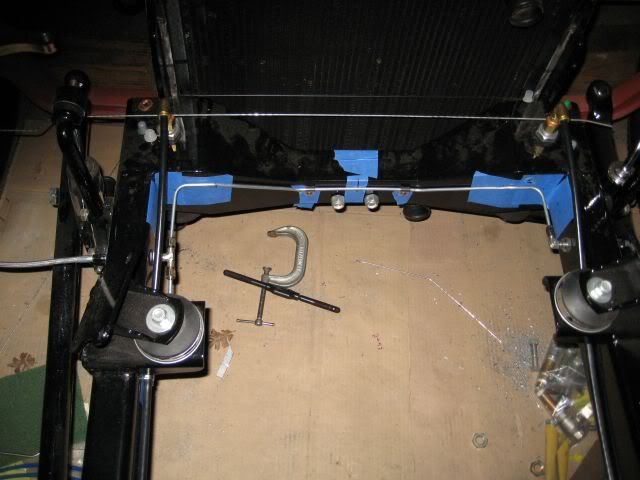

    A ran brake lines on the chassis recently. Not the easiest thing to take pictures of but I do have a few. My brake lines are 3/16 steel with AN fittings. Here are a few shots of what they look like:
    Chassis front:
    Hard line on the Ford 9":
    I have hanging pedals mounted to a tubular structure in the cowl of the car. I decided to run hard lines out the master cylinders to three bulkhead fittings mounted to the floor kick board. On the other side of the floor I jumper to the hard lines on the chassis with some flexible stainless lines. Here is what the hard plumbing at the master cylinders looks like:

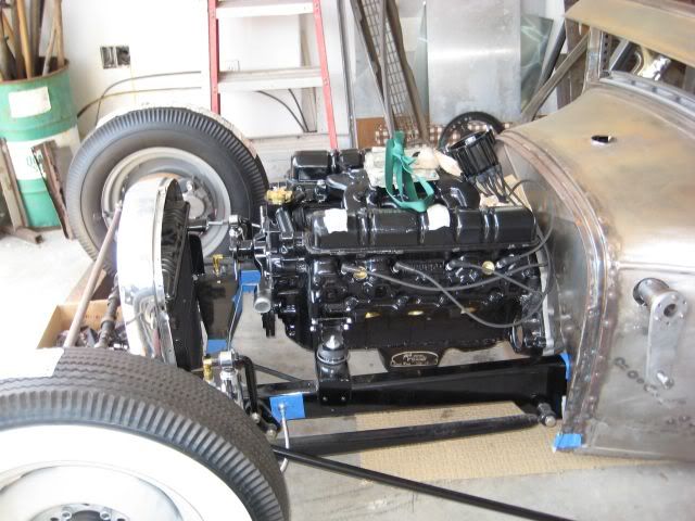

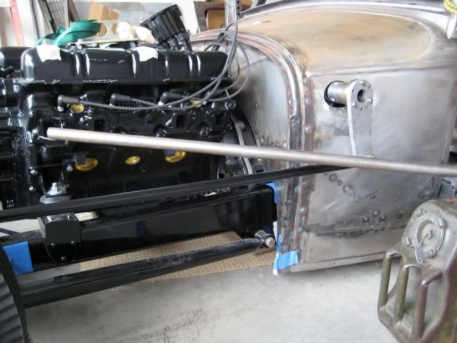

    The chassis was finally ready for the motor. So today I retrieved it from my brothers garage and installed it. The pictures tell the story, but I will add the gantry crane I built a year ago sure made it easy.

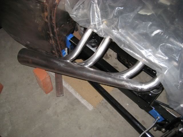

    Built some lake headers for the car. Started with a kit from lakeheaders.com:
    Spent some time trying decide where I could place the header relative to drag link:
    Decided to shoot the megaphone down below the drag link. With that decided I started with the front most tube to establish the angle of the megaphone. Then moved to the last tube to establish the distance from the cowl. There are several good threads documenting this process. Here is what the headers looked like as they took shape:
    Once I had everything tacked up on the driver side, I proceeded to make the mirror image for the passenger side. I clamped the two headers together and established some measurement points on the welding table so I could create a mirror image of the tacked up drivers side:
    After I had two duplicates tacked up the only thing that remained was finish welding and grinding for a nice finish. I will mention I also welded the inside of the tubes to the header flange. Here is what they ended up looking like:

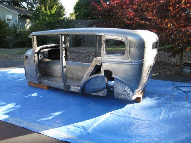

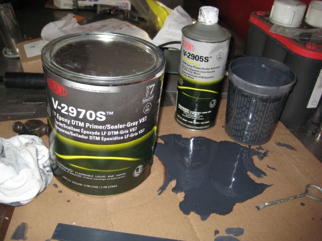

    Decided to put the car in epoxy primer last year. Holy smokes that stuff is expensive, nearly $500 for primer!! Here are a bunch of random pictures showing the progress. As you'll see, I used a cheapo Harbor Freight gun and shot everything in the driveway.
