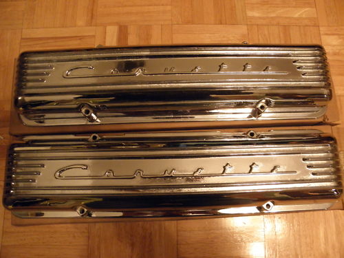

    The other question is -How hard is it to obtain the staggered bolt heads that the early Corvette valve covers use? I notice that the early covers 55-60 are staggered and after 1960 they are the straight in-line bolt holes. It would seem to me that the later model "Lester" valve covers with the straight bolt holes would be the more desirable ones. Is this correct? Thanks in advance-Mikey

    mid model year 59 is when the valve covers changed.

    The stagger heads are not really rare, the ones that were used on the 58-59 vettes and 4bbl car engines can be worth a bit. I sold a pair of 58 X heads for five bills a few years ago.

    What is a Lester?

    Lester was the casting company that made the aftermarket cast aluminum valve covers for Chevy, before that Hoover, of vacuum cleaner fame, was the company doing the aftermarket castings for Chevy.
