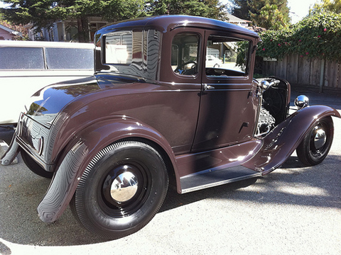

  6. JeffreyJames
    Joined: Jun 13, 2007
    Posts: 16,599
    JeffreyJames
    from SUGAR CITY
    "A" frame, full fenders, sbc with 3x2 and a '39 trans behind it. '40 Ford wheels (47 ford caps) with 7.50's out back and 5.50's up front. BLC-J headlights on a dropped bar, Pleated interior with a '47 Ford steering wheel.
    Kinda like this in terms of stance....
  7. brandon
    Joined: Jul 19, 2002
    Posts: 6,324
    brandon
    Clean ride above.....stance is right on
