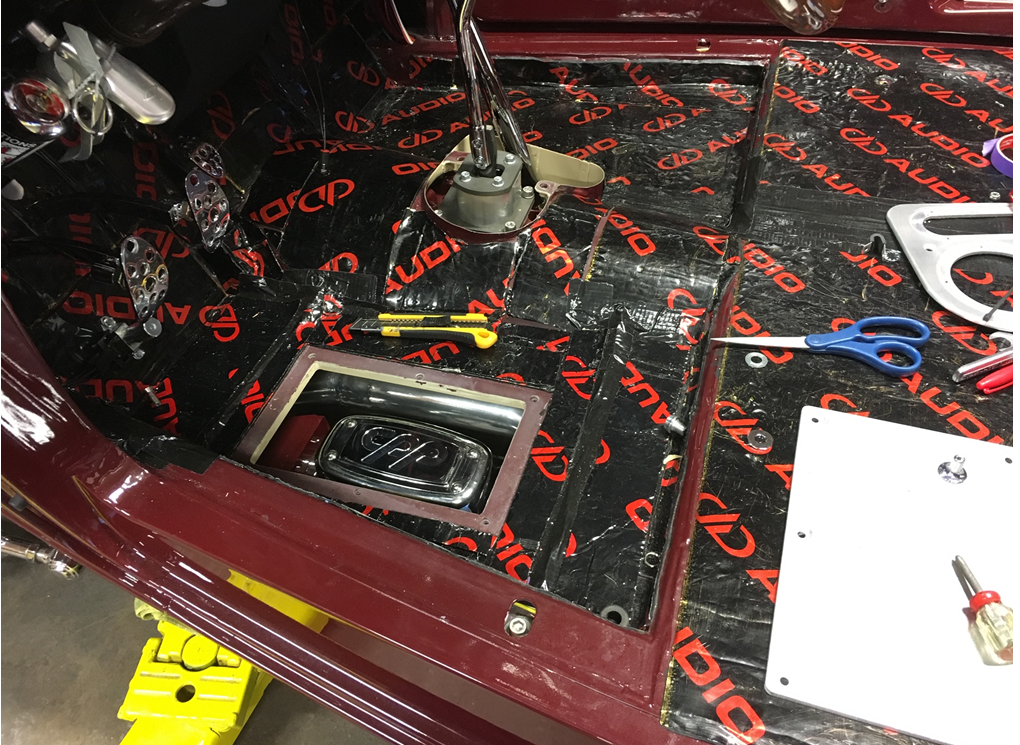

    I bought this stuff from a local audio shop. Weighed about a ton which I why I had to add the blower to the flathead. For a roadster, with a 471 and a QC in the back, it is still pretty damn quiet. I did the firewall, doors, trunk, floors, quarters. It does sound cool when you shut the doors. Not traditional, but cool. This stuff is the same thickness as my MC cover so it is recessed basically in the sound deadener.
