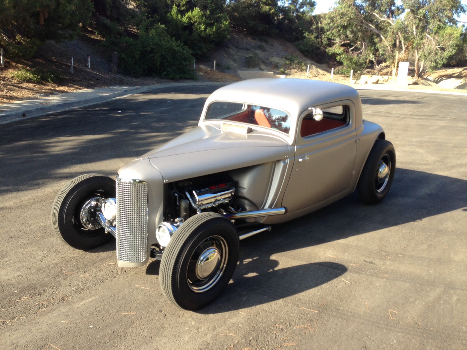

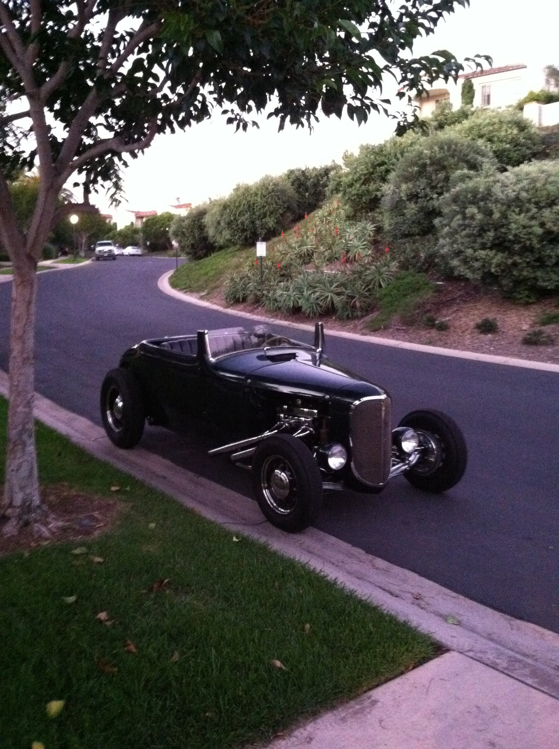

    Great work! Here's a few built along a similar line. Green roadster started as a beat up sedan cowl and doors and image.jpg the silver coupe started as a four door humpback sedan. image.jpg
    1blown57, BradinNC, kiwijeff and 4 others like this.
