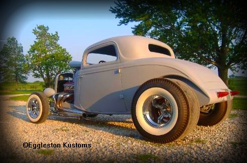

    Looks great. I know Eggleston Kustoms did this but with a 34 four door into a coupe if you go to his web site and look for the car he built Panic attack he has some good pictures of the build here is his web site http://www.egglestonkustoms.com/projects2011.html 34coupenew2.jpg also here is the finished car.

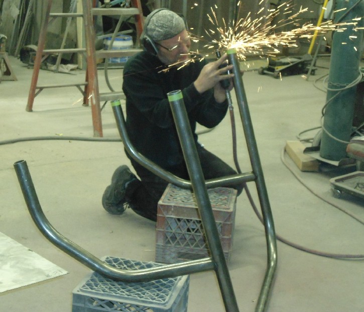

  30. "Tacked welded the 1/4's to the B pillars and started looking at building a mount for the trunk hinges. I'll run supports up from the floor to the sides of the hinge mount. I'm thinking about putting in a 4 or 6 point roll bar and would like to tie this into the rear bars. Now would be a good time to fab the rollbar with the roof off but didn't have any tubing. I'm going to figure this out before the roof goes on to make welding easier.Tack welded the top panel for look at trunk alignment."
    I made up a 4 point bolt-in bar for my 5 window that [after removing the rear tinwork] tilts forward and comes out the passenger door. If you're interested, most of the build/installation is covered in my thread.
    Makes it so much easier to do the finish welds on the bar and it's removable to do interior upholstery work. Can be painted or chromed and re-installed. 34rollbarjimmy.jpg 34rearwall3.jpg
