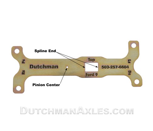

  11. Jmountainjr
    Joined: Dec 29, 2006
    Posts: 1,678
    Jmountainjr
    Spend about $20 for a "dog bone" tool and it will answer all of your housing and axle shortening questions. It's cheap insurance to get it all right the first time.

    How did you narrow it with the backing plates on?
    Whats a 'dog bone' tool?
  13. Jmountainjr
    Posts: 1,678
    Jmountainjr
    Like this:

  15. Where do you obtain a "dogbone" tool?
  16. Jmountainjr
    Posts: 1,678
    Jmountainjr
    I got the one pictured from Dutchman Axles. It's listed in the tool section. I only bought the Ford 9", but they make several.

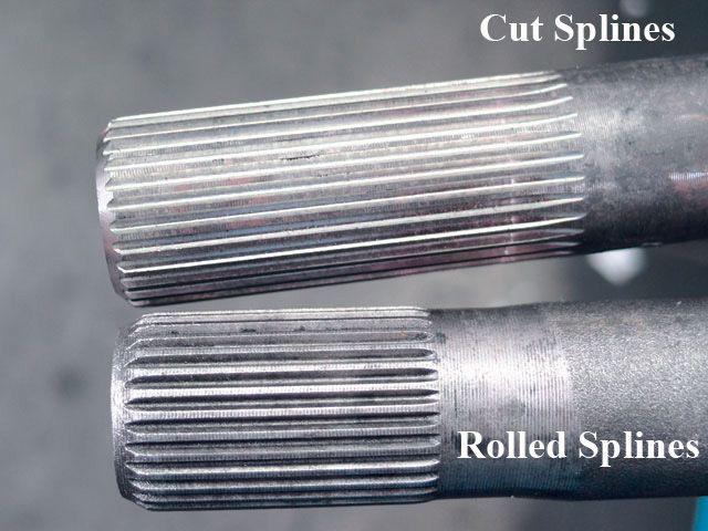

    If these are factory axles you may not be able only to take an 1" out each end. Usually on the axles at least 4" is taken off and than the resplining done. Found out the hard way, sent some axles out to Moser and was told they couldn't do it. I needed less than the 4" removed also.

    Thats a slick tool, i'll have to invest in one of them.. I have the alston narrowing kit i bought back in early 80's and it came with a plate to bolt onto the housing that locates the pinion - for making drag race rears where the pinion is centered.
    thanks, oj

  21. The dog bone is neat, but not really necessary IF you have the original donor axles. As mentioned, they should be shortened the same amount as the housing (or new axles ordered based on the original lengths).
    If you are building a complete rear end from scratch, that dog bone is very helpful.

    I find the dogbone usefull when shortening a housing to double check pinion offset and tube length before welding. Also nice to confirm axle length once you know what brake offset to add to the dimension from end of axle spline to end of housing length.
  23. Relic Stew
    Joined: Apr 17, 2005
    Posts: 1,209
    Relic Stew
    from Wisconsin
    The factory splines are rolled in. The starting diameter is smaller than what is needed for cut splines, so the reduced diameter section needs to be cut off, and the new splines cut into a full diameter section.

    Leadmine products, a dealer on Ebay also sells a version of the "dogbone". I like it. A marked/punched flat piece of sheet metal that fits the housing. Shows axle centerline, pinion centerline, housing opening centerline and height, axle length.

    That dog bone is the shizzel i will be getting one of those.
