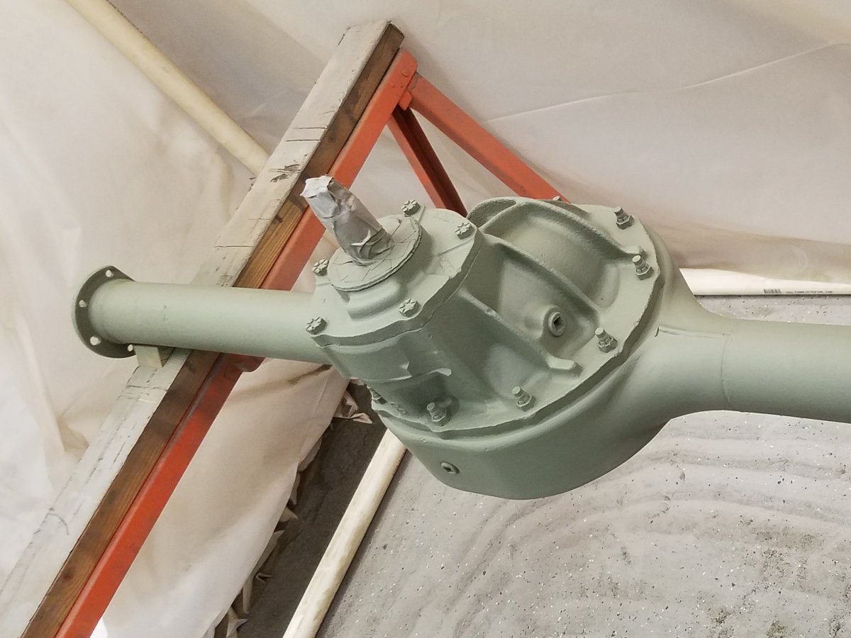

    Hey all,
    Trying to wrap my head around flange offset. I know what it is and how it's measured.
    Problem: I would like to change it to a more standard 2.5"offset. I've got a '57 ranch wagon rear and it's got an oddball 2.390" offset. As far as I can tell it is the axle that determines offset. Researching bearings and weld-on housing ends there are no specs on bearing thickness or bearing pocket depth. Am I correct to assume that these are all the same?
    Also, leaning toward replacing the ends on the housing, the bolt pattern is also an oddball. Is there any benefit to switching to big bearing?
    Thanks,
    Jeff

    What is the 'wierd' bearing retiner bolt pattern. I'm no expert on 9" Fords, but I'm pretty familiar with axle bearings and offsets because the same parts are used on the Quickchanges I build.
    Can you post some pictures of what you have?

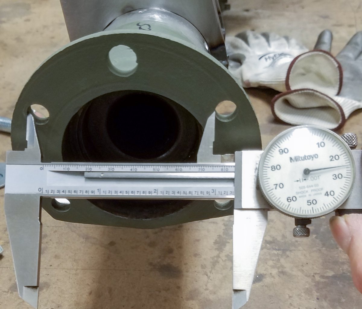

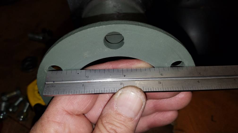

    Was told it was from a '57 Ranch Wagon. As you can see, the dimension is 3.325". It is the correct 2" the other way. Bearing is 2.835" O.D., and 1.378" I.D.

  11. I have what is supposed to be a 9" out of a Galaxy and it has the same measurements.
    3.325" x 2.00" with a bearing OD of 2.835".I looked on a few sites but nowhere were these measurements mentioned.
    Close to the small ford/early mustang spec but they are supposed to be 3.375" x 2.00"

    Here is something interesting, the axle flange guide we all see when Googled says the small Ford bolt pattern is 3.375"
    Wilwoods website shows it at 3.336, what's up with that? So of course I had to recheck my flange yet again. Needed to use the cheaters to see it, but it's not that either.

    Looks like small ford pattern to me. Only one of your measurements is off by a mere .011" which could be production tolerance or even a burr around the edge of the bolt hole.
    You just have to figure the brake offset.
    I suppose it is possible somebody put the wrong width bearings in there. or left out some spacers.

    No burr, all holes are clean and all measurements consistent. Interestingly tho, I just checked the backing plates, they DO measure 3.336 exactly.
    Another Hamber also has oddball 3.325 pattern flanges. I wonder if a few mis-adjusted drill/punch parts made it through QC.
    Does this mean there are both 3.336 AND 3.375 pattern small bearing flanges out there?

    Pretty sure all small bearings are 3.336. There's a lot of BS on the internet. I edited my last post with other possibilities.

    I think the measurement should be from the back of one hole to the center of the other . that's how manuf. measure bolt pattern
