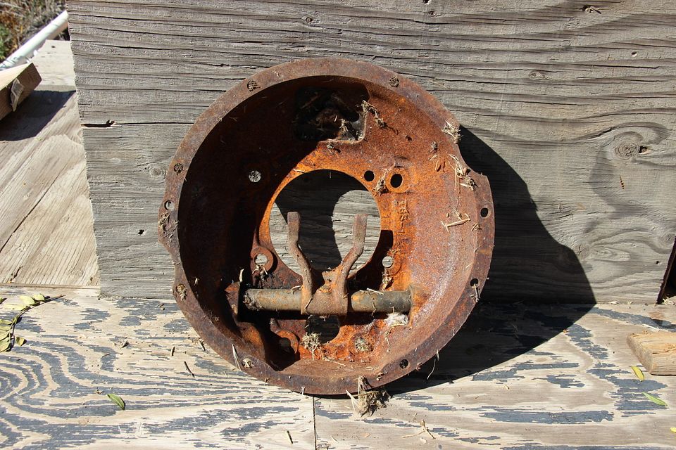

    This is the hogs head off my flathead [​IMG]
    On the 52 Ford F-1 4 speed ( this is an extra that I have)
