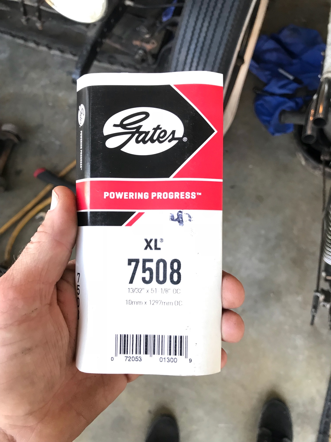

    Found the generator belt. Used a piece of Romex to get the measurement. 51” seemed to be it. [​IMG]
