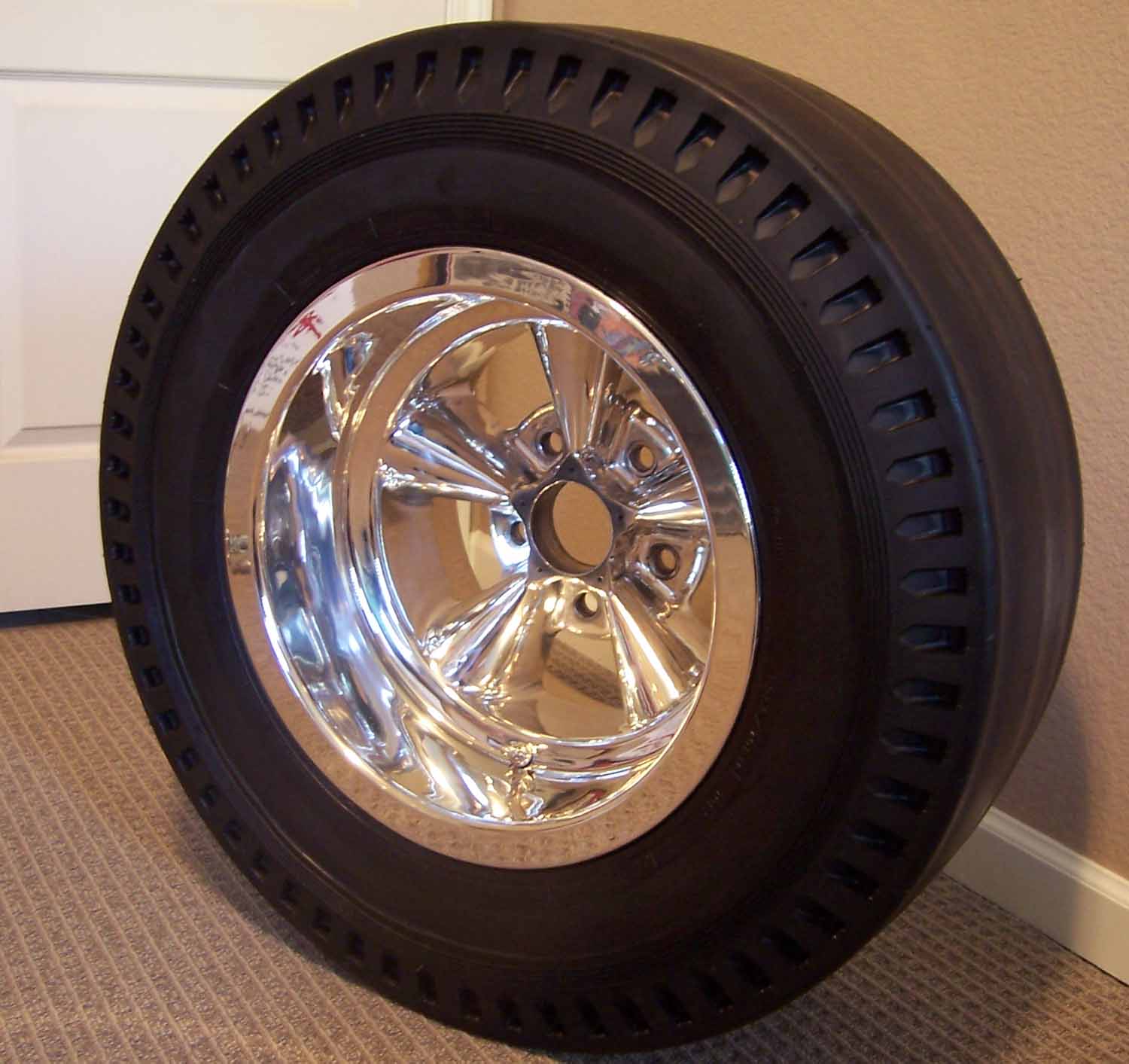

    Dad should have told you the 8" rim on our 30x10's gives you 10 3/8" to 10 1/2" cross section.
    And the 10" rim on our 30x10"s gives you an 11" cross section
    8's should be dam near flat accross the tread face. The attached pictures are 10" wheels on our 30x10's
    Hope this helps you.

    Thanks for the pics Cody. I'll be ordering soon.
