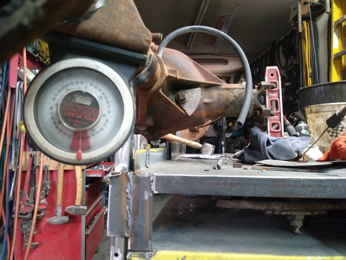

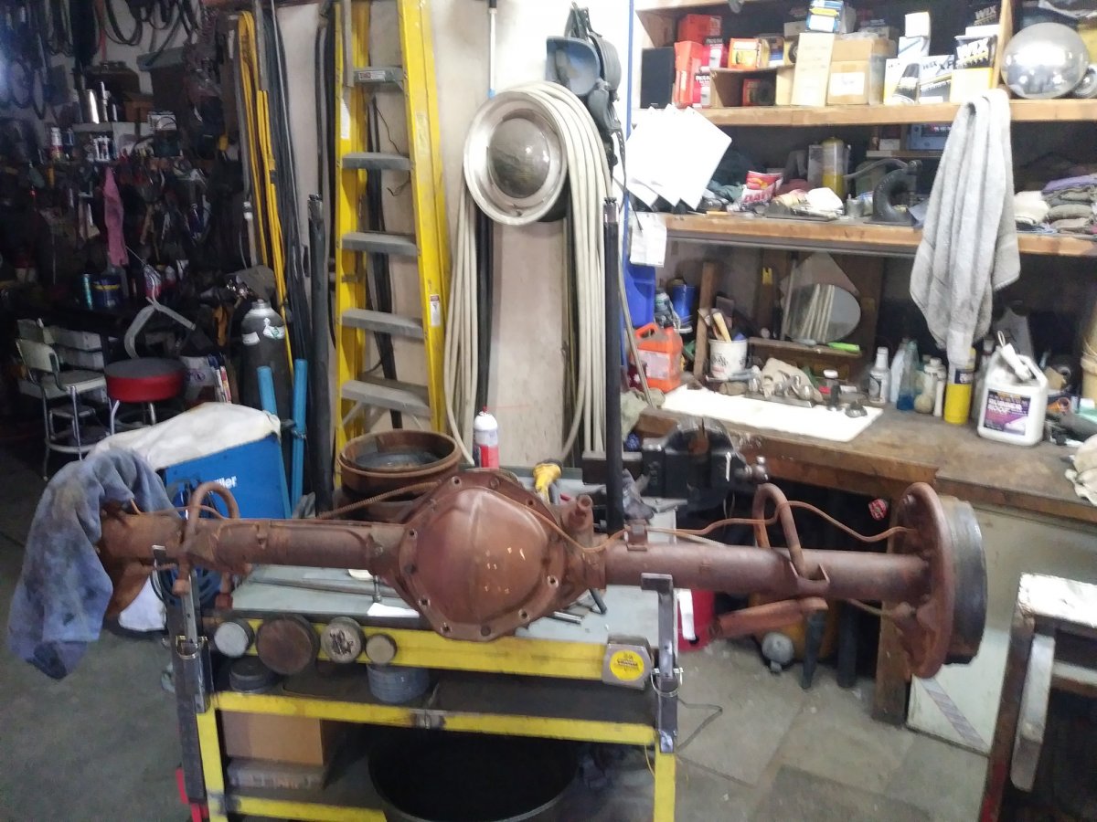

  12. Resurrecting an old thread here as it is time for my little truck to find a new home. I just don't drive it much since quitting the day job and life has changed unexpectedly recently. Since my last update the original old corporate rear axle started howling pretty good so a few months ago I installed a fully rebuilt 12 bolt posi-traction unit out of a 1967 C-10. It's a 1:3.73 gear and really drives nice behind the 700R4. And I know, pictures or it didn't happen so here they are.

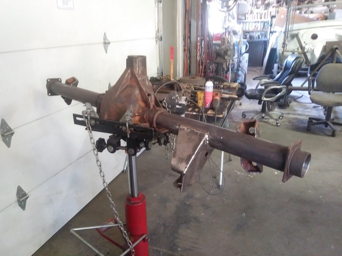

    Here I am measuring all the angle so I can match them with the relocated truck arm perches and panhard rod mount. Then tore the donor axel down and moved the perches and fabricated a panhard mount from 3/16" plate. I had to cheat on the bends in the plate and pre-cut them with the plasma torch about 75% of their length (0.75" out every inch).
