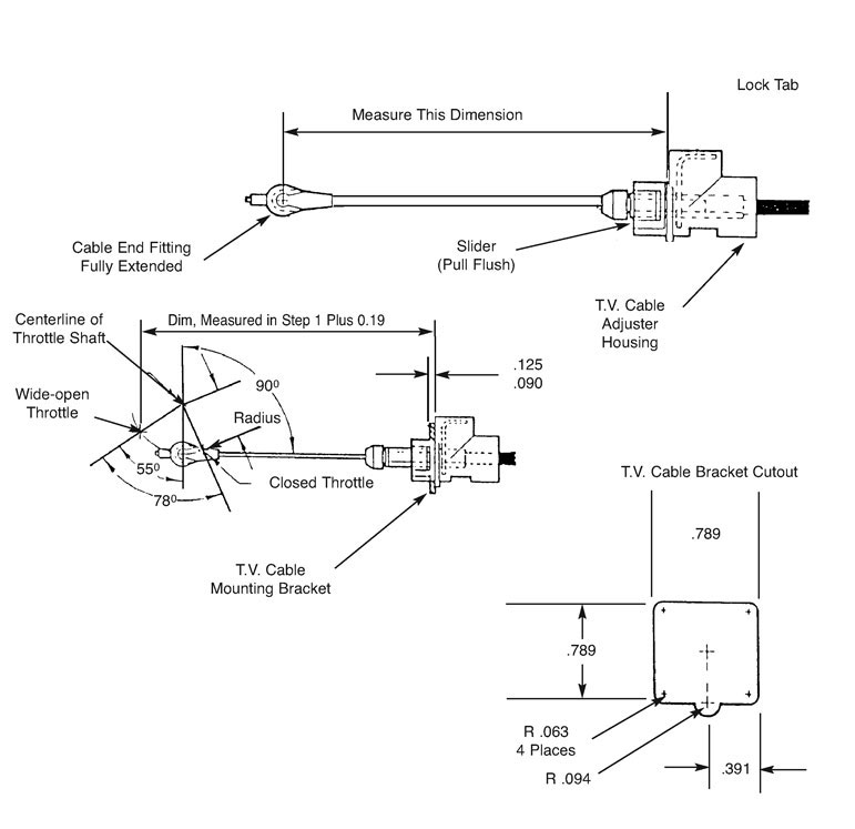

  8. I've never come across a carb or injection setup that won't run a TV cable.
    You'll need to fab a bracket of sorts. I hope this helps.

    thanks for the advice about the TCI constant pressure set up as well as the diagram for a bracket..

    Fourspeedwagon is right....constant pressure valve body keeps cable.
    Here is a reasonable web page about making a linkage. The chordal length (the length that the cable is pulled) is important....therefore, the radius of the arc and the number of degrees of swing are important
    http://purplesagetradingpost.com/sumner/techinfo/700R4p7.html

  19. I made the linkage for the 700R in my '40 Chevy using Sumners sketches on the Purplesage link. Never any troubles.
    Charlie

    Agreed, we have run a lokar tv cable double nutted through the firewall and attached the the thottle linkage. What you need is an inch and an eighth to inch and a quarter total cable travel from idle to wide open throttle, and at wide open throttle the tv cable should be as tight as it can possibly be. If you have these two parameters you are good to go.

    I run a 700R4 . I think people make too big of a deal about the TV cable. Read the setup procedure for the cable and you'll find it is simple. On the FI I would go to Bowtie Overdrives and see what they offer for a throttle quadrant to ensure correct idle to full throttle positioning of the cable. Good luck.
