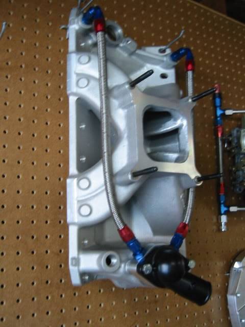

    However, a rear crossover has been used for many years on dragsters and race cars. Looks like Edelbrock now
    has the rear flanges tapped for fittings, so check them out. Here is a quick photo of how one guy did it, but
    not a blower manifold. The idea is the same. Good luck and have fun. manifold-1.jpg

    Looks to me like those hoses just make the coolant bypass the cylinder head, and prevent the cooling system from working properly.
    But what do I know, I'm just a dumb engineer.
    hemihotrod66 likes this.
  8. DDDenny
    Posts: 19,265
    Yeh, was hoping for input, been sitting on the cart like that for years, only seen dyno time.
