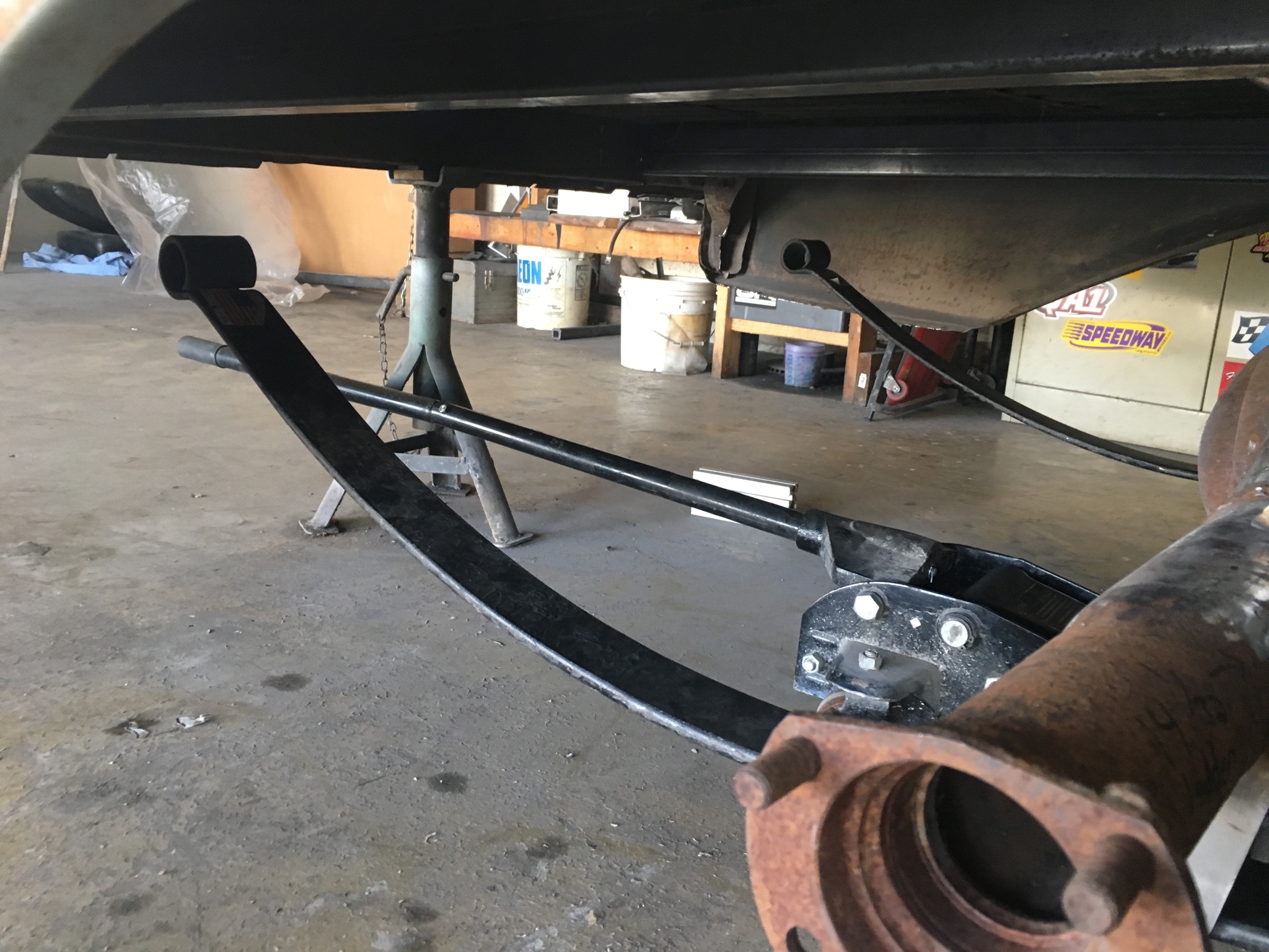

    Not to much too show, been stuck finishing up my sisters car for the meltdowns. Currently working on putting the springs under the car [​IMG][​IMG][​IMG]

    You get them springs special or take apart a pack and only using one?
    loudbang and colbyw like this.
  9. colbyw
    Joined: May 16, 2016
    Posts: 72
    colbyw
    They are mono leaf springs from a 1st gen camaro they came on the convertible cars

    Those mono leafs work good. Had them on a 68 camaro with floaters and ladder bars years ago.

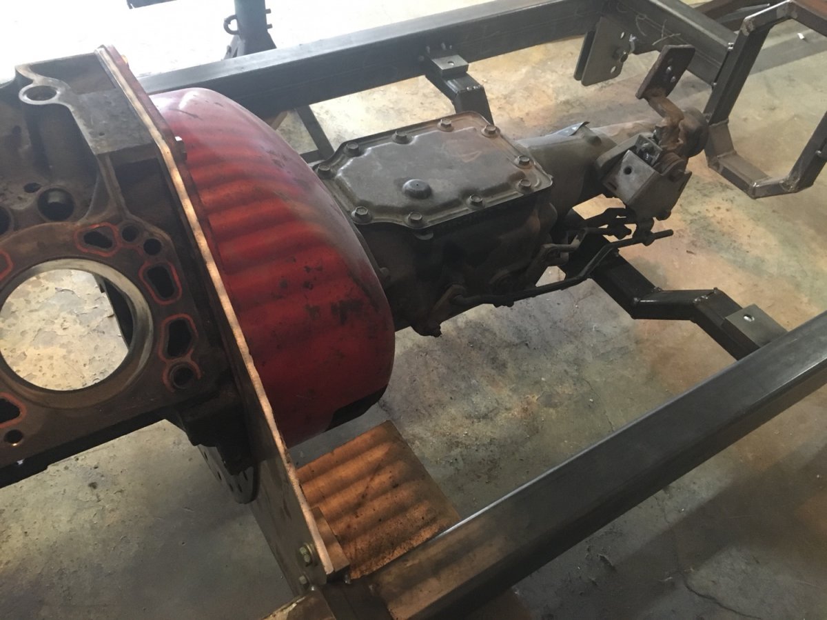

    Got the motor mounts, transmission crossmember, front end, and mid plate in place. Cage kit should be in within a week.

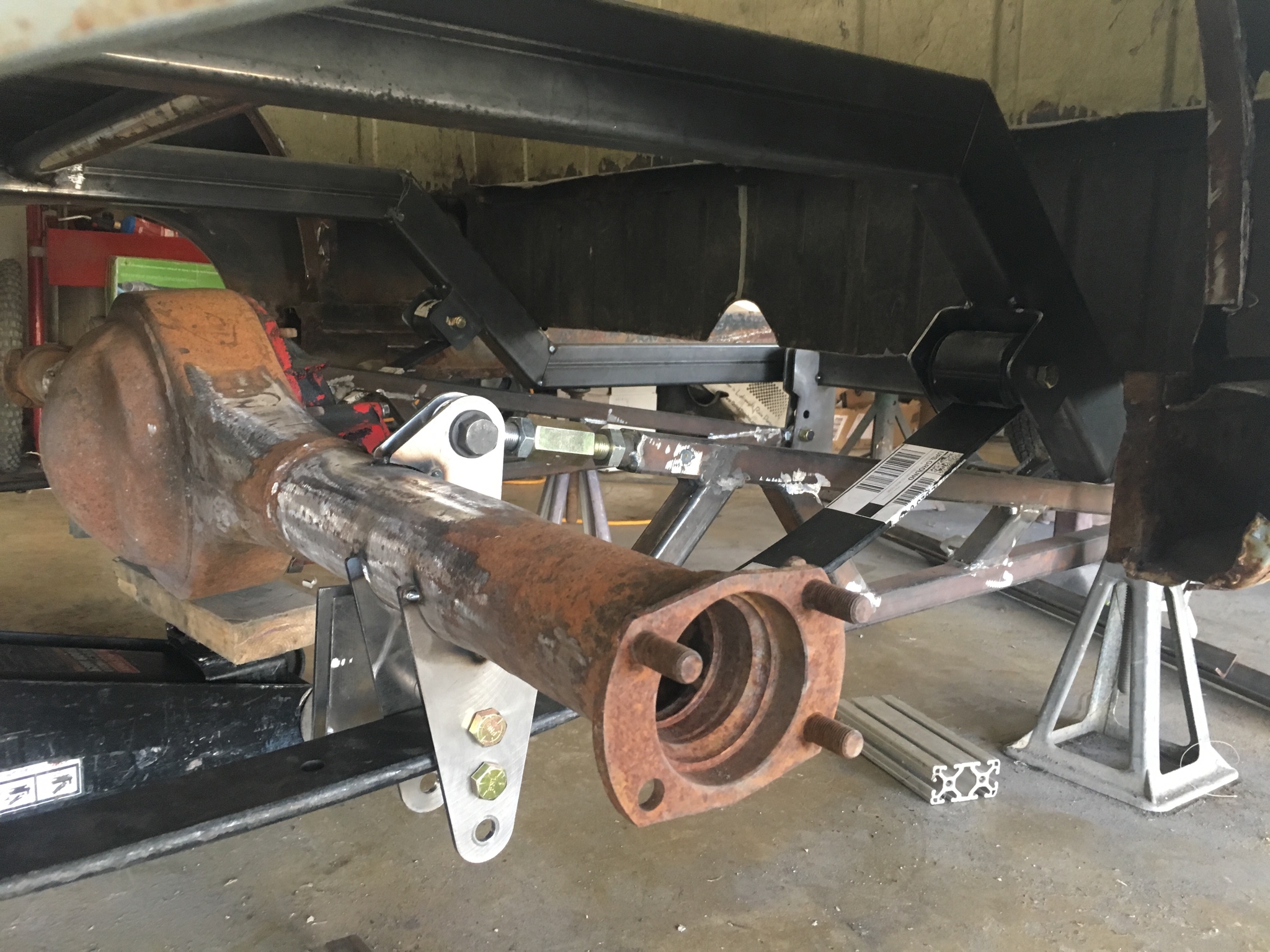

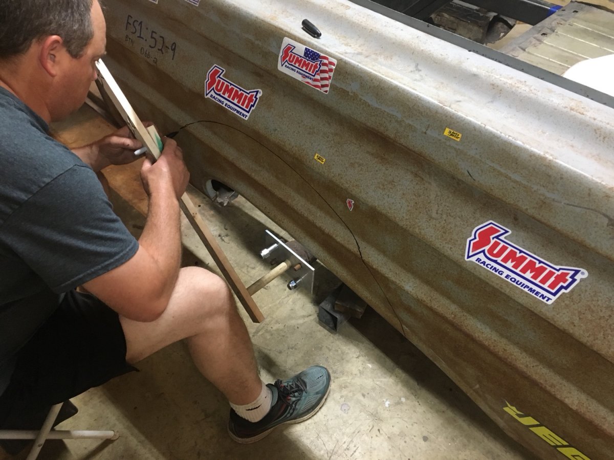

    Cage is about halfway done, at the point where I need too figure out where my seat is going too continue also been working on replacing some rough spots on the car like the rear corners and a few other spots. put in the second driveshaft loop a while back. I have been working on collecting parts slowly but surely. I have a flaming river Vega box that I got off a fellow H.A.M.B. member and have the material coming in too get my steering nearly finished.

    The jegs cage fit pretty well. The front down bars go down straight and we’re going too try too get some with a bend in them

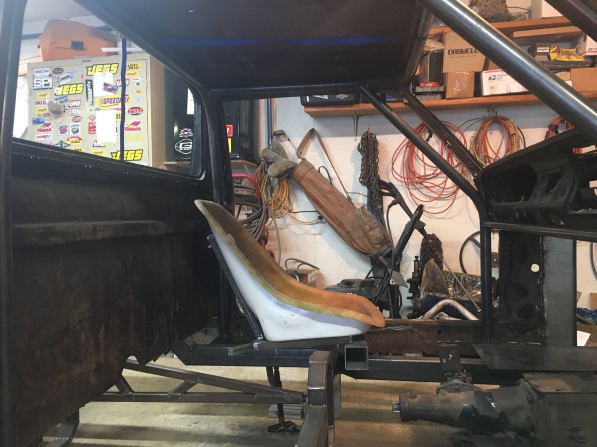

    [​IMG][​IMG][​IMG]
    Have been doing a little bit more work on the Ranchero. Cage is pretty well done, seats are mounted in place and steering is partly done once I get some material for the column it will be put in place then next is going to be pedals and narrowing the rear end. All my wheels and tires have been bought so that’s another piece to the puzzle. Everything’s been going well just had a busy summer and spent some time on another project. Sorry for the slow update.
