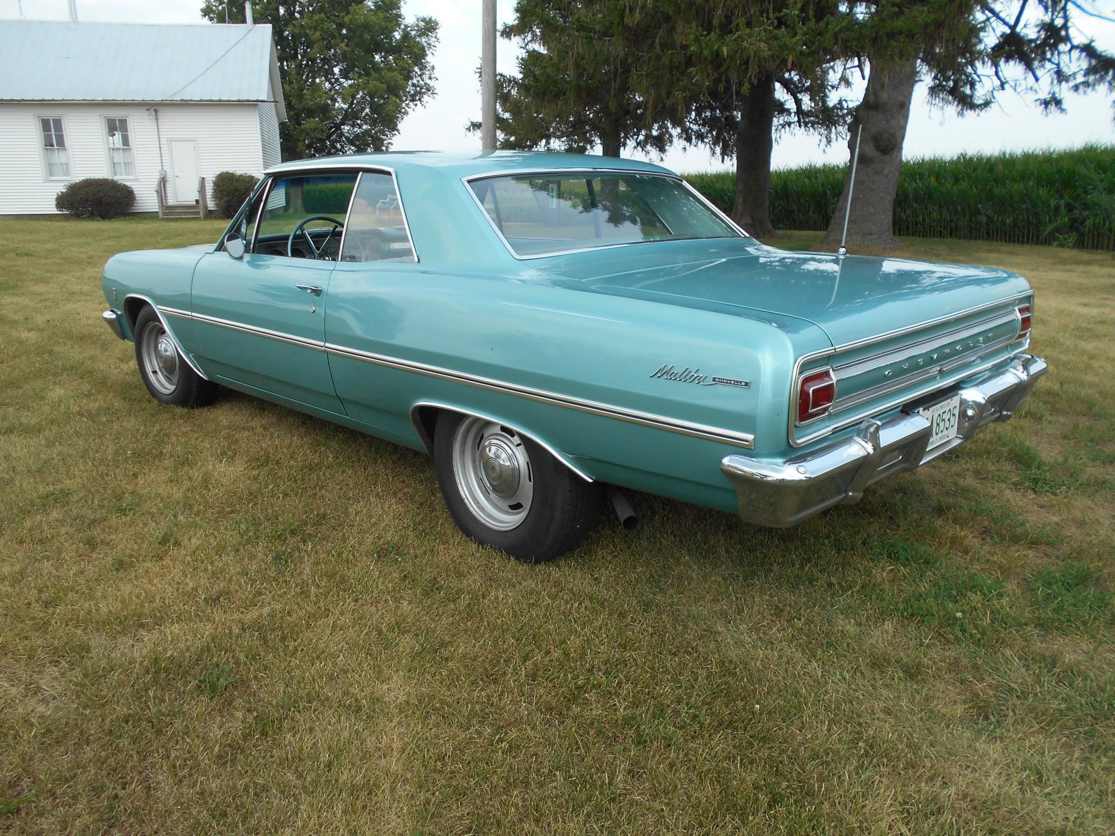

  26. ...thot I'd post a pic of my 65...
    Oilguy, Tickety Boo, Ford52PU and 5 others like this.
