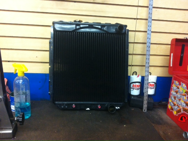

    There are a million threads with a million different answers and information on the web. It's certainly not traditional, but it's used by a lot of folks, and the information is hard to find on the web and pics almost never exist out of a car. So, hopefully someone in the future can use this.

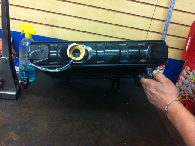

    I purchased a 1965 1966 replacement radiator for the V8 2bbl/4bbl Ford Mustang engine. Mine was purchased locally for $115. The Autozone Part number is B130, with an alternate part number of Spectra CU130. This model has both outlets on the passenger side of the radiator. It has trans cooler lines, a radiator cap and overflow tube.

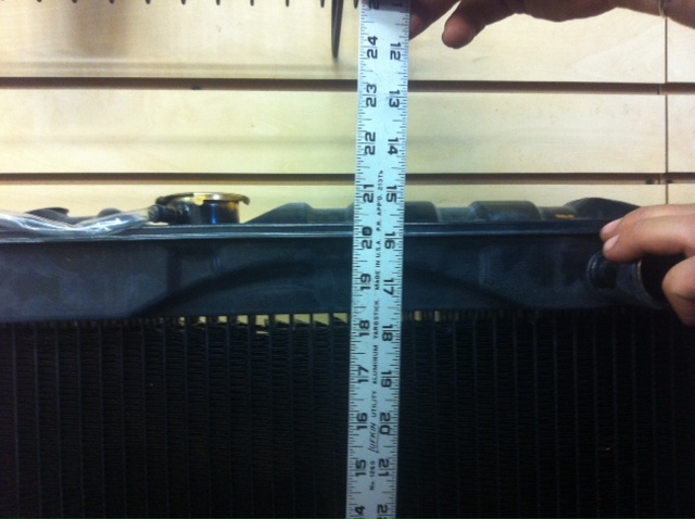

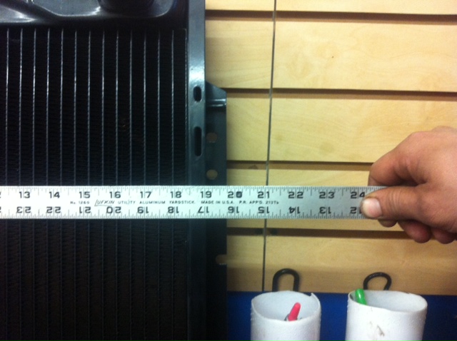

    Here are two photos of the measurements. We measured 20" in width. This includes the mounting tab location. It was just over 21" on the top side. These measurements are NOT the core size, which is often given and a smaller dimension.
    If you have part numbers or info for other Mustang models, please fell free to post.
    So,
    Autozone- Spectre Brand
    65/66 Mustang
    V8 for 2/4 barrel
    Part #B130 (alt. CU130)

    They fit a model A grill fine . 65 ,66 behind this shell

    It looks like they fit the 28/29 shell good. In my case, I have a 30/31/32 shell and needed a drop for 4" (2" channel, 2" upsweep). Hopefully I can hide some of the ugly the Mustang radiator provides.
  4. Appears to be all brass, which is nice. Does it look pretty well made? How many rows of tubes? 2 or 3? I'm gonna need one about that size soon...

    The radiator I purchased is not very square. I think I can still make it work, but it's something to look at when you are buying one. Bring a square along.

  14. I have a 66 Mustang radiator cooling a flathead in my 28 A. I got a radiator shop to add extra outlets, and it works a treat. Strange thing though, the filler neck and overflow outlet are on the right hand side of the tank, not on the left as in the picture. Maybe there are slightly different models for different applications. It's the same in all other respects.

    Actually, if I choose to run the stock generator on my car, I also need the lower outlet to be moved to the other side. The filler is gonna be a pain in the ass to get to also.

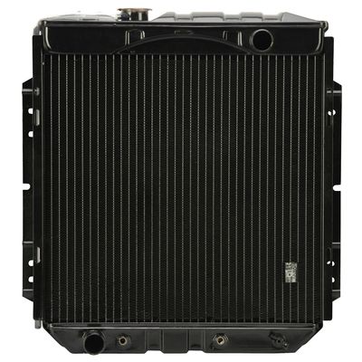

    I'm pretty sure the V6 has the lower outlet on the left side. I have a 215 Oldsmobile engine so it may work in my case. I didn't think about that.
    Spectra part #A1463 for V6 INLINE 6!!!! INLINE 6!!!! COSMOS IS THE RULER
    Depth -1.938
    Height- 16.313
    Width- 16.938
    1.25" inlet and outlet.

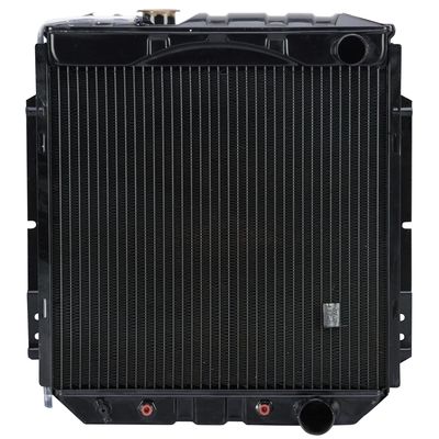

    Sprectra part #B130 for V8
    Depth -1.938
    Height- 16.313
    Width- 16.938
    1.5" Inlet, 1.75" outlet.
    The difference between the V8 and V6 is the 1.5" inlet and 1.75" outlet diameter. So the replacements for V8 and V6 are the same in dimension, but differ in outlet location and hose size.

    So you'll have to use hose bushings on the L6 radiator, that's no problem.
