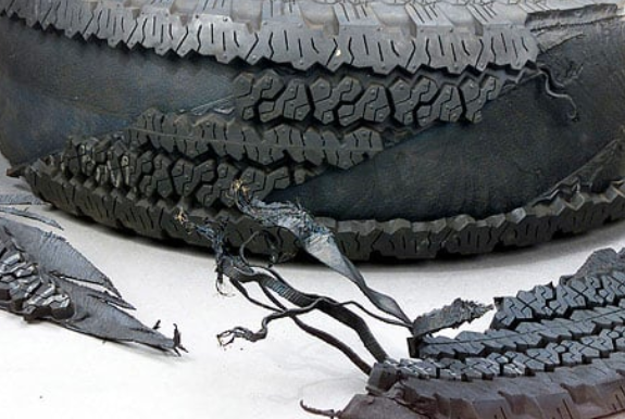

    I realize this was on a travel trailer but I had a load range E spare explode while mounted on the rear of the trailer. Zero miles, never had been on the ground. Broke the rear window and knocked of a clearance light when it went. The rear of the trailer faced west so I guess the combination of the high PSI of the spare and the SoCal sun heated things up but it couldn't be as much as the heat generated running down the freeway at 55 MPH. After that I removed the spare and kept it in the shop. And yes, the tire was made in China but I've never been able to find ST rated trailer tires not made in China.
    KrucksGarage likes this.
