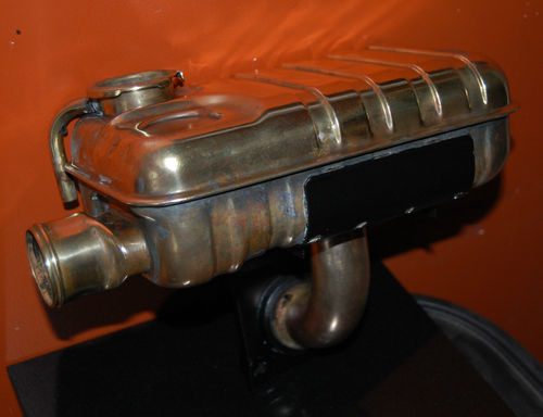

    Has he got a coolant overflow tank coming from the intake? Rectangular black thing with a second radiator cap? Remove it and back-flush it. There are baffles inside which are wonderful for catching junk and scale (like the junk and scale that SHOULD be in a 48 year old radiator but isn't) and can restrict flow..

    Ragtop, no overflow tank on this one. A fan shroud is in the works as it's going to do nothing but help, however, it has never had one before and cooled fine. Since there was never a problem before, we just don't want to overlook something that could do serious damage. Will try the radiator cap, another new guage sending unit and check the advance as well.

    It doesn't have an "overflow" tank but it does have the expension/filler tank above the radiator, nothing has been changed, all parts are original and the way they came from the factory. I blew out the above mentioned tank before reassembly but maybe it needs a more thorough cleaning?

    That would be the tank I was referring to. Make sure it doesn't have any junk settled in it.
