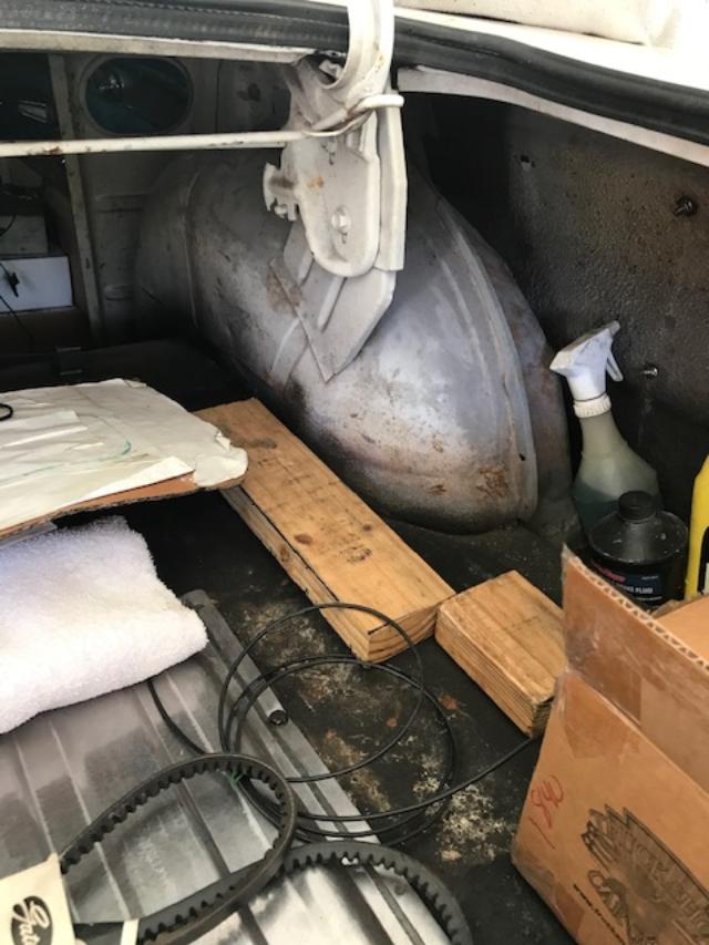

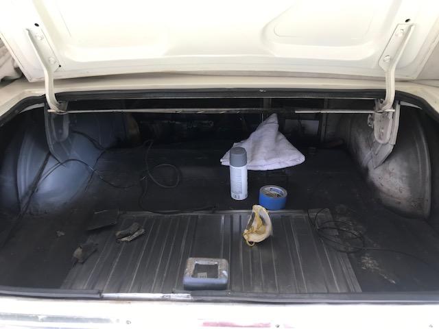

    Motor is on the stand wrapped in plastic. You don't want to know why...lol I started with painting and touching up the dash trim which led to re-doing the speedometer cluster entirely. Which has now led to pulling the entire under dash wiring harness and sanding underneath and primered. The old harness was pretty bad so out with the old and in with the new. Need to plug weld a couple of rather large holes on the firewall, then paint under the dash.
    All the the seats have been removed for new interior and carpet. I have never had them re-done so it's the original material and needs to be replaced.
    With everything removed I have been tackling sanding the entire trunk compartment. Going to prime and paint as well. In the beginning I just wanted it back on the road and I did enjoy it for about 4 years but my taste has changed and now I want a more finished looking car. Snowball effect for sure, everyone has gone through at one time or another. I have the money saved and will drop off the block before the xmas holidays and once it's built it will sit until I'm finished with everything else on the inside and then I will move to install it. Gonna go with a stall converter too but I want to really think everything out to make an effective combo/drive train/gear ratio. I want to do my best to make it work all together and get the best performance out of it.On the fence right now about converting to a 4 speed one day but I would still need to locate all the linkage and a transmission.
    Thanks for asking, not too many inquiries on my thread lately. Hope all is well with you.

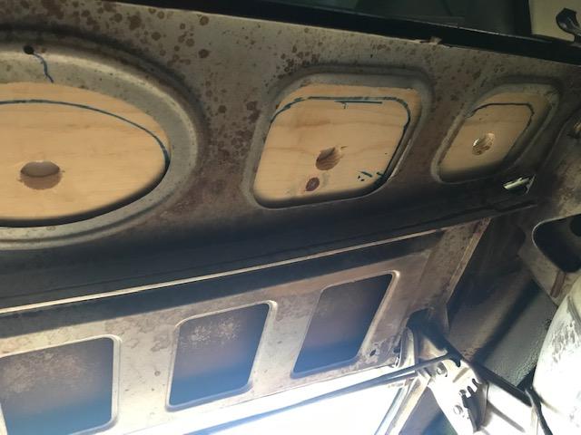

    A little of the progress in the trunk area.Under the speaker area still needs to be sanded and prepped for paint. Primered areas should be good to go as is...
