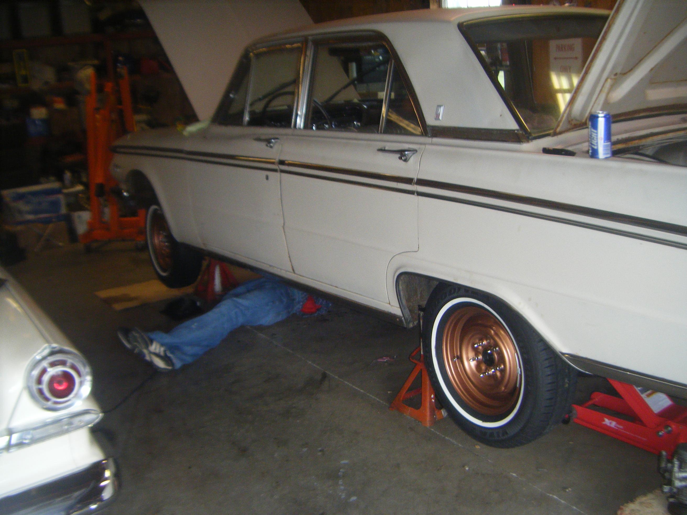

    Finally some great progress!! We just finished up the brakes today. All new wheel cylinders, flexable hoses, master cylinder, brake shoes, repacked front bearings, new rear wheel bearings and axle seals. Installed the re-surfaced drums, and bled out the air. Last week we re-assembled the rear end, and got it back into the car. Next I will be sanding and painting the wheels, mounting back up the tires, than we are going to start in on the 302. We already pressure washed it, so now we are going to fire it, than re seal and paint it so we can get it into the car.

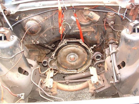

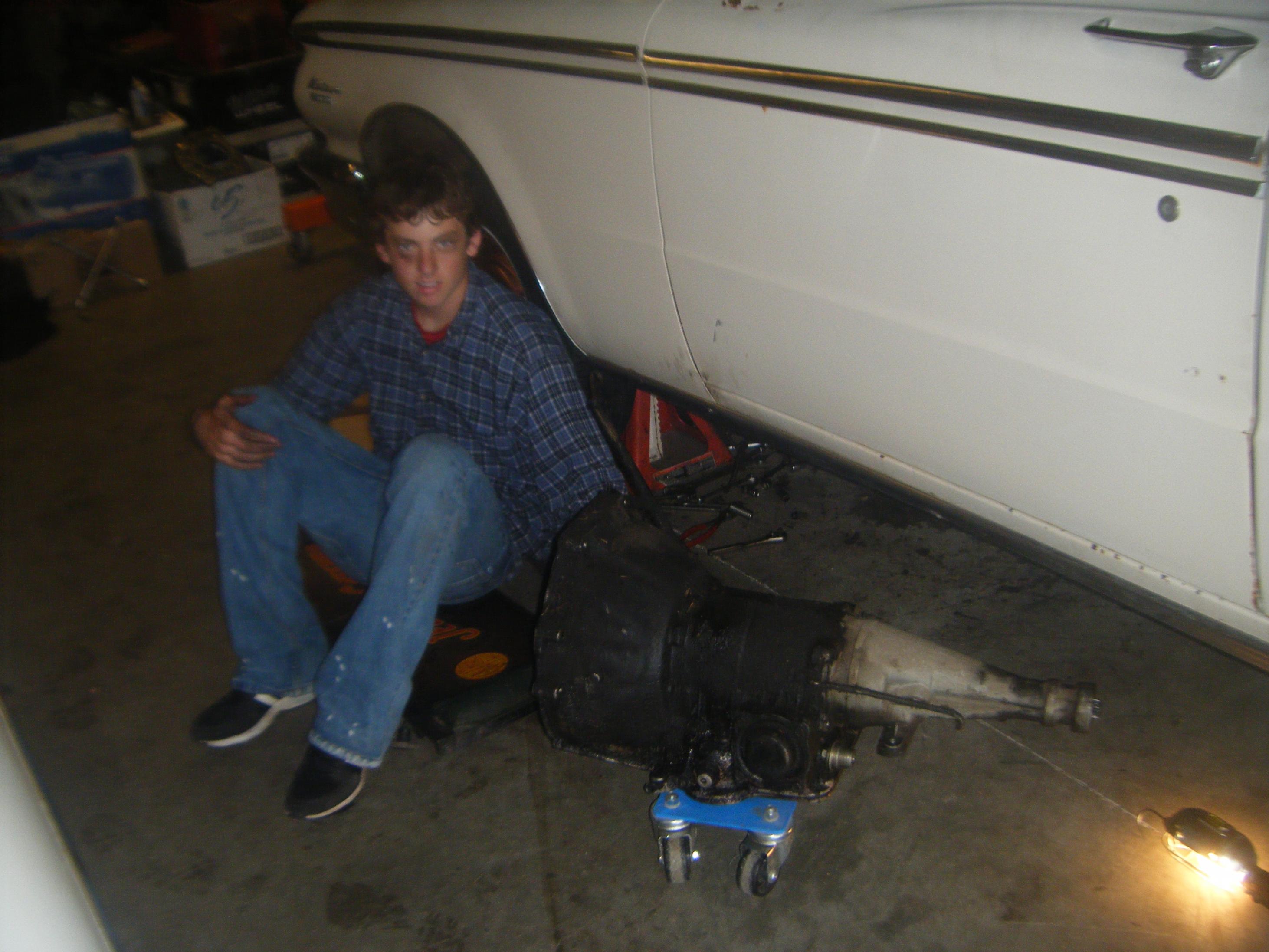

    well, as of today, the engine and trans are out, we went to roll the care out of the garage and found the rear wheels wouldn't move. So, we jacked it up, pulled the rear brake drums off, and found that the brake shoes we bought were too wide, and with the wheels bolted on, the drums were tight against the edge of the brake shoes. We ordered new ones, and will put those on in the morning. Darn it!! this week will be spent cleaning engine parts and the engine bay.

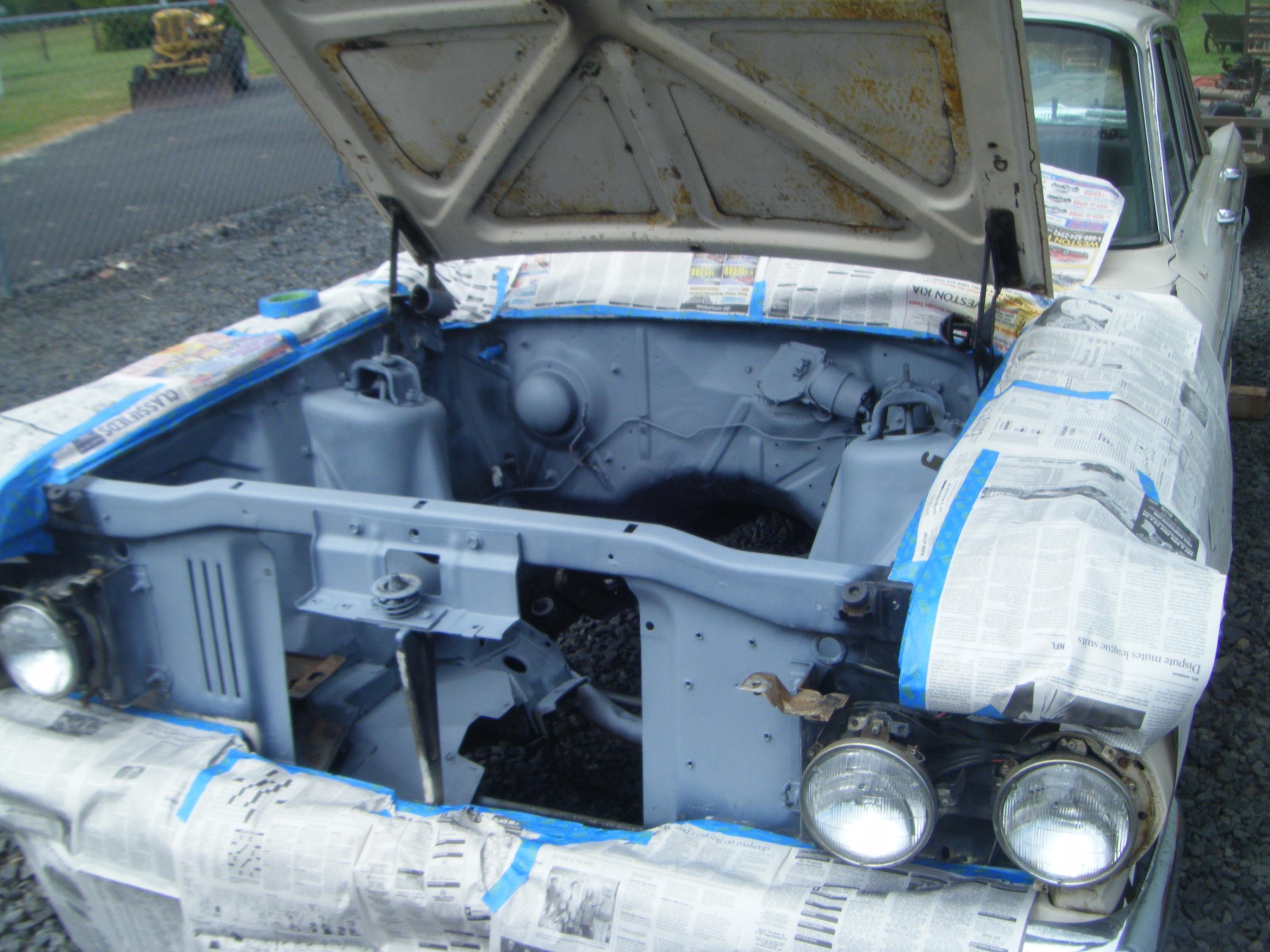

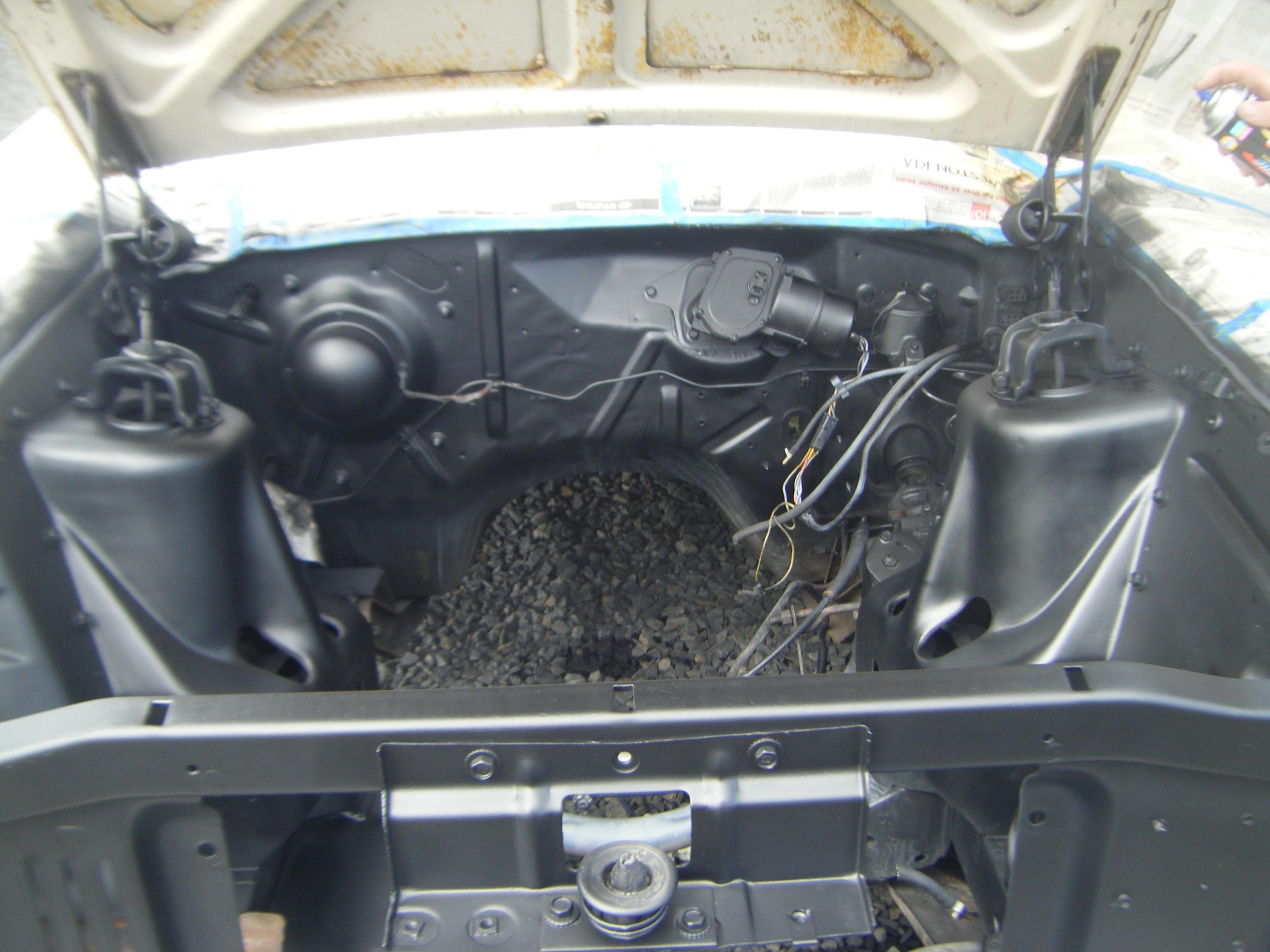

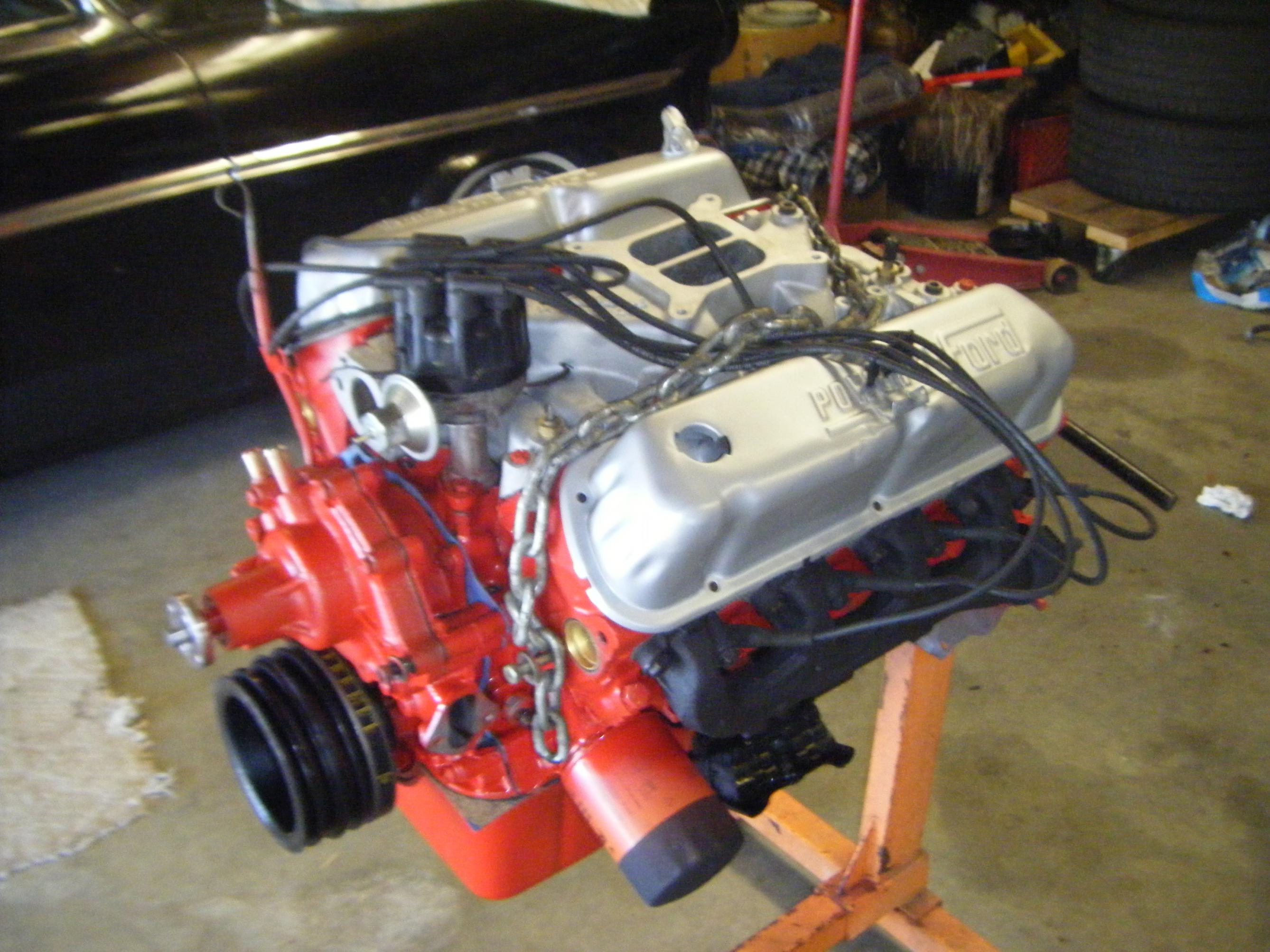

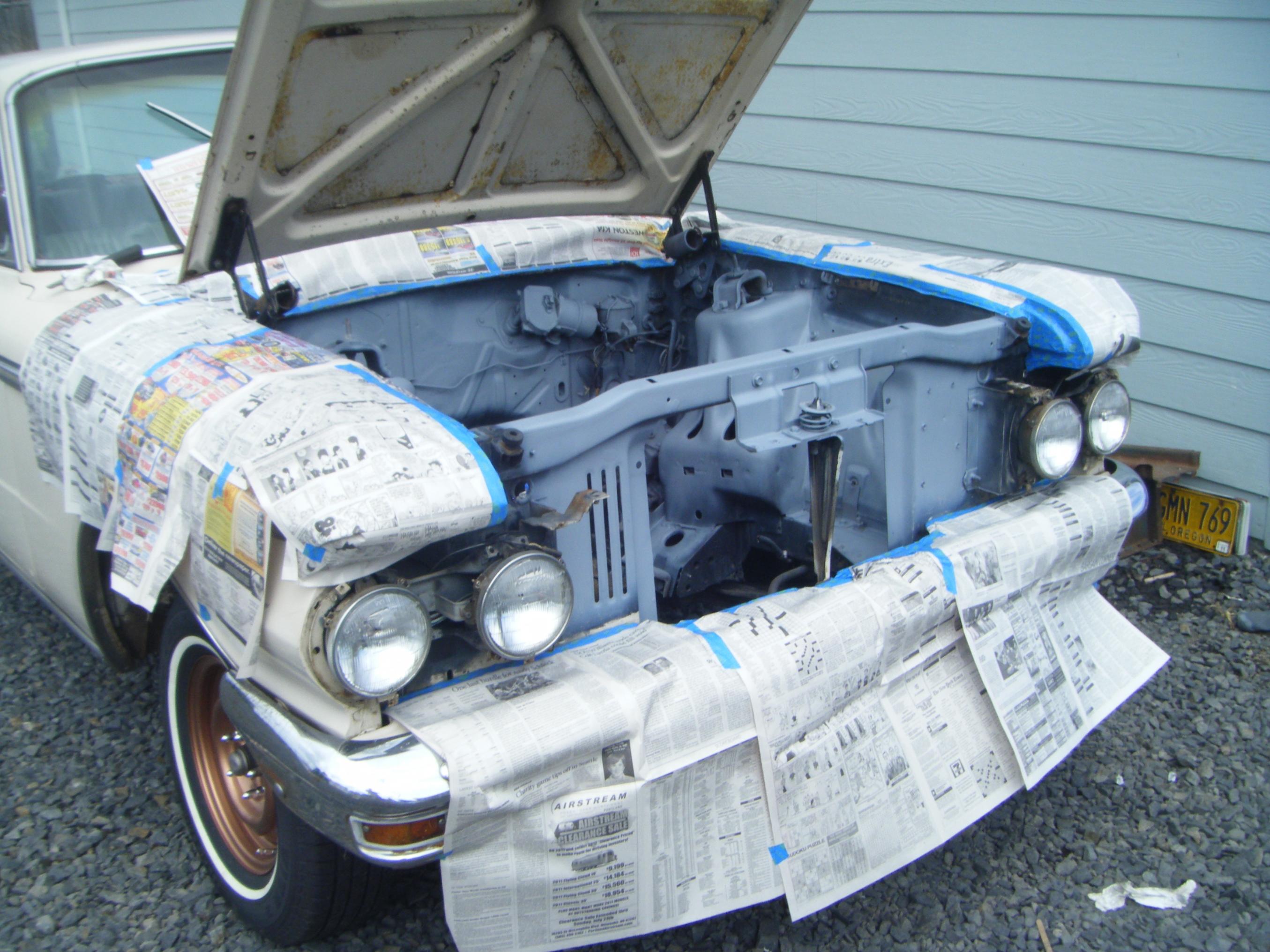

    Well, progress ihas been somewhat steady. Joe prepped and painted the engine bay, and we have been working on the motor, getting it ready to go back in. So far, we have cleaned and painted the block, flushed out the cooling passages and installed new brass soft plugs, put on a new timing set, and spent time cleaning parts. the gasket set just came in, so next is new main seals, pan and timing cover gaskets, intake swap, and valve cover gaskets. Been looking at the tranny linkage, but once it's in the car, we should be able to figure out something. Doesn't look like August, but hopefully Sept. to have it on the road.

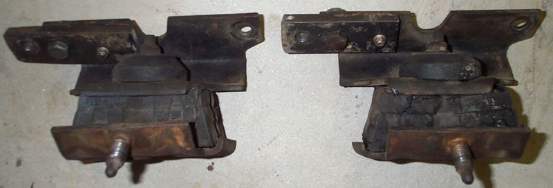

    We've got the engine pretty much ready to go back in, but we cannot find a new set of motor mounts. These seem to be different than anything else that we can find. any ideas would be appreciated.
  21. havi
    Joined: Dec 30, 2008
    Posts: 1,876
    havi
    They originally came with a 6" motor mount to the block. You can add an inch by making a new flat plate with the holes 7" apart. Or find a late '63/64 289 mount, but they are getting pretty rare. The lower half that goes to the perch is about as stout as it's gonna get with the stock piece, but Crites sells a conversion piece that should work. I see their website is down. :(
  22. 54RAT
    Joined: Dec 21, 2006
    Posts: 52
    54RAT
    Thanks havi, our original mounts bolt up to the 302 ok, but they are just old and should be changed out. They look just like the ones that you pictured.

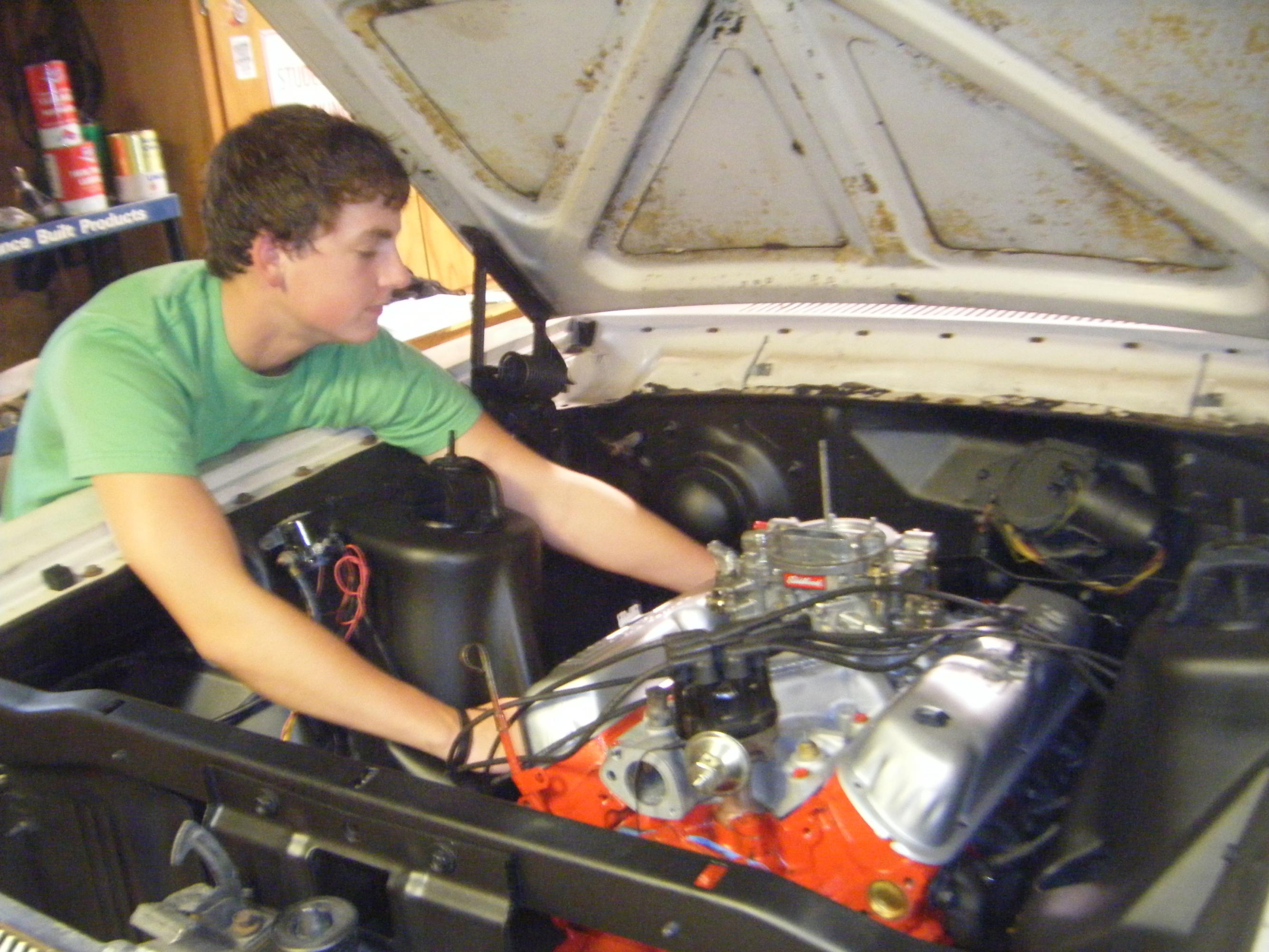

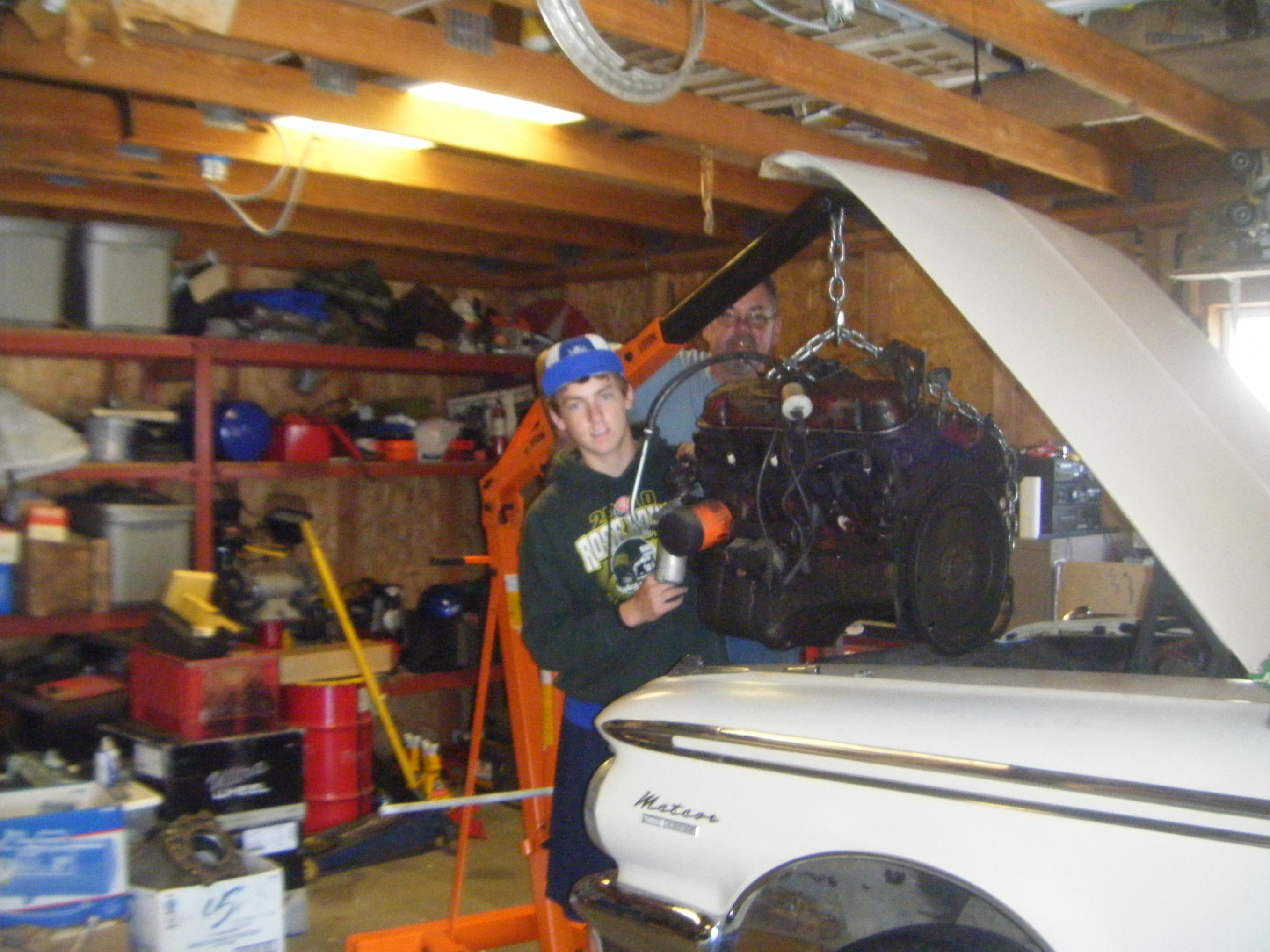

    Well, we ended up using the old motor mounts, and today we set the engine and trans in. This morning, we had just got going, and Joe got called into work, so we dropped in the engine, and when he got off work, we slipped the trans in. Now he's off with his buddys!! Should have some time tomorrow to get a bit more done. At least the Meteor back in the garage, and waiting patiently for us.

  25. The_Monster
    Joined: Sep 8, 2003
    Posts: 1,754
    The_Monster
    The motor is looking outta sight!!!

    spent all day working on the car, made some good progress

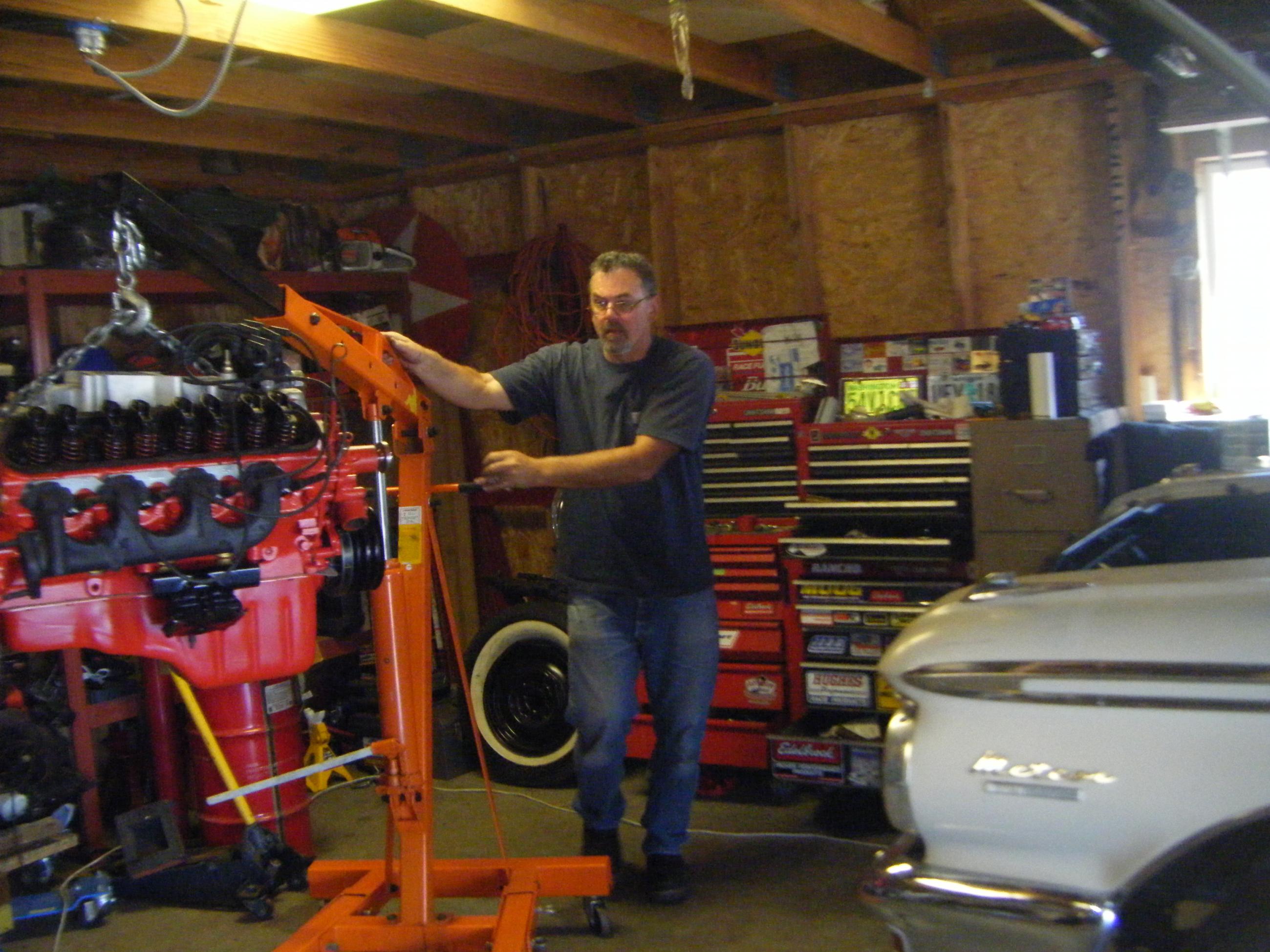

  27. The_DropOut
    Joined: Mar 4, 2008
    Posts: 391
    The_DropOut
    Man the photo w/ the copper wheels sure looks good. I love the detail under the hood. This is going to be a sweet ride, and it wont be long either. Great work and Thanks for the great photo updates.
