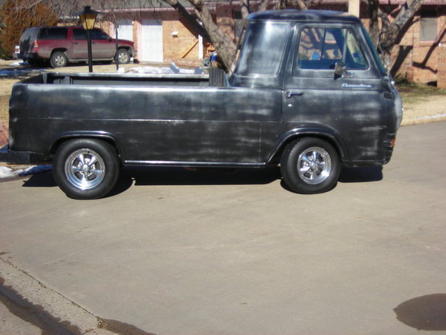

    I found a 1963 Ford Econoline P/U in excellent original condition. Stock six auotmatic. Straight body, good glass and interior runs great needs tires(checked).
    My questions are :What is one of these big back window trucks worth? And secondly, I have seen them with SBF motors. How do you swap out a motor in one of these? Looks like a fair amount of work.
    Did Ford ever offer these with a V8?
    Thanks for your time.
    Kermit

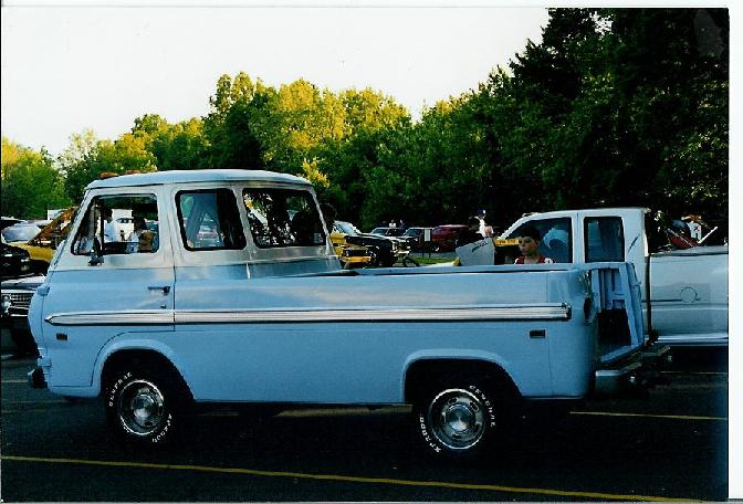

    Not sure of value, depends on condition and location. Big back window? they came in 3 and 5 windows, the 5 window being corner windows. V8 conversion is easy to do. I did a 302 in a 65 and only had to build a saddle crossmember for the trans mount. less difficult if you use exh manifolds. pretty quick with a V8 too!
    By the way, the engine goes through the passenger door. I don't think Ford ever offered one with a V8
