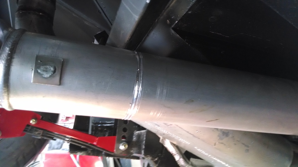

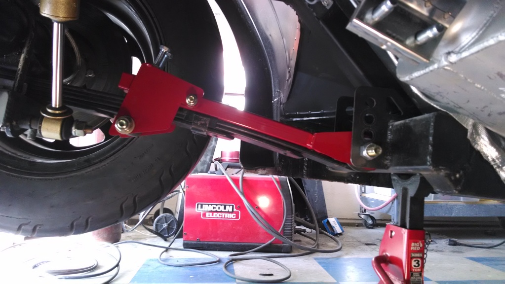

    I finished the traction bars I was working on and was able to take the car out for a drive. I have to say it turned out better than I expected. They solved the axle wrap problem and the icing on the cake is they don't rattle. As you can probably guess by the pictures they limit the flex in the front part of the spring but the ride is not that much stiffer than before. I think most of my suspension travel was happening near the front of the springs and now it appears to be more evenly spread. If need be I can adjust the pre-load on the bars.
    I put tape on the part of the drive shaft that was rubbing just to see the problem was still there. The photo below is after my drive and was a welcome sight. I also noticed while I was under the car that I had forgotten to weld one of the exhaust seams at the resonator inlet so I took care of that at the same time.
    Thanks again everyone
