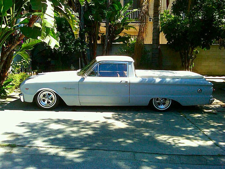

  28. RetroSpeed
    Joined: Jun 25, 2001
    Posts: 128
    RetroSpeed
    My '63 Ranchero project has two cut coils coupled with the Shelby drop and 3" blocks in the rear.
    Wheels are rare 13 inch 5 lug Cragars on Coker 5.20 13 inch tires.
