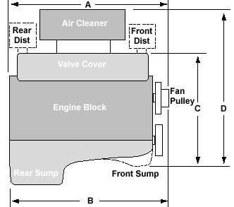

    Interesting chart I found. Oops, copied the data but not the chart spacing. Go here http://www.carnut.com/specs/engdim.html. says the 350 Buick weighs 450
    Representative for comparison purposes only

    [​IMG] [​IMG]
    A - Length from rear of intake manifold to water pump pulley
    B - Length from rear mounting surface to water pump pulley
    C - Height from bottom of sump to highest point of intake manifold
    D - Height from bottom of sump to top of carburetor
    E - Width outside of valve cover to outside of valve cover

    I have seen a goodly number of errors on charts like this and think that is the case with this one.
    Ray

    Found 3 other charts that all quoted the same 460#. Nobody states their source. A couple of guys on a jeep forum were swapping Buick 350, first guy weighed his rebuilt shortblock and all the accessories and came up with 540#, the other guy weighed his on truck scales with the exhaust manifolds and claimed 478#. I guess we'll know when somebody we know & trust weighs their's.
