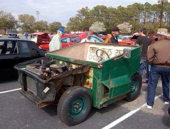

    936776_464639316978038_661772027_n.jpg This clip came from a '64- 7

  14. Daaayyyyuuuummmm! No Shame.....Thanks for burning my eyes....o_O

    But one can make anything fit with a torch and welder look above ^^^^^

  17. as stated above, my buddy has a complete 67 front clip, just wanted to know if it fit other years of Chevy II's other than 66-7....it is for sale....hope somebody doesn't hook it to a dumpster, but you gotta give that guy credit for imagination.
