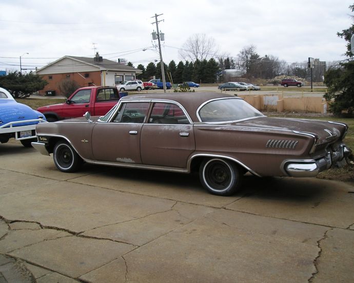

    Hi all, my son bought a 62 New Yorker with a 413. We bought it not running. We have a new battery, and are maintaining the charge with a battery charger. We have changed the oil & oil filter.
    The motor cranks over with the key just fine.
    We pulled the plugs, they looked OK, just old. He have since replace them with new, proper, Autolight plugs. We put about 3 shots of oil in 5 of the 8 cylinders (couldn't get the oil can contorted enough to get oil into the other 3.) then spun the motor with out the plugs in it. I have a hand held compression gauge, the 5 cylinders I could get the checker in, tested a 80lbs on the 4th bump. The other 3 have enough compression to blow your thumb off the hole cranking through every time, and we can feel it suck our finger into the hole just before the compression blows it off.
    The car still has a single point ignition on it. The points are fairly new, high quality, points & condenser (not cheap china crap), and are properly set. I get a spark out of the coil every time I manually open the points, and also get spark out of the coil as the motor cranks over. The disturber is stuck in the block and has not moved for many years. With the cap and rotor on, I get spark at the plugs. I ground the metal body of the plug with a jumper wire to the motor block and insert one of the plug wires off the motor on the plug and crank the motor and visually see a spark jump the gap. Did this with 3 of 3 different plug wires, have no reason to believe the other wires won't have the same outcome.
    I have brought several cylinders up on compression (blowing my finger off the hole), and the rotor has pointed to the correct wire terminal on the dist cap every time.
    I have spark reaching the correct plug at the same time that cylinder has compression. With compression, feeling a finger being sucked into a cylinder just before compression and the rotor pointing towards the correct terminal on the cap, I can't believe there is an issue with the timing chain.
    We can put fresh gas through the carb, and we are not even getting a pop.
    I pulled the top off the carb (an AFB) and it was full of old smelling fuel and had some dirt on the bottom of the float bowls. I pulled the carb off, dissembled the carb, blew out all the passages ( the gaskets were not very old) and reassembled the carb with a new base gasket. We pulled the tank, had it boiled out, replaced all the rubber gas lines and installed a new filter. We have added 4 gal of fresh gas to the tank, poured a little fresh gas into the carb, still nothing. Pulled the carb again and pulled the top off (it was full of fuel again) and dumped that fuel on the ground and lit if off with a lighter. It burned well. Reinstalled the carb, added more gas, still nothing.
    I advanced the plug wires around the cap one position and dumped gas down the carb, it would kick back against the starter at every cylinder, like one would expect from advanced timing. Properly located the plug wires, still no run, nothing but cranking.
    Then I retarded the wires around the cap one position, and tried again, this time I got a few pops through the carb. Locating the plug wires to the proper location gave me nothing. Dumping a lot of gas down the carb resulted in wet spark plugs that would still show a spark across the gap when pulled out of the motor and grounded.
    After it sat for an hour, we shot some starting fluid through the carb (we had to go to the store to buy some), but still nothing. Added some more gas, just to be sure, after the starting fluid didn't work, still nothing.
    What am I missing? This thing should run, even poorly at this point would thrill me! I'm pulling what little hair I have left out.
    The car has a fairly new looking oem muffler and a fairly new still mostly shinny, tail pipe (it is a small diameter single exhaust). Could a plugged exhaust be causing this no run condition?
    Help! Gene

  2. spanners
    Joined: Feb 24, 2009
    Posts: 963
    spanners
    WHEN YOU PUT FUEL DOWN THE CARB ARE YOU HOLDING THE BUTTERFLY OPEN AND GIVING IT A DECENT SLURP? Sorry, I wasn't yelling at you, I accidentally hit the capitals lock.
    To me 80lbs seems a tad low but the thing should still fire unless the dizzy is 180 degrees out. If it's got hydraulic lifters they may have bled off so the valve timing will be all over the place till they pump up.
