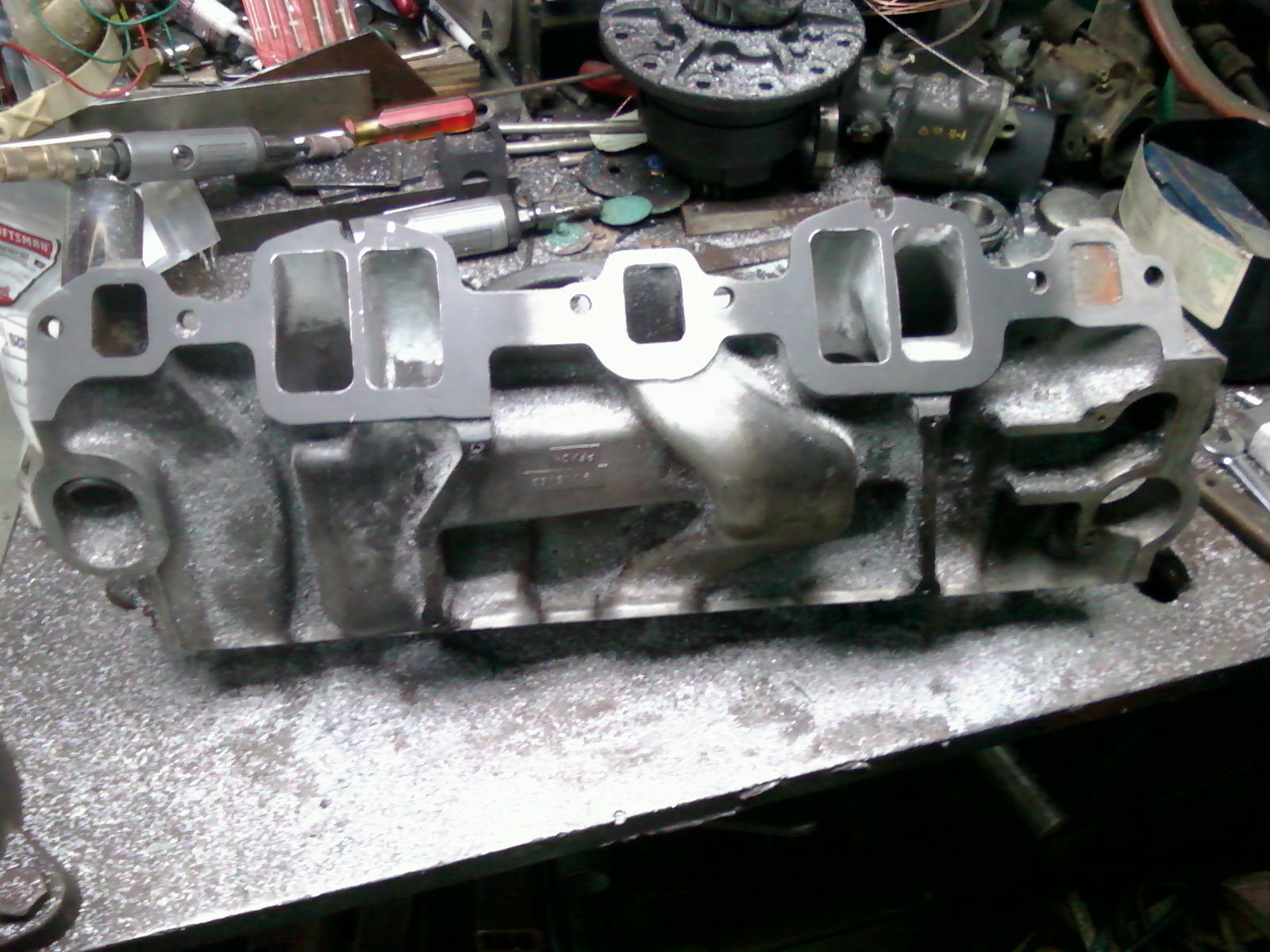

    Got started making a big mess port matching the intake.

    News flash after I had a chance to check my work twice after the crew had left I found that the oversize exhaust valve it just contacting the block in the combustion camber. Not to despair we have a truck block we could build with a know cam that we have on the shelf.
    Or I may try some offset dowel pins but then the intake valve may hit.
    More to come.
    chryslerfan55 and TFoch like this.
