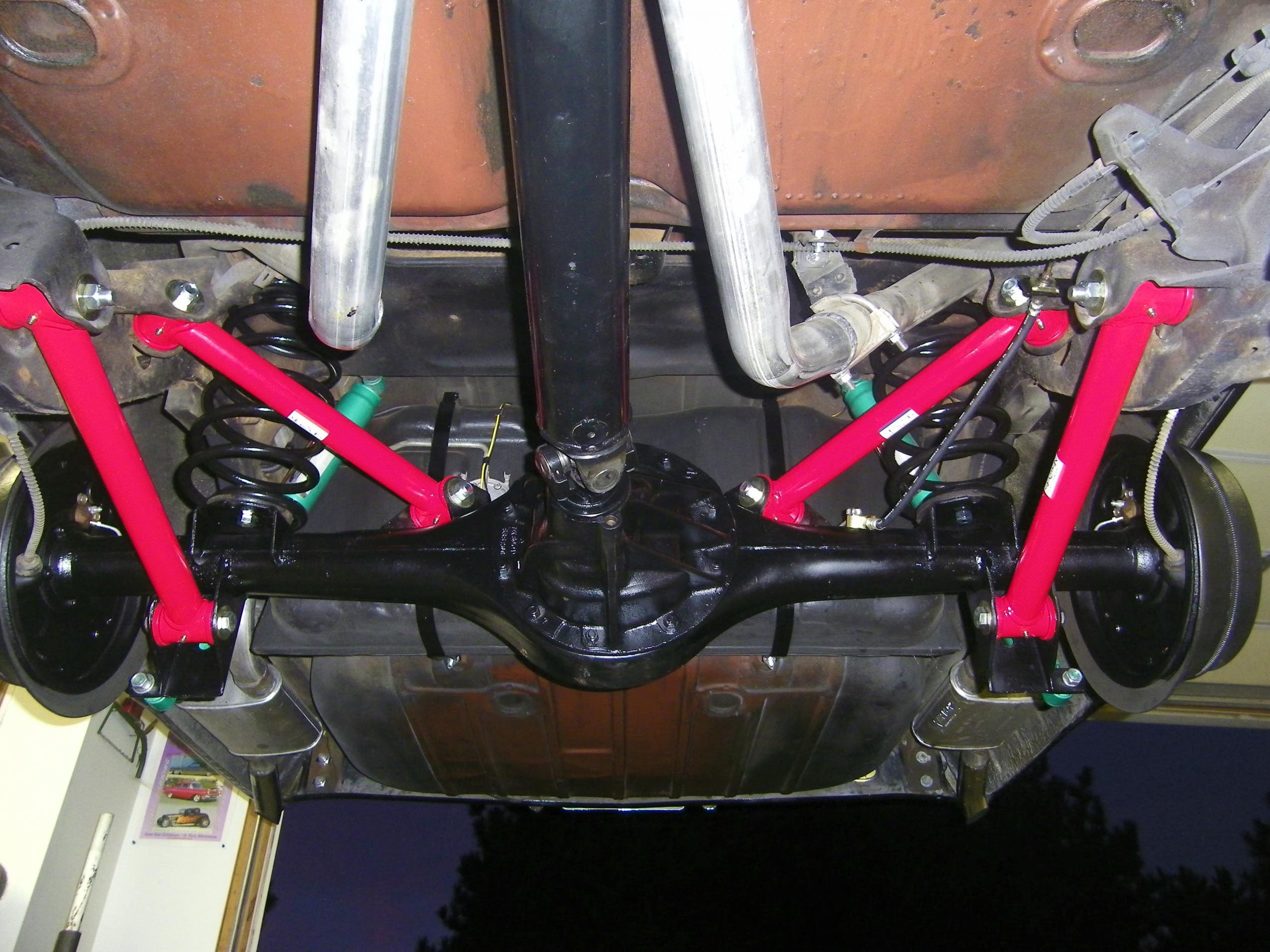

    I have finally fixed my 61 Olds rear control arms after searching for 2 years for replacement bushings. I found a place to make new control arms, at a reasonable price too. Spohn Performance makes just about anything related to suspensions. The car never rode better. Here is a picture.

    I've got one I'm building for a customer...any idea what bushings he used? Originals are not available, as I'm sure you know!

    Go to his web sight, all the info is there and I know he made up a couple more sets.

    Spohn has a Del-Sphere that is similar to a Johnny Joint as well.
