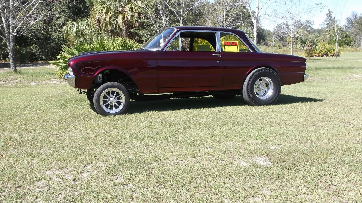

    You can do them like my old street gasser Falcon. I can give you some specs on a 435 inch 429 that will give them A/Gas boys fits. 2013-10-10 11.55.36 (1).jpg 2013-10-10 11.57.11.jpg

    Is that a 30" tire? What did you have to do to the wheel wells?

    Yes, they are 30 inch tires. I actually traded for that car and I didn't do the fenderwells, but they were radiused and flared which is easy to do .
    You can weld in some small conduit and then glass them over and body work them to what you like.
    You can go all fiberglass and mat and shape them . I have even used thin flat bar and roll it to the shape you want and weld it to the wheel opening and then do the body work. The important thing to remember is metal won't crack body filler will.
    You might even find some front fenders and cut the flares off and weld them on the rear.
    MUNCIE, Thor1, Deuces and 5 others like this.

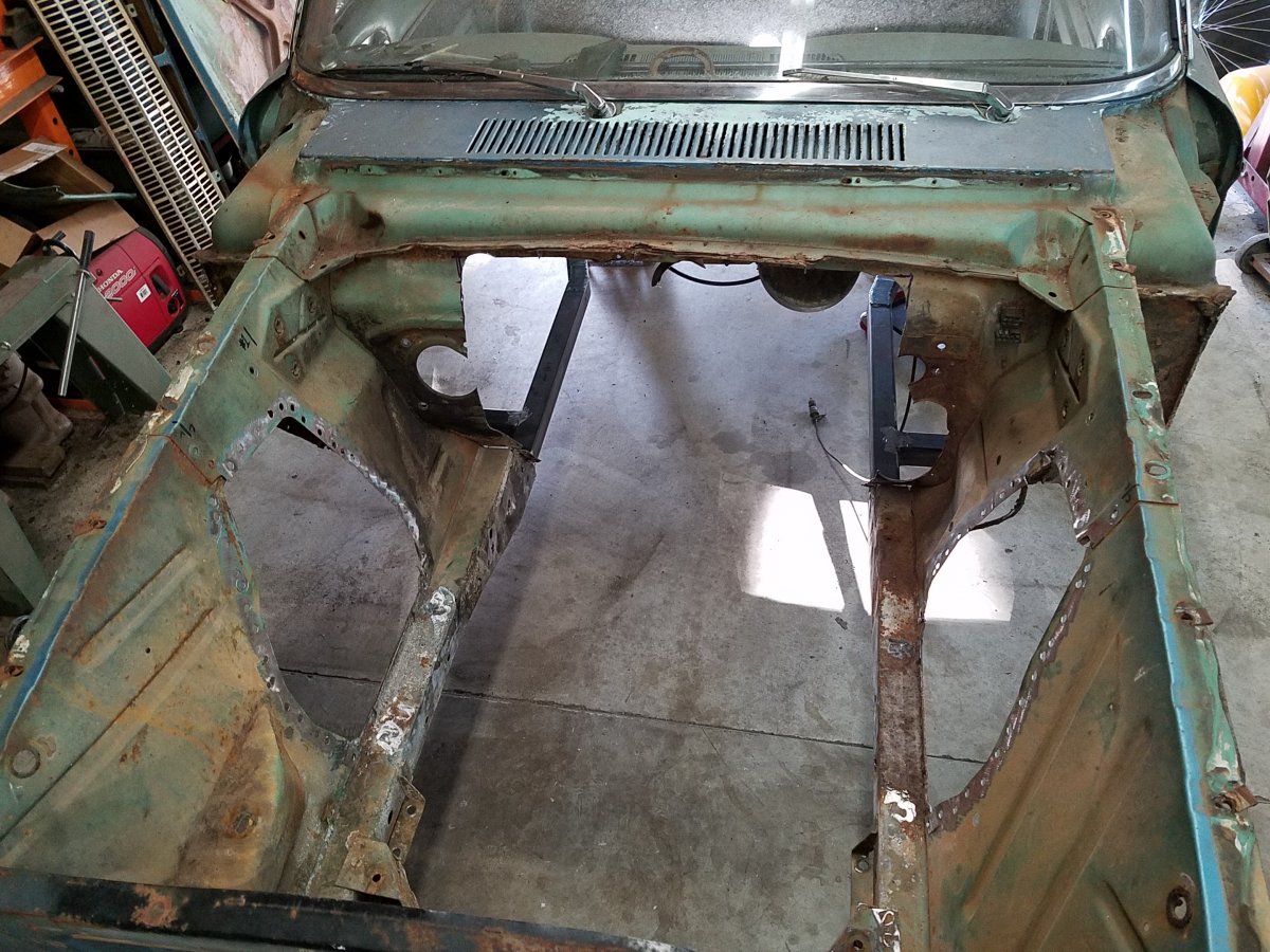

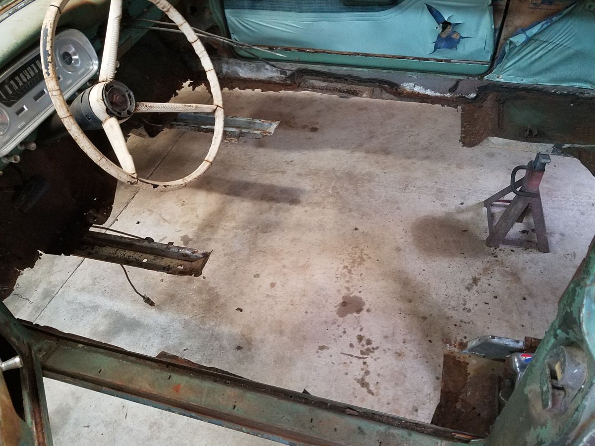

    I take it this car came from Massachusetts. This would explain the rotted floor and trunk pans.
    I had to cut them completely out.

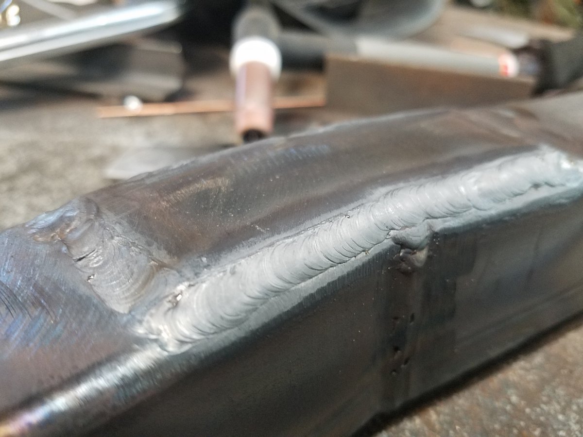

    2 X 2 X 11 gauge tubing was used to make subframe connectors. I bent them to nest in the front subframe and rear torque boxes.
    Doublers added at the bends.
    The stock sheet metal is pretty thin so it requires a good bit of weld area to spread the load. I drilled 1" holes in the front subframe and torque boxes for plug welding.

    Mr. Engine Bay, meet Mr. Sawzall.
    The massive 460 will require a good bit of setback to get decent weight distribution, so the firewall had to go with the shock towers.

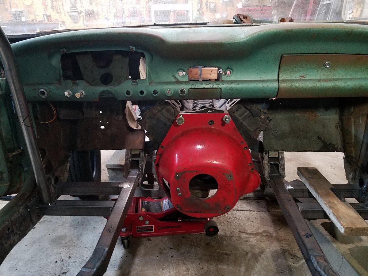

    With a 109.5" wheelbase and a 10% engine setback limit, I could go as far as 10.9" from centerline front axle to #1 spark plug. I picked a "moderate" 7" setback.
    Preliminary motor mounts were fabbed from 2 X 4 X 3/16 wall to locate the engine. My phone automatically assigned the number "454" to this photo. Nice try, Samsung, but that ain't gonna happen.
    The 460 came from a running '73 Lincoln I bought and stripped nearly 20 years ago. The engine has been sitting in the corner of the shop waiting for a home all that time.
    The heads are '72 429 Police Interceptor, P/N D2OE-AB. They come with 2.19" intake and 1.76" exhaust valves, screw-in studs and guide plates from the factory.
    It was a bit difficult to swing the engine under the cowl. I'll cut the cowl back for both fore/aft and induction clearance. After ruminating over the location for a while, I think I'll bring the engine forward 1" and drop it 1.5". That will put the crank centerline at 18.5" high.

    The whole idea for this build is to do it the old school way: add Ford's largest engine to one of it's lightest cars and use as many swap meet used parts as possible. Cheap speed, at least initially.
    About the only new blow-proof bell you can find these days is a Quick Time and it's about $800. I lucked up and found an obsolete Lakewood bell for $300 on Facebook Marketplace. It's obviously out of date but it will do for now.
    The seller supposedly bought a stash of Gapp and Roush parts from their 70s pro stock program. He had a pile of flywheels, clutches and even a big input/output Liberty prepped Toploader. I should have raided the savings account.
