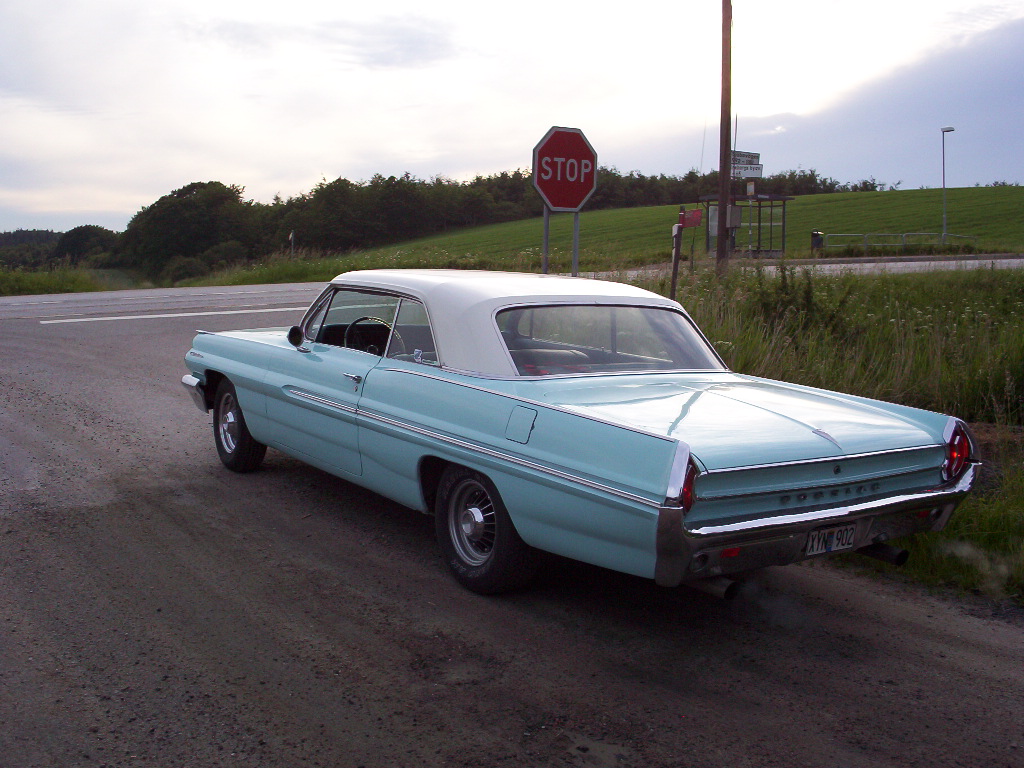

    here is 6x15 in front and 7x 15 in rear bop 8-lug wheels on my 1962 catalina

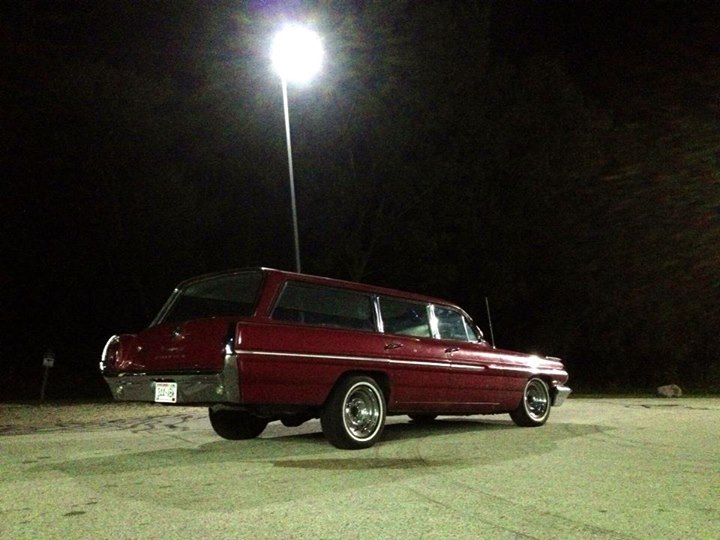

    My 62 Catalina Safari...right now snoozing in storage, awaiting some underhood work. Clean no rust, red on red, orig. paint/int/drivetrain car...rear bags, 3" front springs. Couple crappy pics...haha...

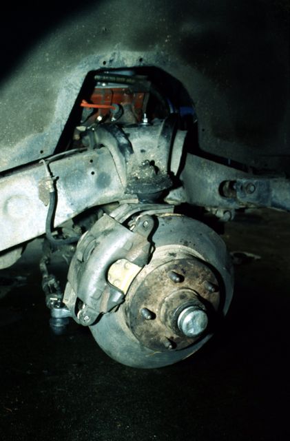

  25. Jeff, I put 67/68 disc spindles on my 64 way back when before there were Scarebird kits, etc. The lower ball joint on the 64 is 4 bolt and did not give enough clearance with this spindles for turning. I cut the 3 bolt ball joint area off the 67 a arm and welded it to the 64 arm. I also used the 67 outer tie rod ends. I have a pic some where I can find and post up. Other than that little side track, the rest bolted right up and worked great.

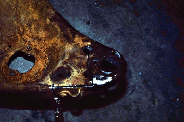

  29. Ok Jeff, here is what I did in the end. The spindles and disc parts came from a '69 full size Pontiac now that I look back at my pics….not a 67-68 like I thought. When I first installed the discs, I discovered the '69 spindles wouldn't clear the lower 4 bolt ball joint like I mentioned earlier. So, at that time, modified the '64 spindle to accept the caliper bracket. I had to have the rear mounting ear for the steering arm machined down to half it's thickness. While it worked, I never felt good about that set up and worried about the strength. So, a few years later, I decided to modify the a arms to use the '69's 3 bolt lower ball joint so I could use the '69 spindles.
    Here are a few pics I took of the a arm modifications. One shows the '64 and the '69 lower arm next to each other to show the differences. Also, a few close ups of the cuts. I cut down the side a bit to be able to incorporate the spindle stop off the '69 arm. I was careful in my measurements to make sure that the center of the ball joint remained in the same place, so any difference in geometry would only be a result of difference in the spindles. It's been over 20 years since I did this, so I can't recall with certainty, but I am thinking the '69 spindle may have a smidge shorter bottom end which would tuck in the bottom of the tire a bit. Seems I wanted to get the tire to stand back up and compensate for the top of the tire tipping in from the lowering. Or, the spindles may have had the same measurements and I'm just blowing smoke….I'll never be able to tell you for sure. LOL
  30. You could be right. Seems to me the upper joints were the three bolt on the later car, but I did not need to change anything on the uppers to make it all work on mine. I don't know what the improvement is going from the square flange to the triangular one on the ball joints is either.....but I do remember the three bolt ones cost a lot less. ;)
