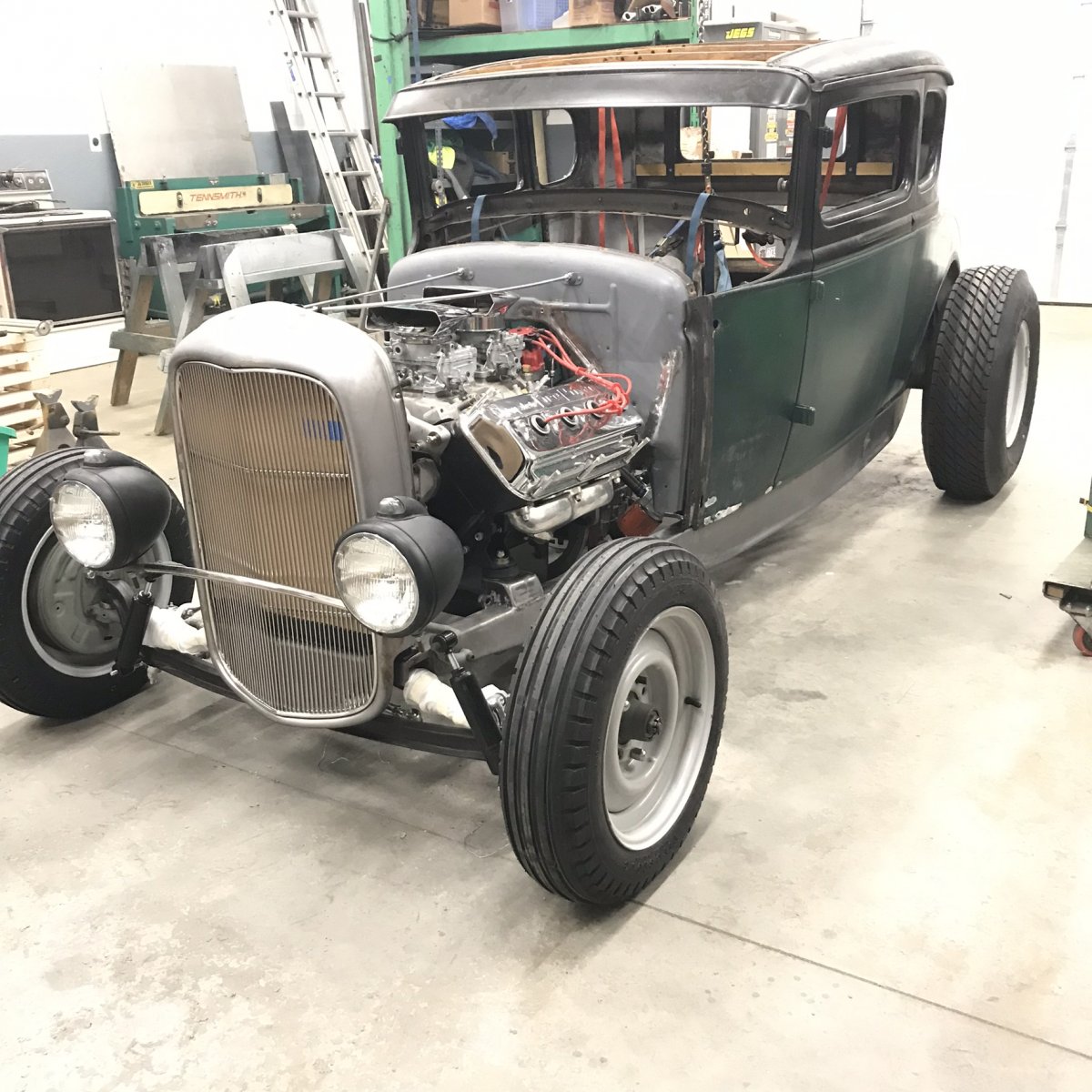

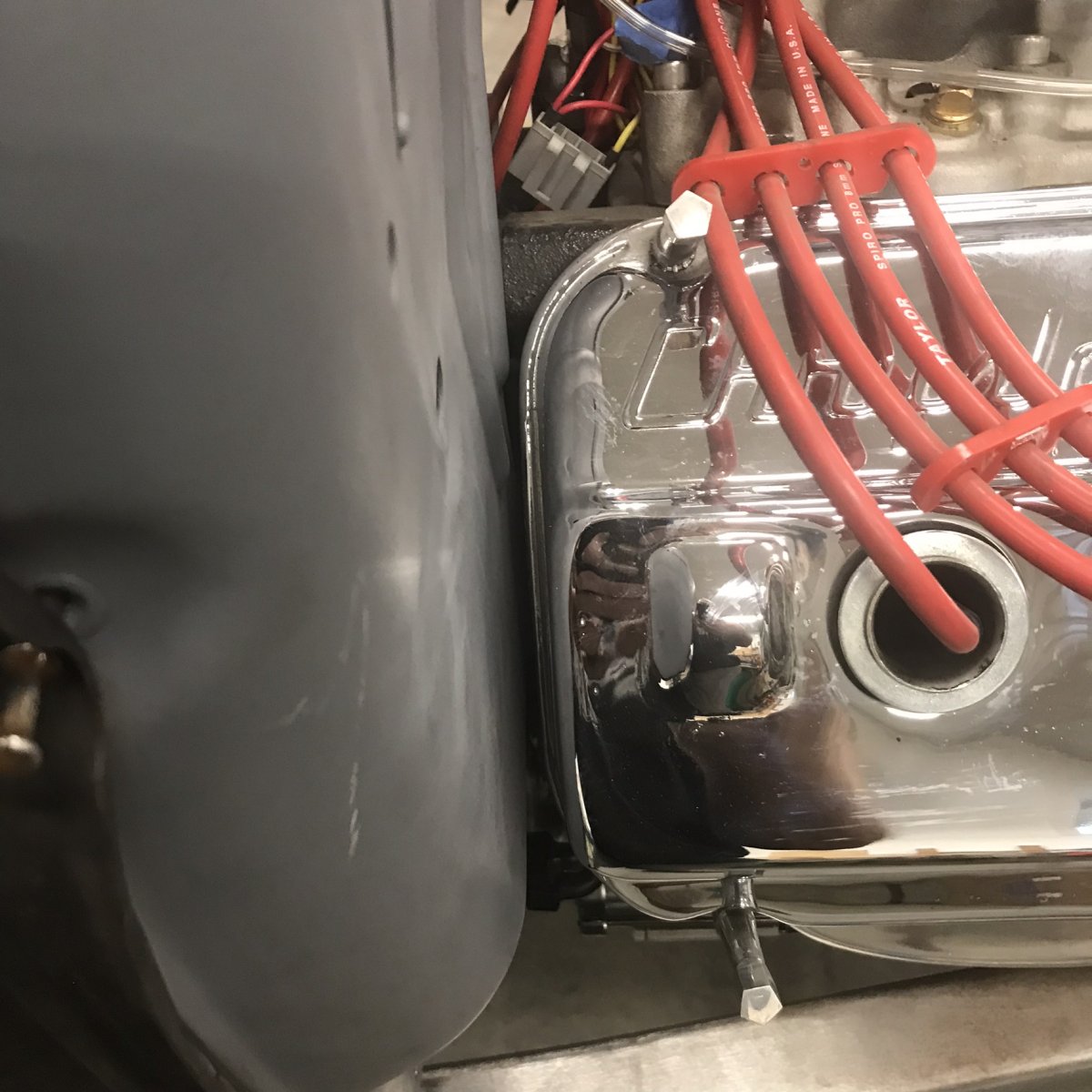

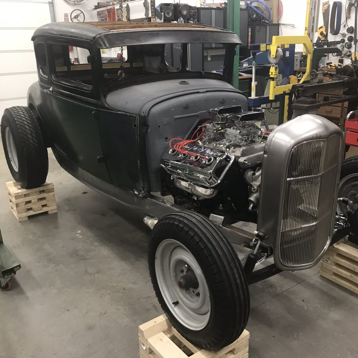

    Making room for the Hemi. I'm planning to tub the center section, but I had to move the beads over to make room for the distributor.. I'm trying to keep the stock look as much as possible.

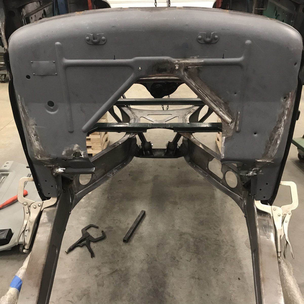

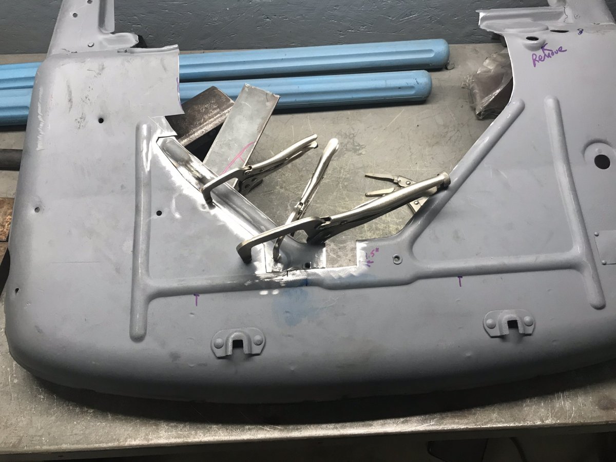

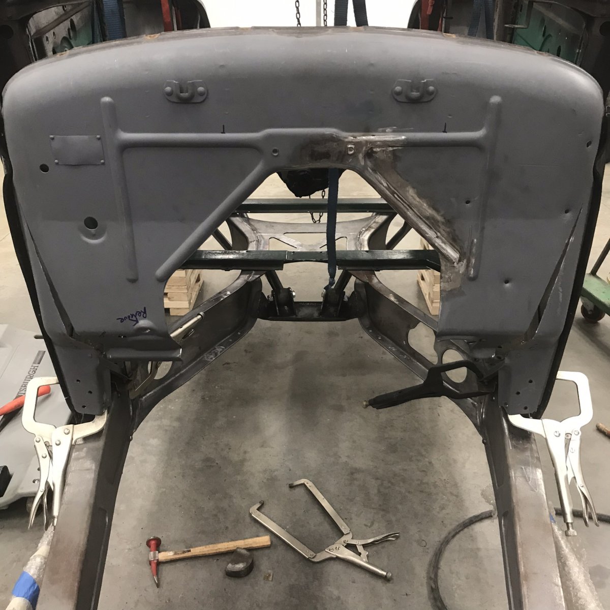

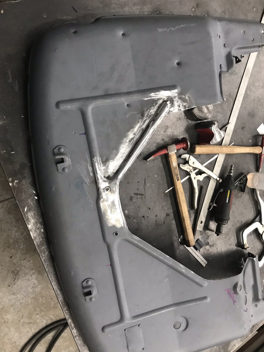

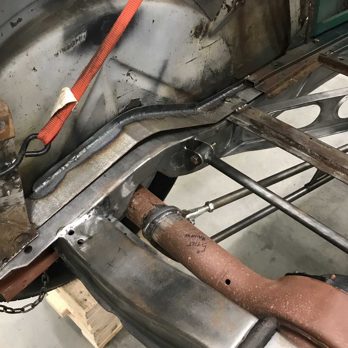

    Pie cut the firewall since the frame is not pinched.

    Thanks all. Regarding the rear subrails, I don't have a photo of them, but I reformed some new ones. The front (behind the firewall) I pie cut to spread the firewall.

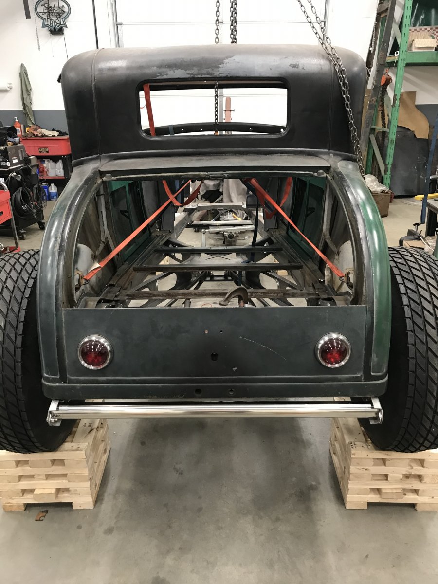

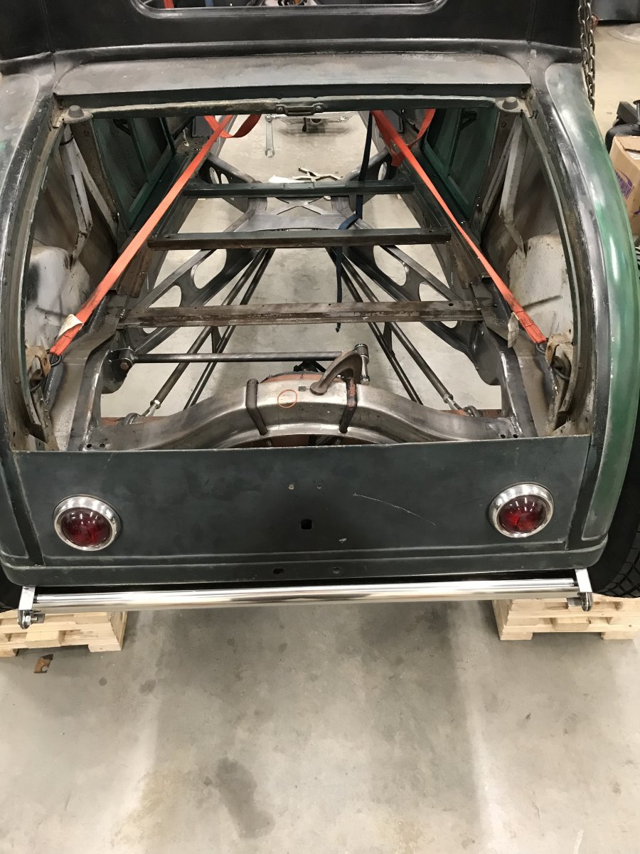

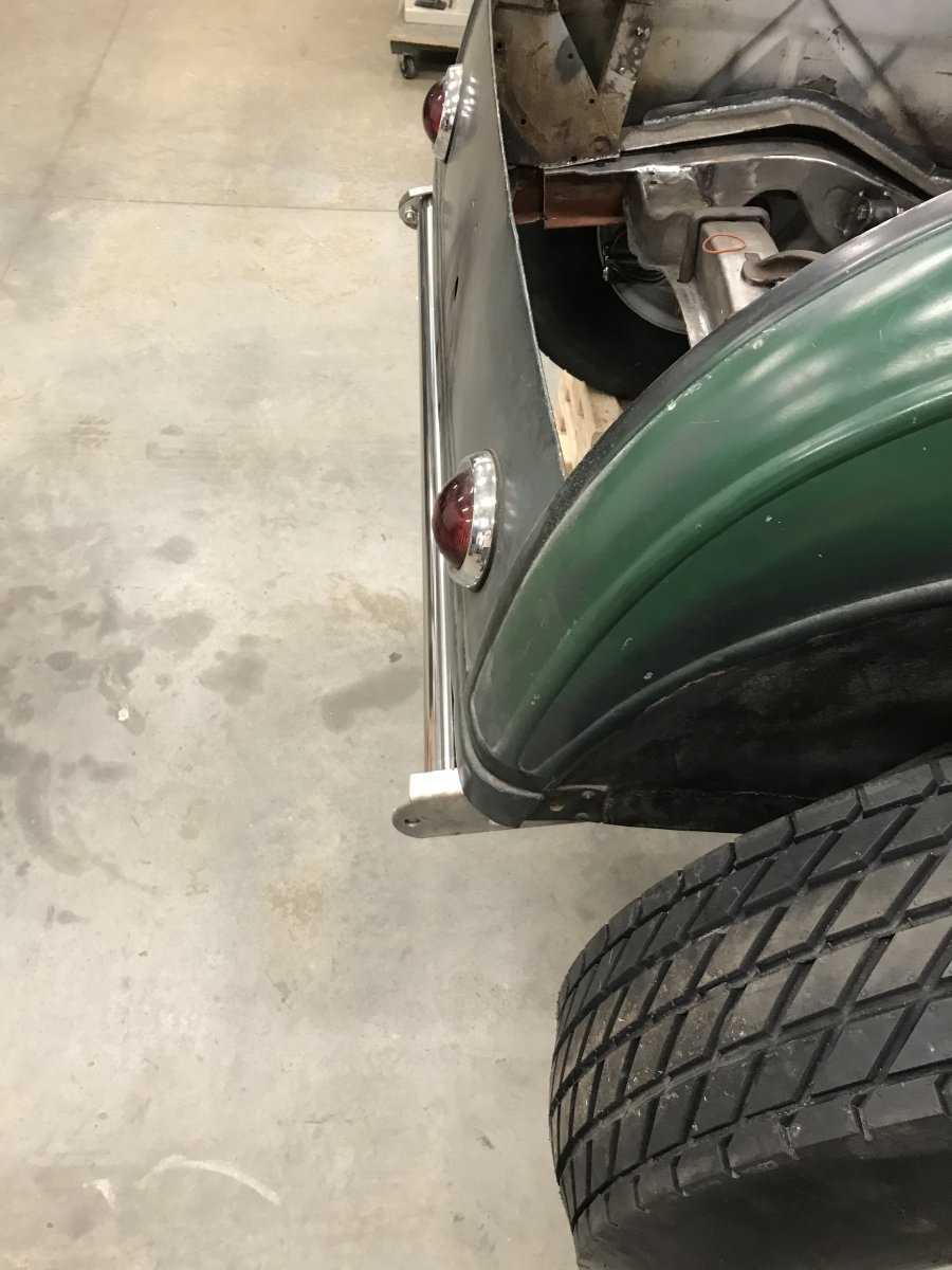

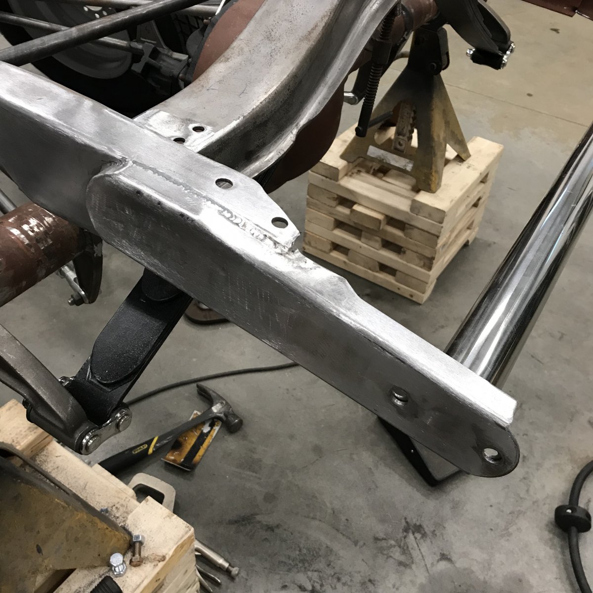

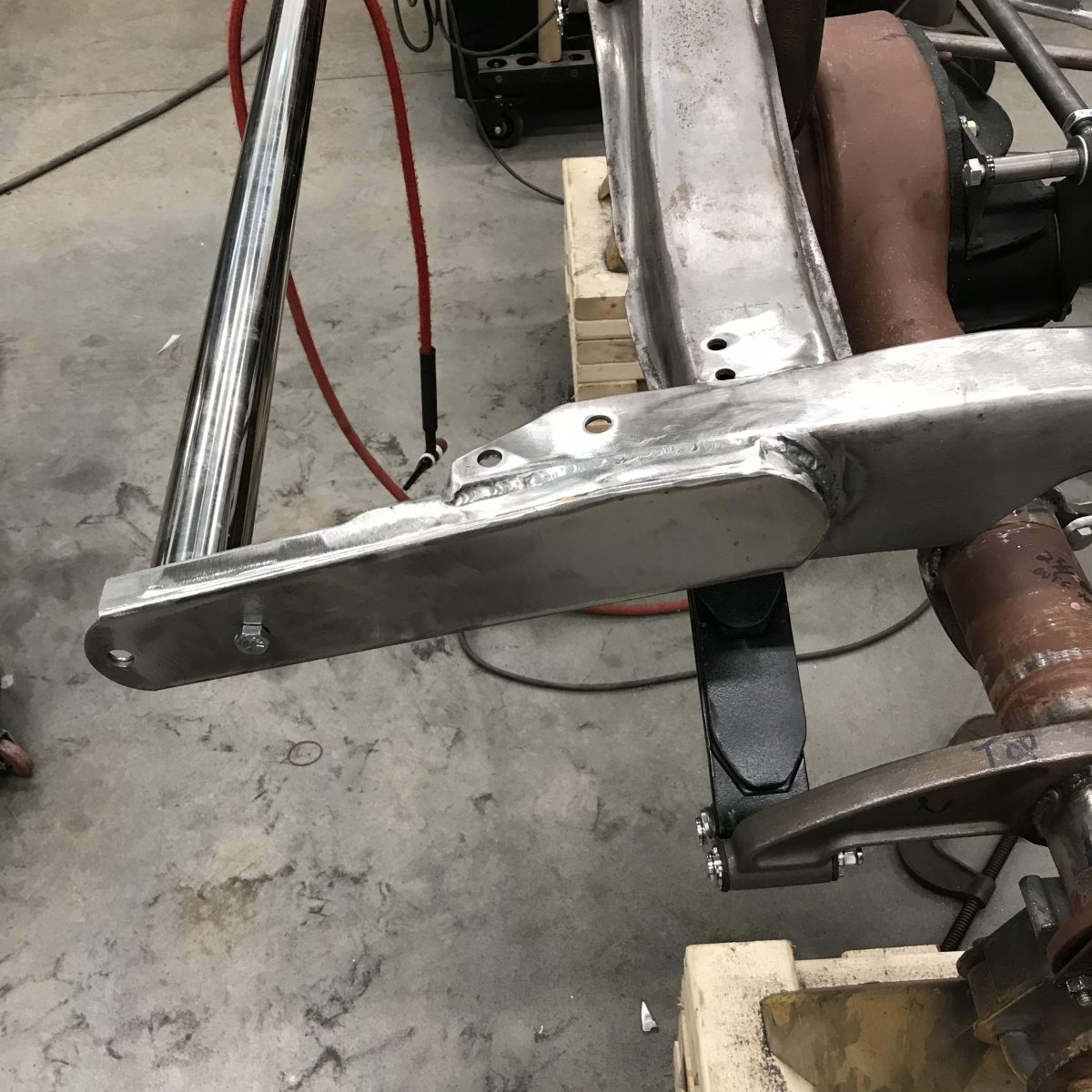

    Stubby rear rails with spreader bar. Since I narrowed the rear I had to graft the horns on the outside. I wanted a full width spreader bar.

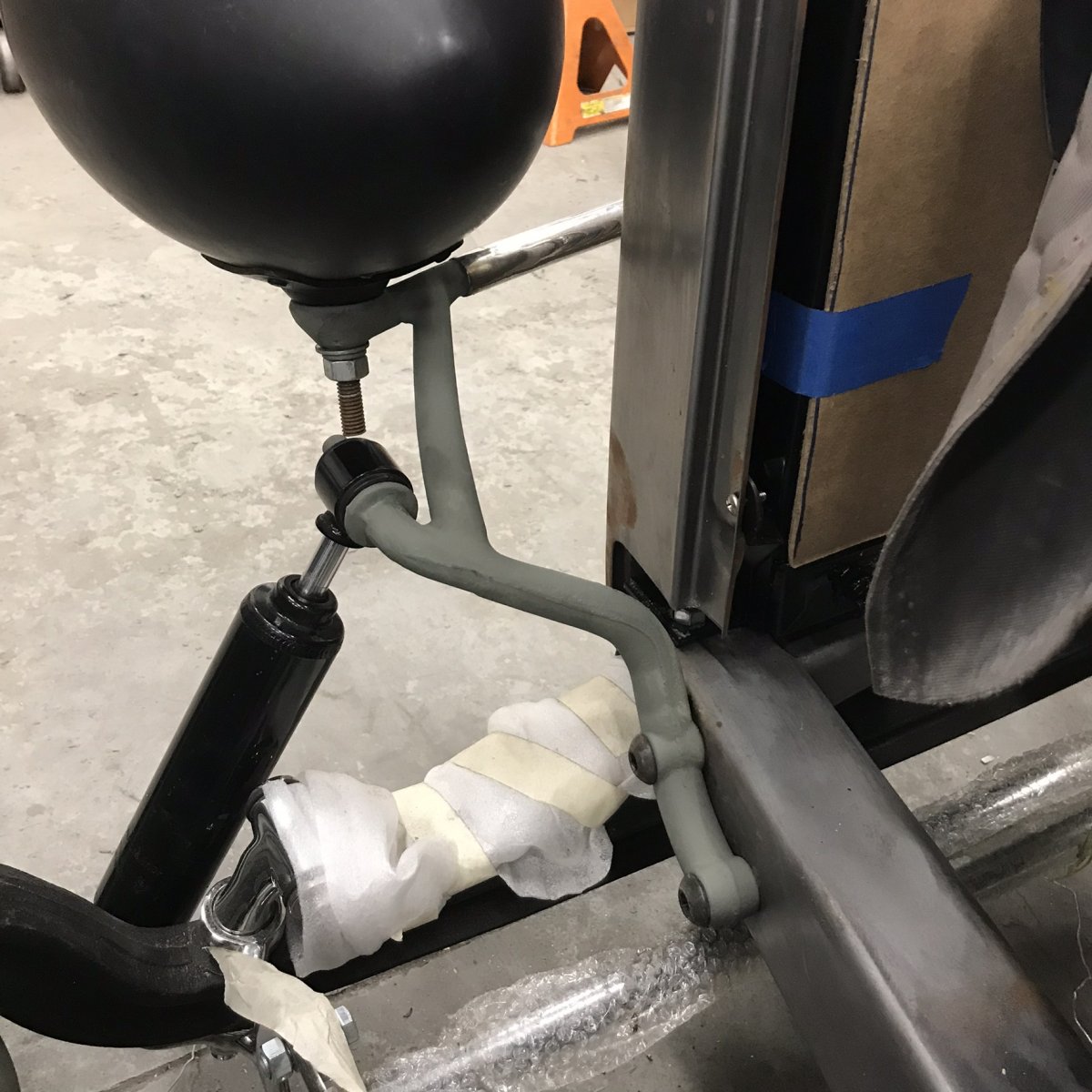

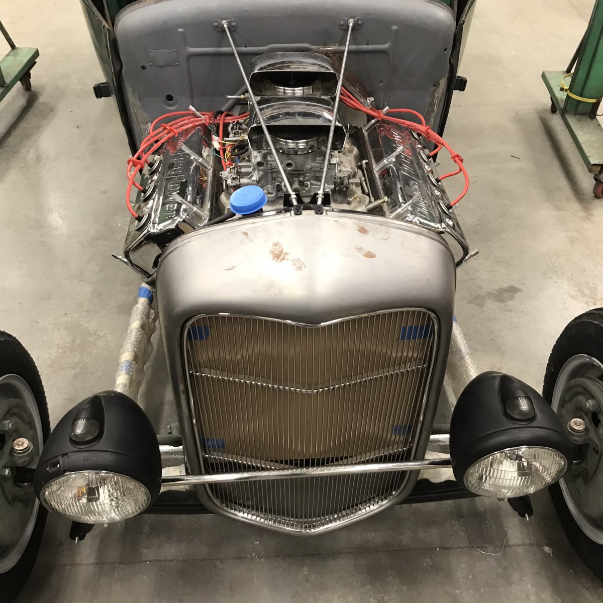

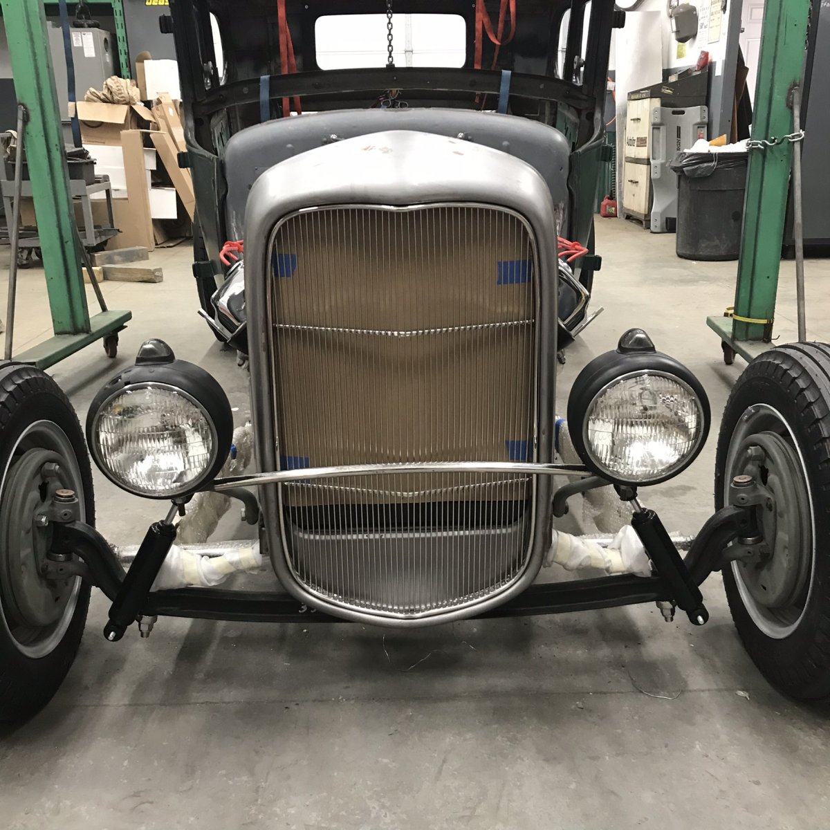

    Got the headlight bar / shock mounts setup. F1 Shock mounts combined with 32 B headlight bar and Guide 682C lights.

    Very nice! Could you show some more pics of what is holding your ft spring pack to the cross member?

    Nice fab work, the rear spreader was a great idea.
