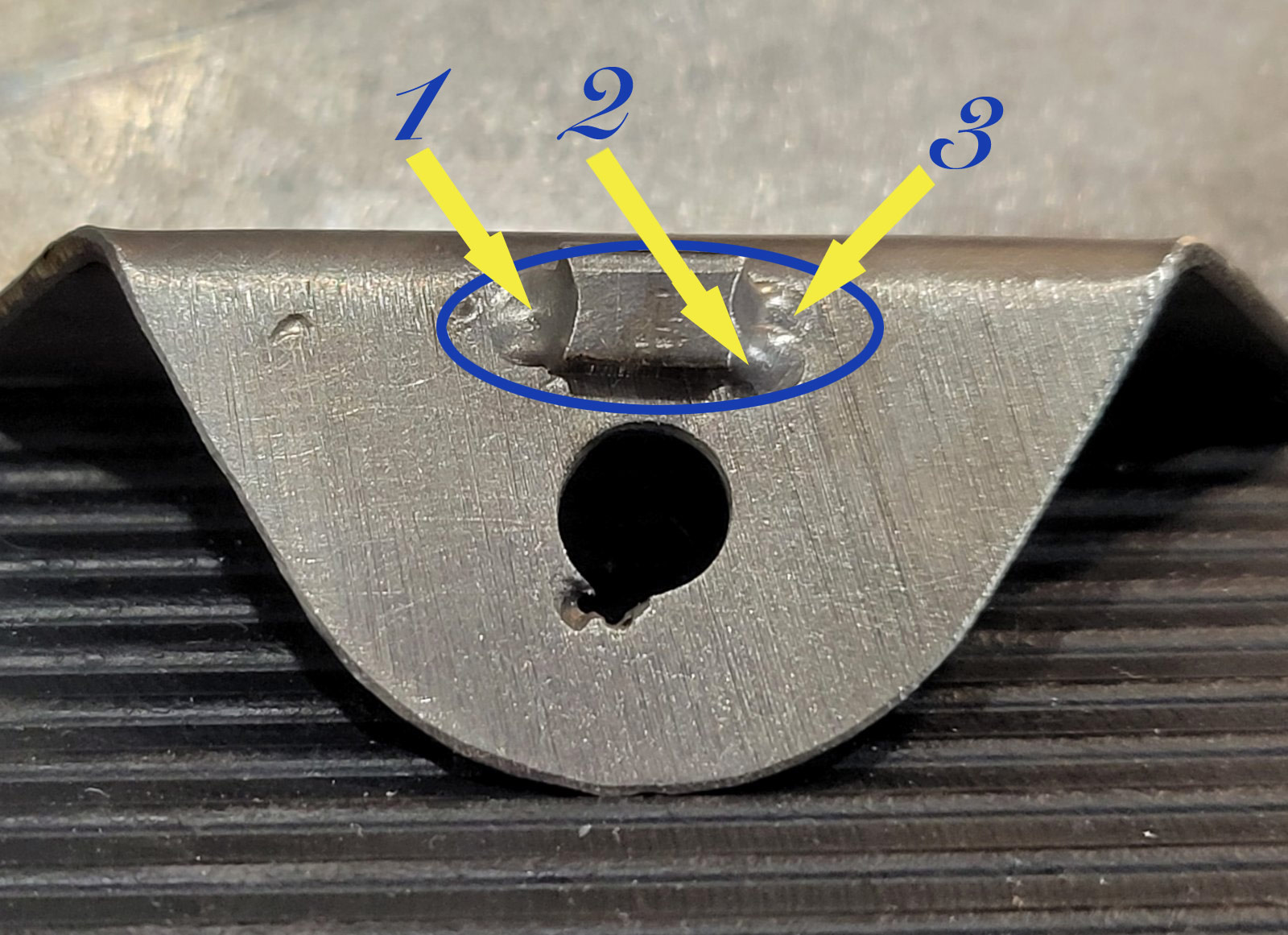

    I'm referencing these three divots...I was thinking there should be two but perhaps all 3 are supposed to be there...I was thinking of the lineworker who drillspotted those all day long...
    Is that the original piece below or you fabbed it? I was thinking its the original...If it isn't you did a great job of making it look like an original...

    @Stogy pretty sure he made it

    Yep, Tim's correct. It was made for the car. I can't buy one but they can be bought... haha.

    Well I stand corrected @-Brent-...are those weld pools or drill spots...when you can convincingly create the past you get bonus points...

    It's a small piece of steel tacked in place.

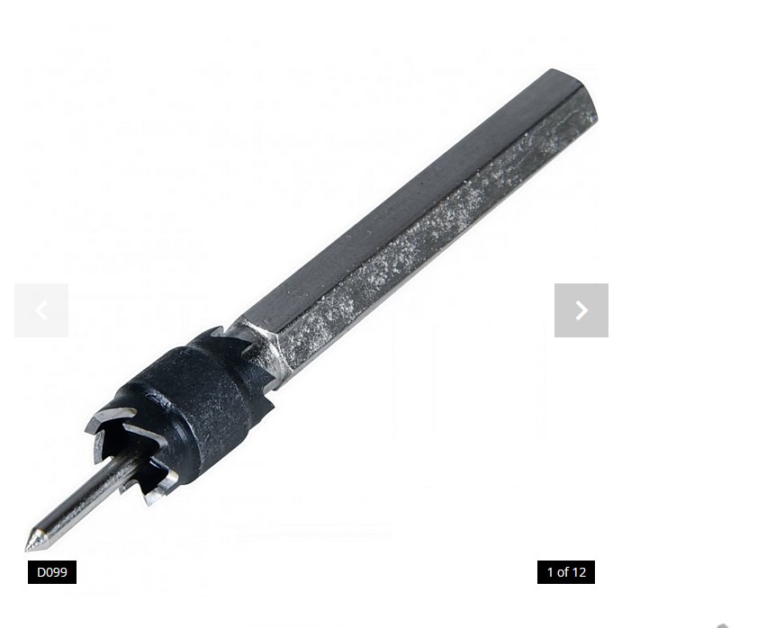

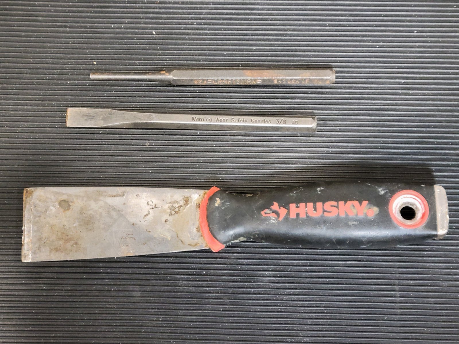

    On this one, the spot welds couldn't be seen after the sand blasting. So, I took some scrap sandpaper and sanded for 15-20 seconds until the spots showed themselves.
    Then I center-punched them and got to work. This one fought me a little because I didn't removed the door latch since the screws were seized.
    After I got it pulled, I fixed up all my self-inflected damage on my homemade railroad track anvil.

    You don't show how you are getting the spot welds apart so I add this that may save you some time and effort.
    Sold in a lot of places (not my ad) simply center punch the center of the spot then one of these in a hand drill and it cuts a perfect circle around the spot weld WITHOUT going into the second layer, then the two pieces come apart easily.
    Cheap and the cutters are replaceable easily when the get dull. :)
    Much smaller than it looks in the photo, that extended tip has a spring behind it and it retracts when you push down on the drill.

    I don't use cutters like those @loudbang. I have spot weld bits, which I like (I think they work better), but even with them there's no getting the full weld in spots (referring to these inner door panels).
    I drilled and stepped up in size because whatever spot-weld process Ford used on the assembly line, back then, it doesn't create a weld that I've found can be cut/drilled completely every time.
    I don't know if it's because of how the panels sit or if it's an access thing, but the spot weld can be off by 1/4"-1/2" inch in some spaces.
    Spot welders we're familiar with are like touching the tip of your pointer finger to your thumb. What I have seen with these past 4 panels is that some spots are that way and others you drill out but the panel is still welded nearby.
    This has been so with every panel.
    I started using this Husky stiff chisel/scraper to help break the panels free
    Some of the spot welds all you need to do is drill them out and tap at the lower metal with the punch but stiff scraper chisel helped make the process faster with less mangling.
    Like anything, you have to make the tools you have at your disposal work for you.

    That would have helped! Looks like the perfect tool.

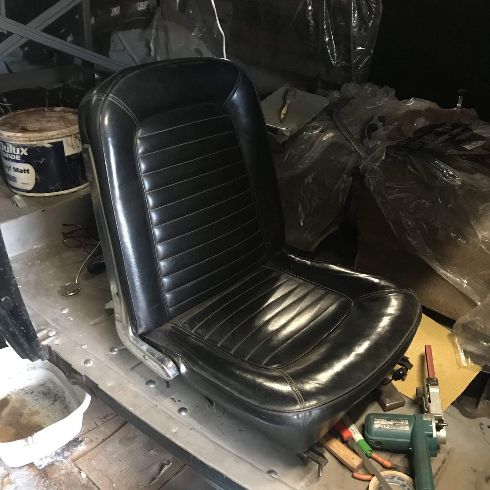

    Enjoying your updates, that diamond shifter is killer, and nice choice of seats
