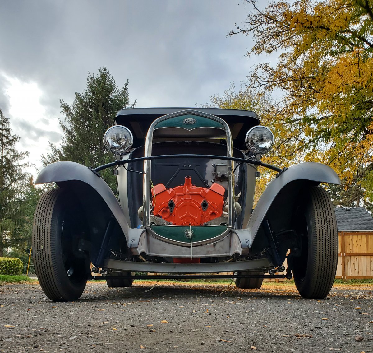

    Size Matters: 60s era Motorcycle Headlights on a Model A
    This car wouldn't look right with anything but a pair of small headlights. Smaller headlights are an element of many 60s hot rods that I've always loved.

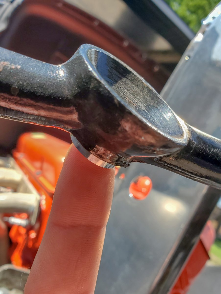

    I chose to run (for now) a 5-3/4" bottom mount headlight. Something you'd find on a Panhead or a chopper of the era. I have a few original KD-869s (Bates) but none of them match since the housings vary and there were minor changes over the years.

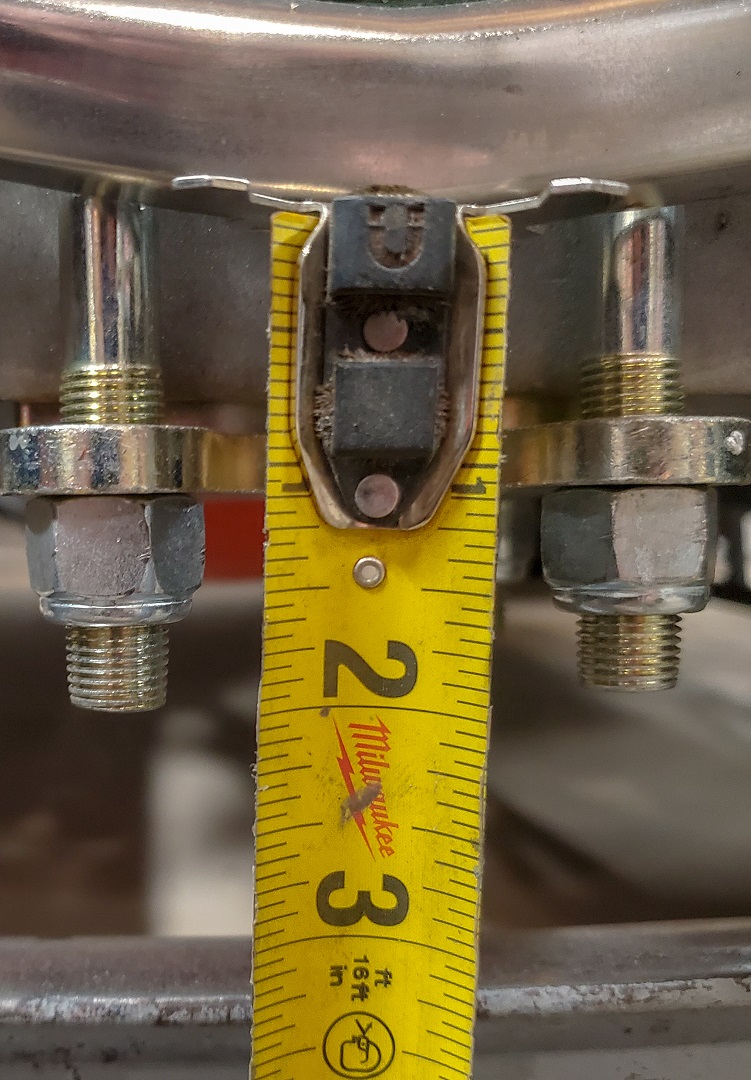

    While I searched (and ended up collecting too many buckets), I came up with an idea of how to mate them to my headlight bar.
    I stole some Play-Doh from the kids' art cabinet and sat out on the tailgate on a warm evening and came up with an idea.
    This was the idea I started with. I needed something flat for the headlight mount to sit on. Also, the lights run a smaller headlight mount bolt.

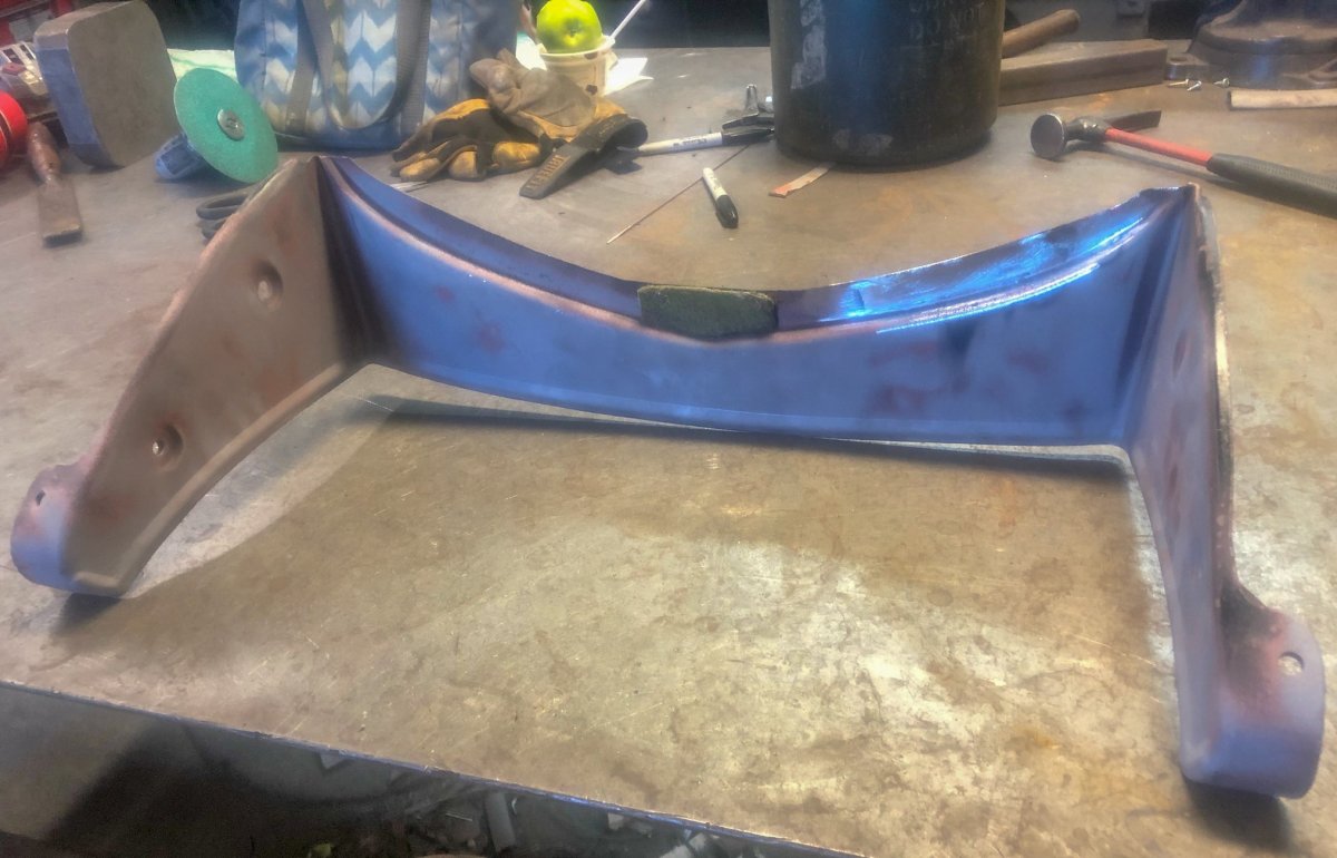

    Here's what Brian (my pal who narrowed the Olds/Pontiac rear) came up with:
    Here's what they do:
    Here's the mount sitting on the stand:
    It looks a little funky with the washers staggered. I didn't want to "over squeeze" the tabs. I'll address that later. THis is just a mockup.

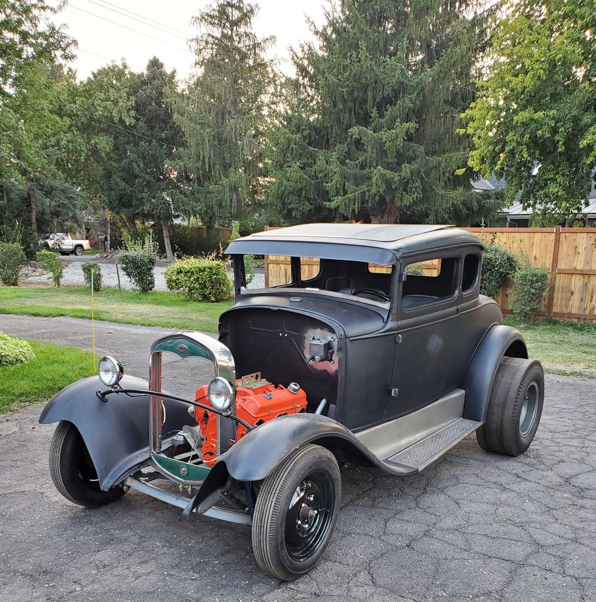

    Here's another pic.

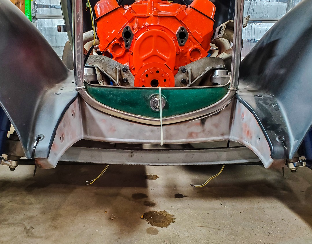

    And here's a teaser of how the exhaust will exit on the sides. It's just the belled tip set in place. No exhaust work done, yet.

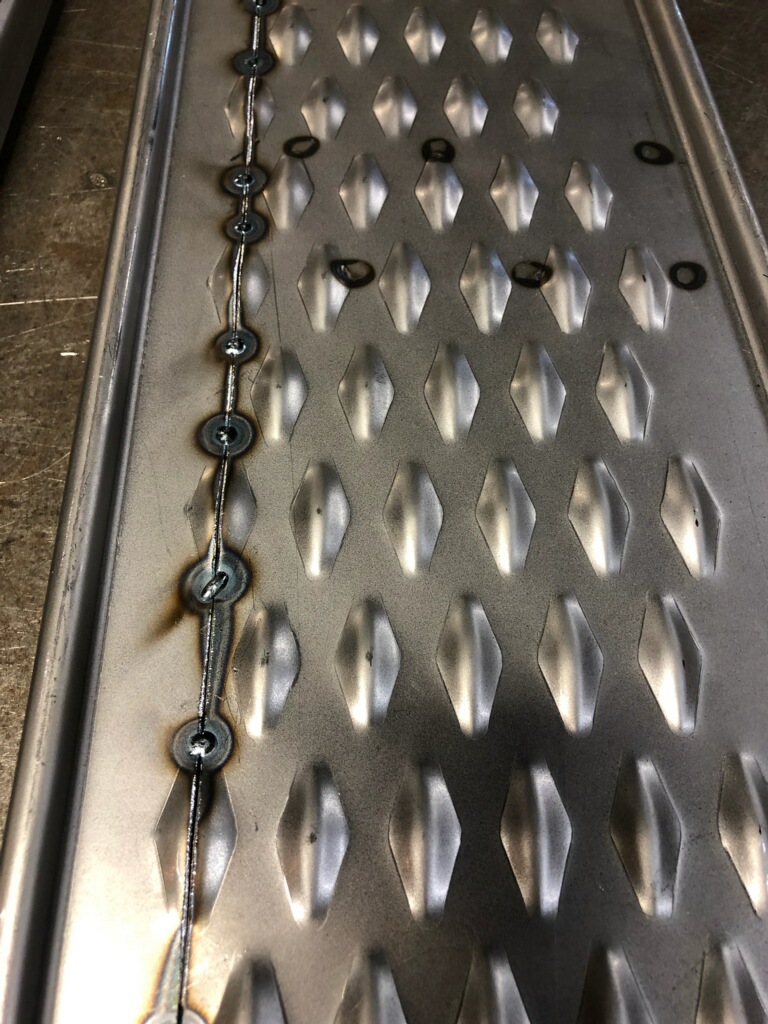

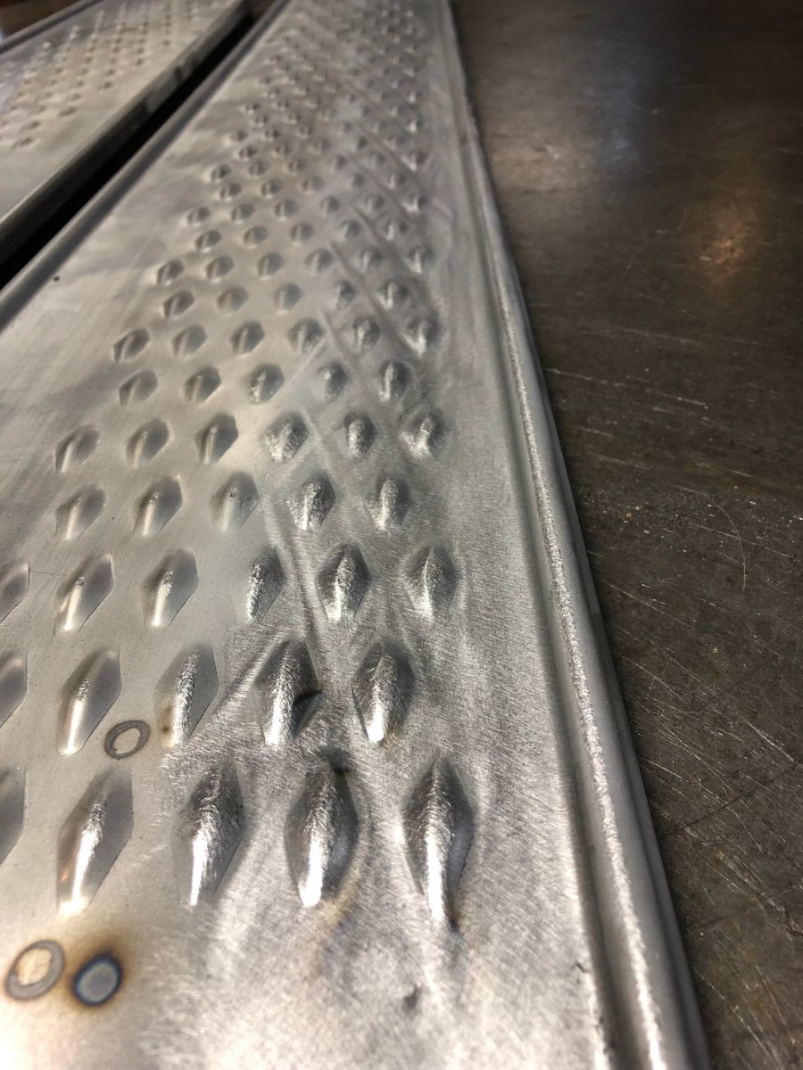

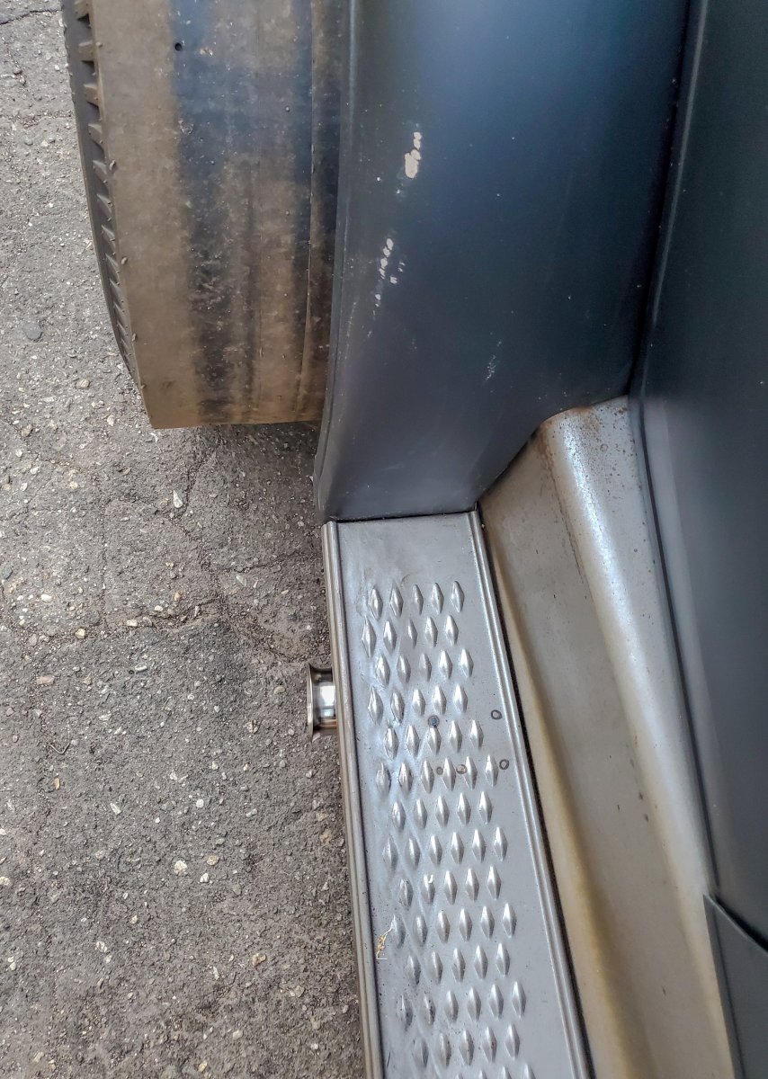

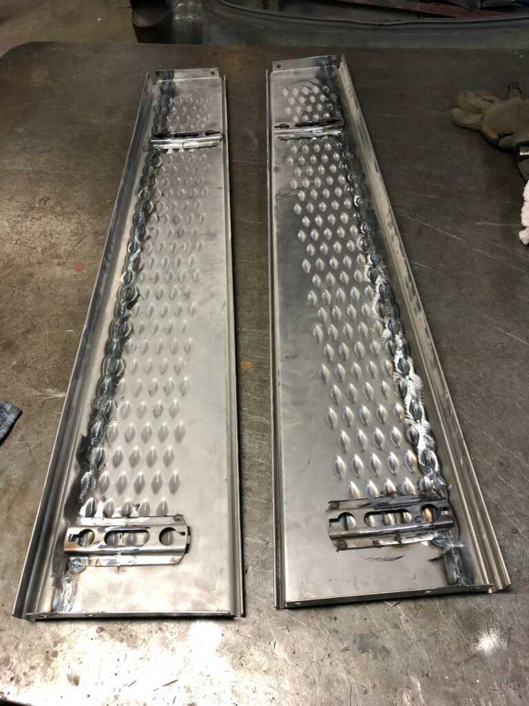

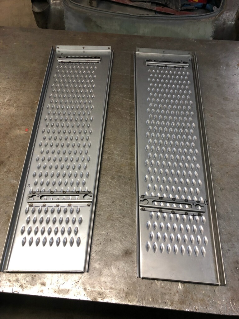

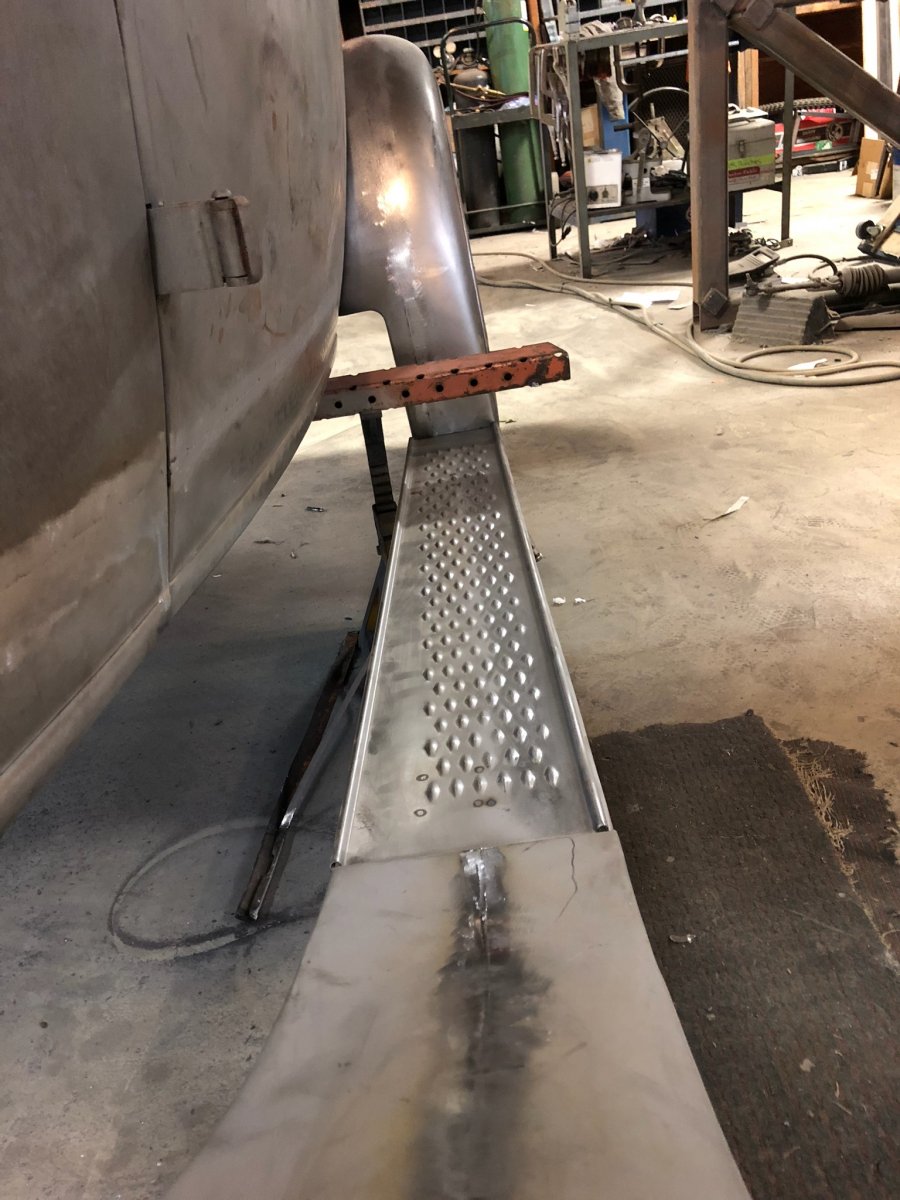

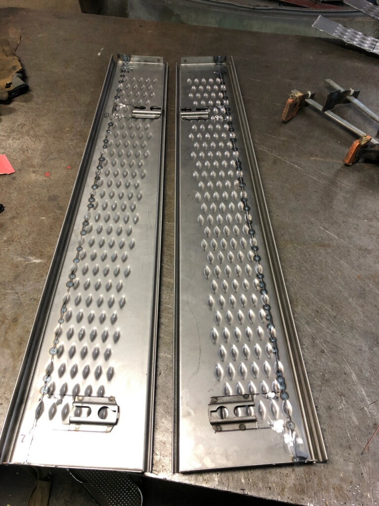

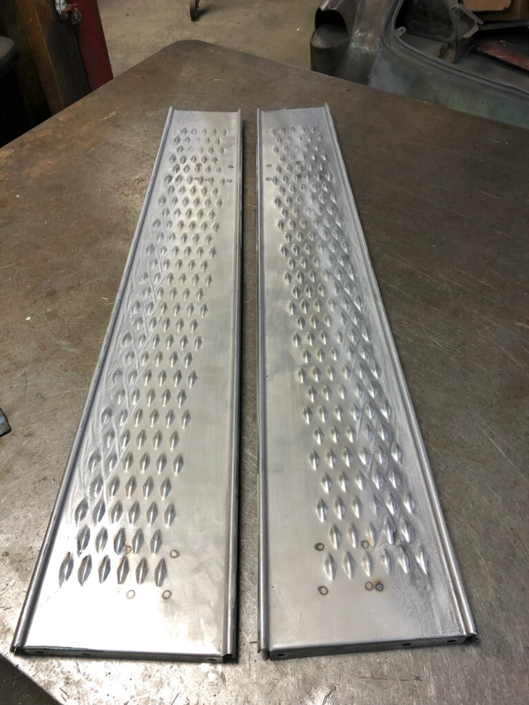

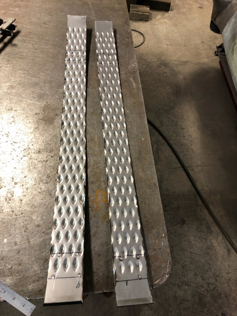

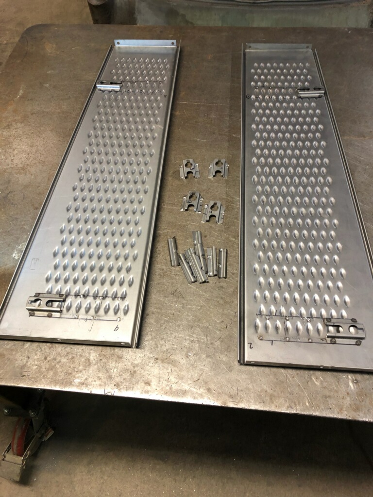

    If you find a used set they're usually pretty inexpensive. That's what I tried first, since we were going to modify them. However, I ended buying a set from Rootlieb, which is about the best quality you could find.
    For those wondering what the heck we're jabbering about:
