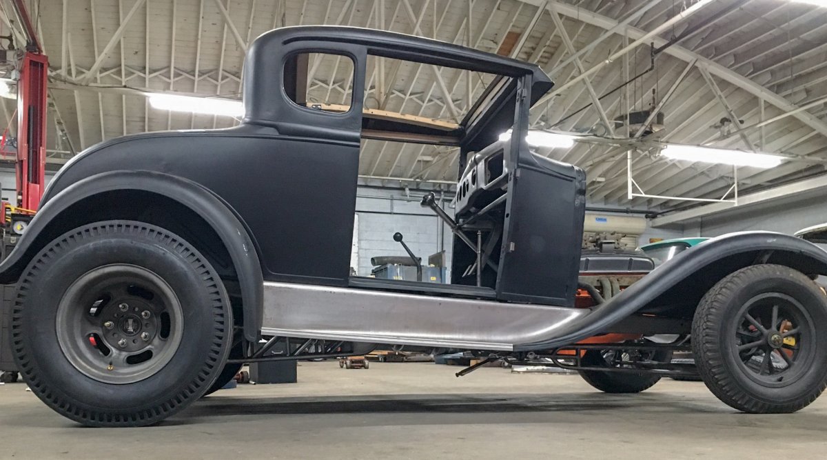

    1st Real Mockup - We HAD to Know:
    I've owned this coupe body for nearly 12 years. Last night, for the first time, I didn't have to imagine what it will look like as a roller.
    In order to make some decisions on a few things, we wanted., needed... HAD to see it mocked up.
    Model A Coupe Driver Side.jpg Model A Coupe Full Fender.jpg Model A Coupe Interior Muncie and Brake Lever.jpg Model A Coupe Passenger Side.jpg Model A Coupe Side Shot.jpg Model A Coupe Slicks Rear View.jpg
    This is mocked - not final. There will be some changes, some adjustments, and there's still a shortlist of things to do.

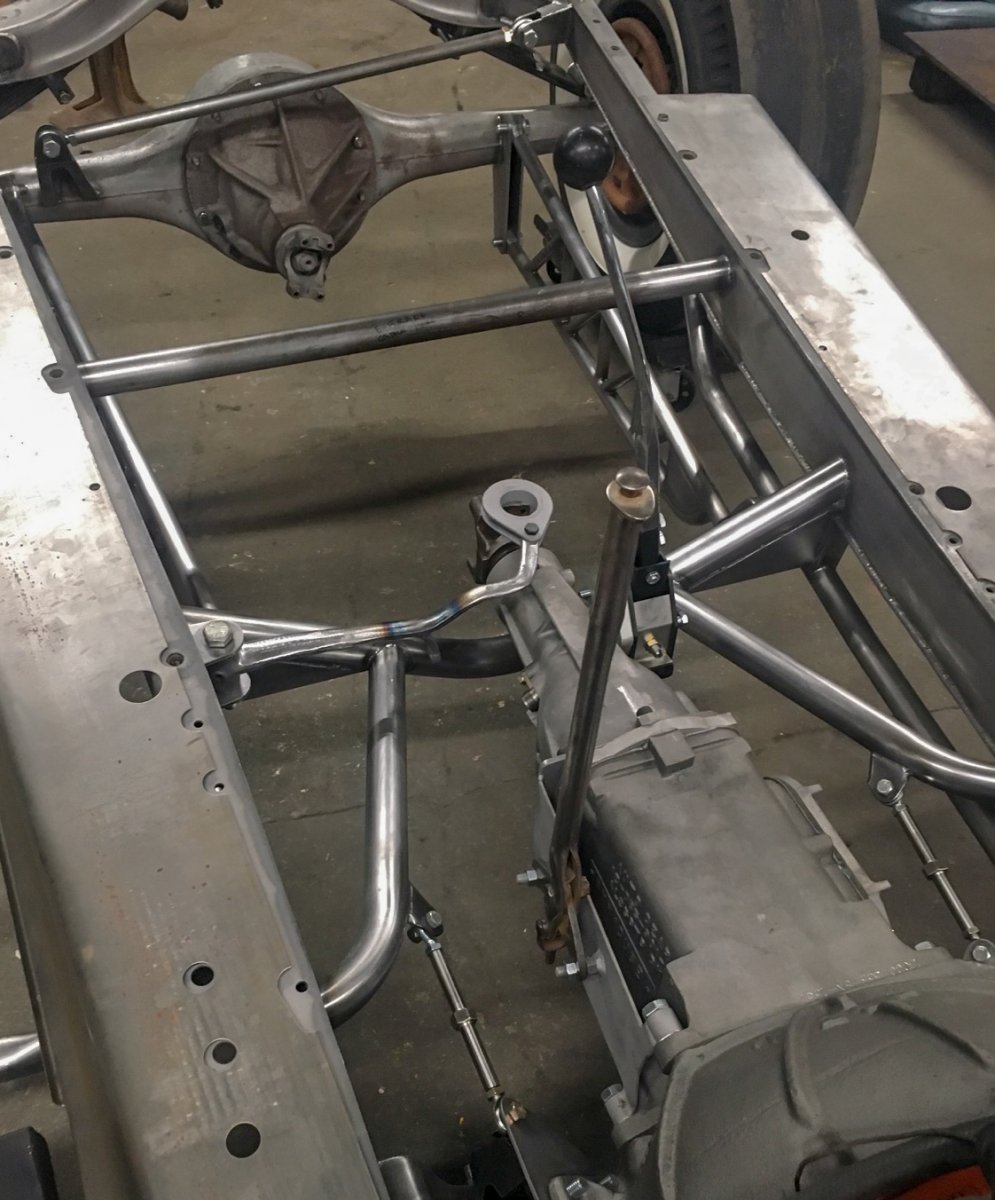

    Model A Parking Brake Handle, Adapted to a Muncie 4-Speed:
    There's not much stock Model A left in this car. The brake handle was something I wanted to retain.
    Jim Stewart made the bracket and bellcrank assembly for me after I saw the one he made for his tall T. We modified it a bit to work in the coupe.
    The tab was moved from the top to the bottom of the arm coming off the frame. The arm was heated and bent to fit. It now sits, centered, right above the tailshaft of the trans.

    Model A Handbrake on Muncie Transmission:
    The linkage is done.
    Handbrake Linkage Muncie and Model A Ford 2.jpg Handbrake Linkage Muncie and Model A Ford.jpg

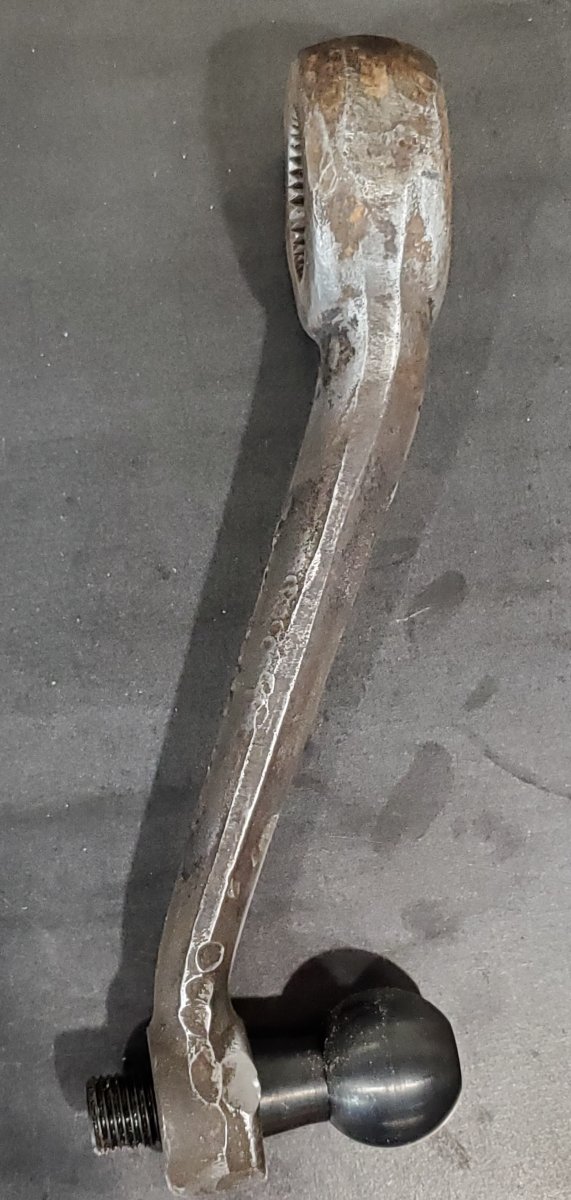

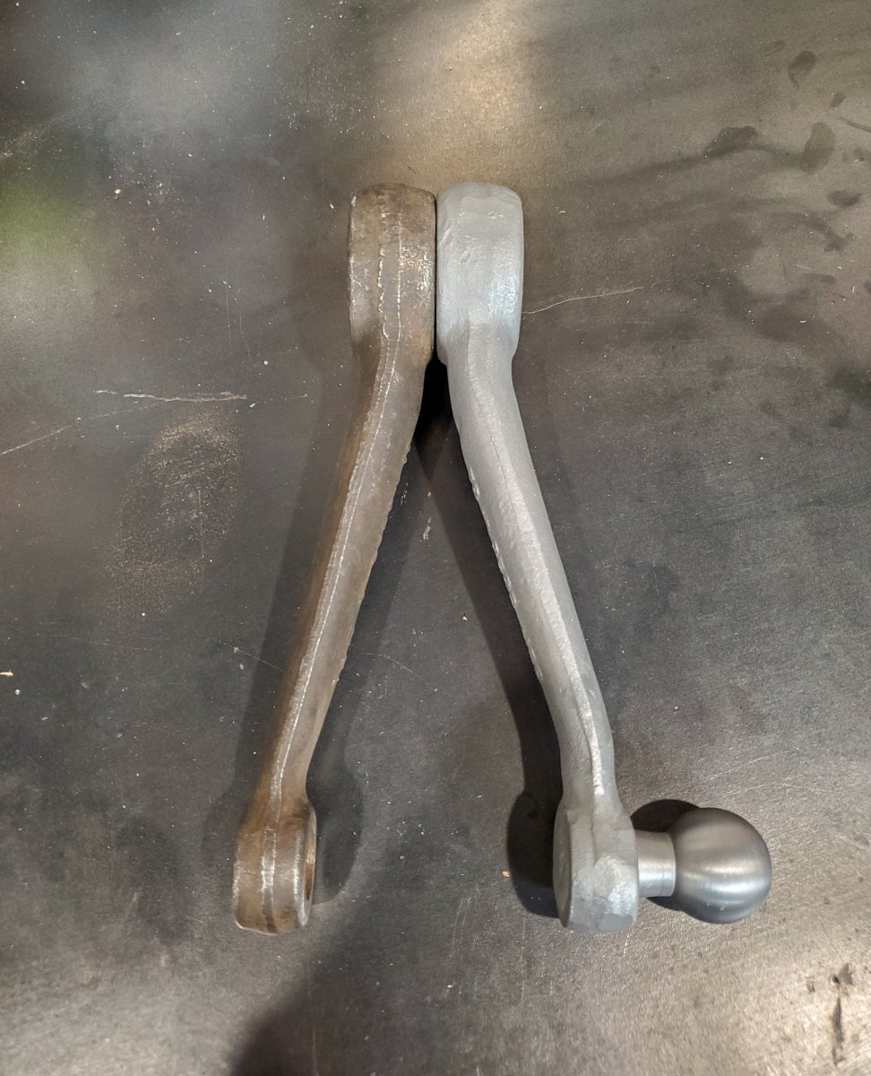

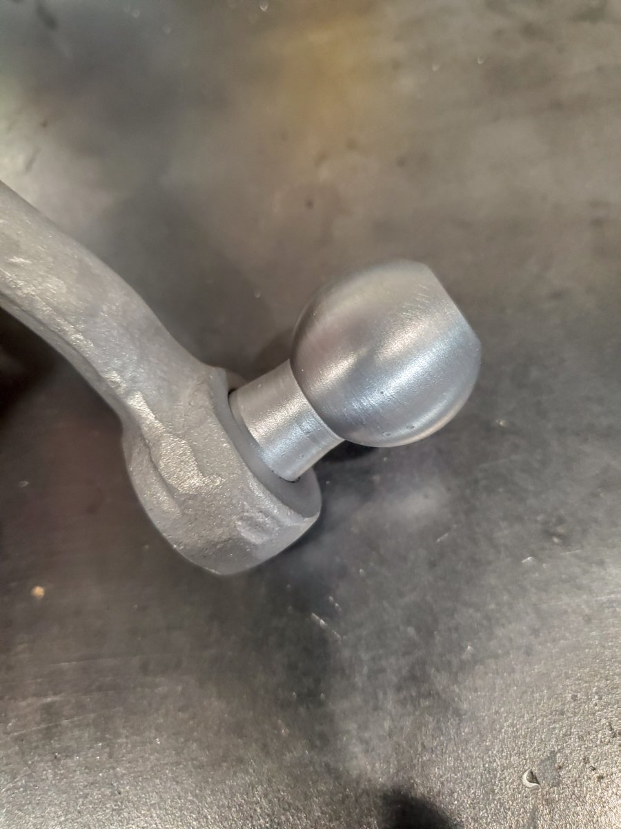

    Pitman Arm Modified to Clear Hairpins and Converted to Ball End:
    Here's the pic from the previous post. The idea was to use a 32-34 ball on a later pitman arm.
    My pal, Brian, changed the bend and did the ball end. The ball was pressed in, checked, pulled out and modified, and then pressed back in and tigged.
    He cleaned it up and there you have it. Below is a comparison to a stock arm.

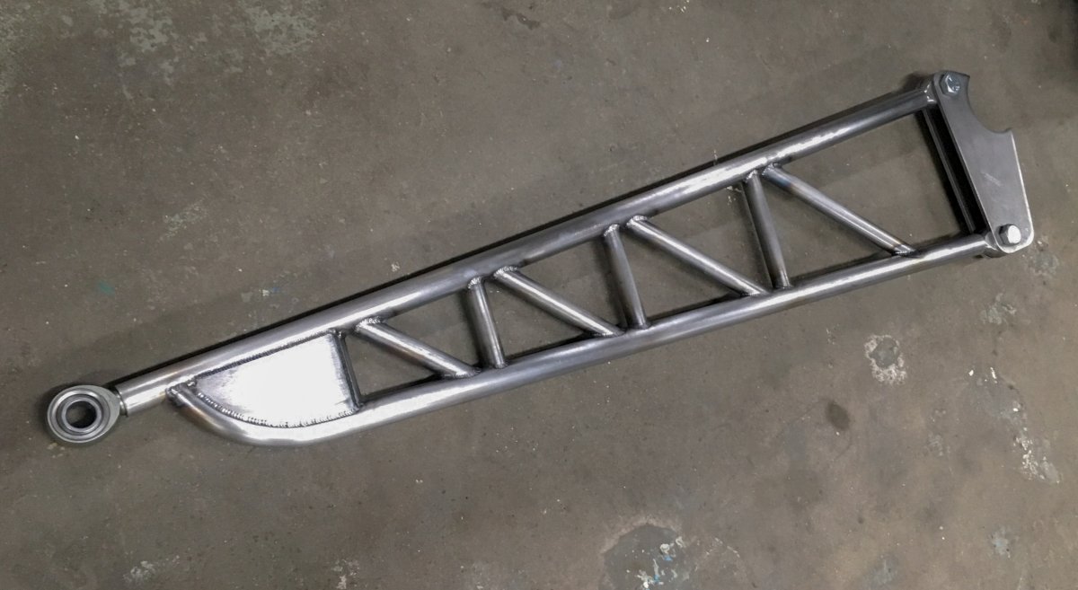

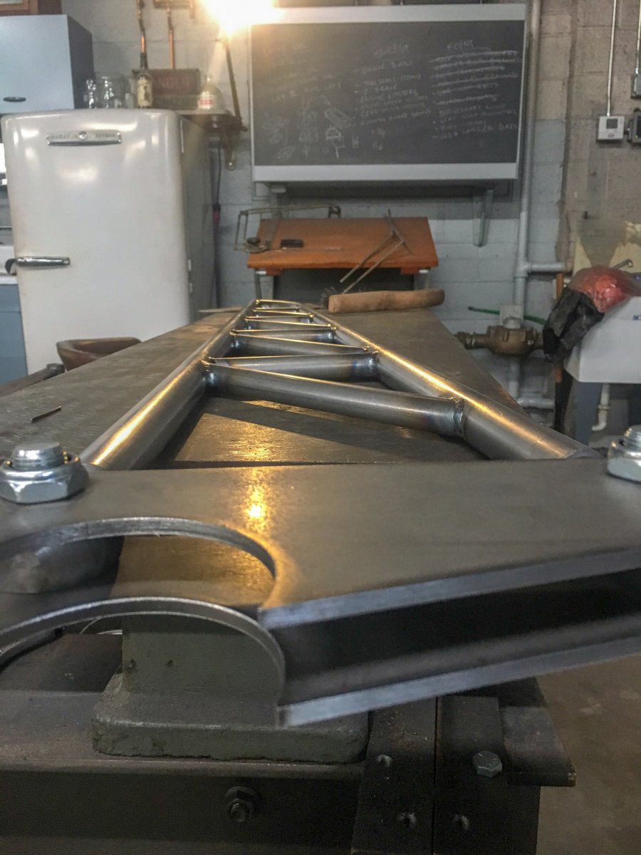

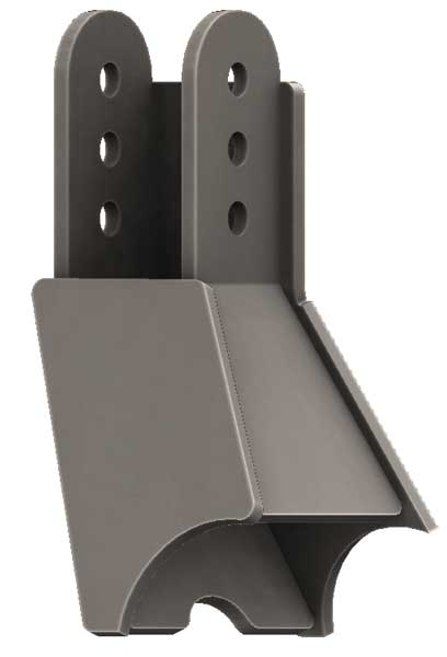

    Ladder Bars:
    I haven't really shown the ladder bars on their own. I've been waiting to post finished and adjusted pics but we've been doing other things. And, actually, tonight I was editing some photos came across the pics of the bars and I realized I'd forgotten to post them.
    I think it was @mad mikey wanting to see them... so, sorry for the wait brother!
    Here are some material specs:
    Main tubes are 1" OD tap tube
    webs are 3/4" OD tap tube
    They're still needing to be trimmed and fitted with jam nuts.
    If you look at bars from the 60s, they all have their differences. Ryan had these in mind, inspired by the model kits he made as a kid and the drag cars he drew while he was daydreaming. I had sent him a few pics of what I liked and I let him have fun.
    After hearing him tell me the back story to the design going back to his youth, I liked them even more.

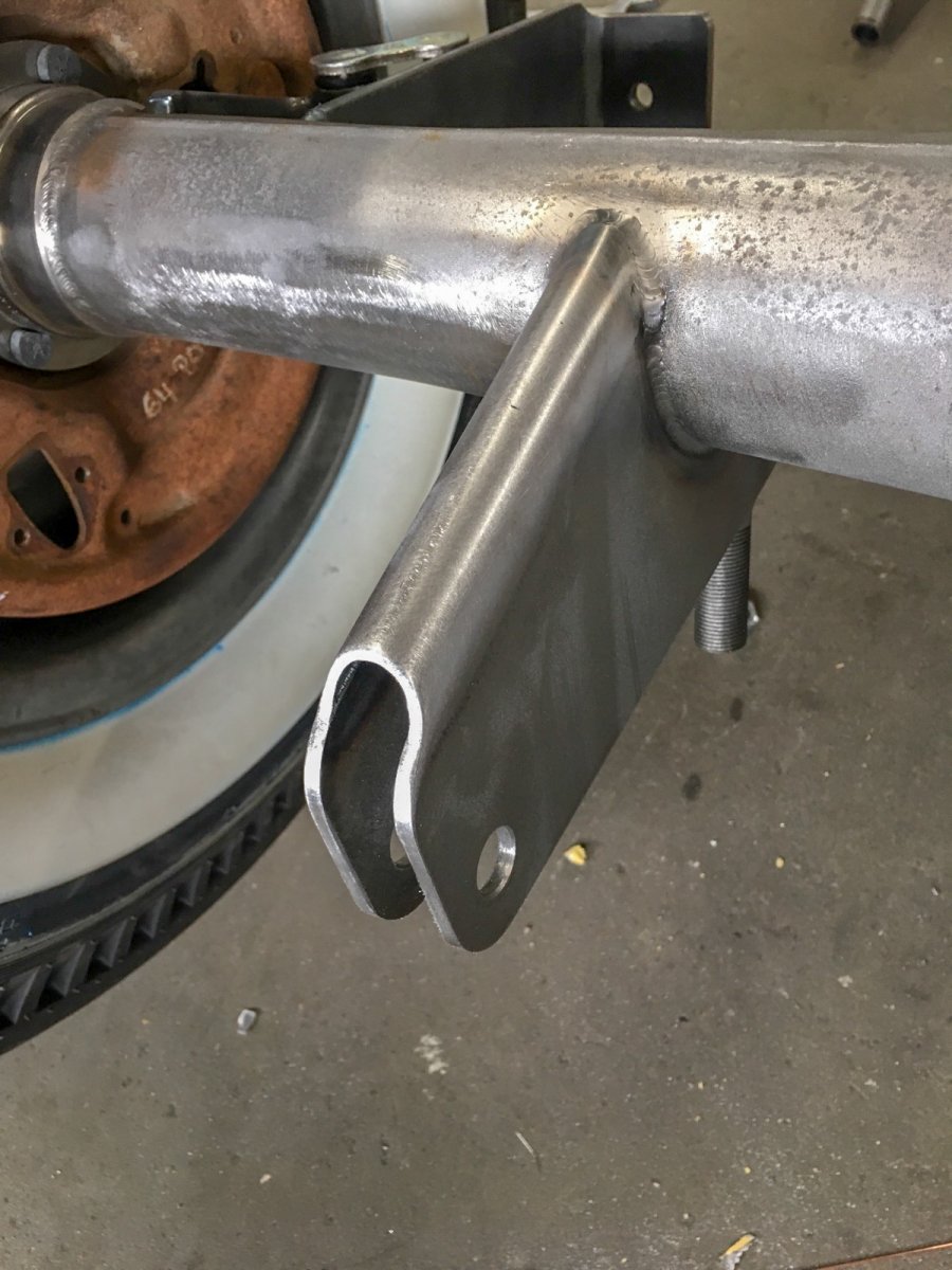

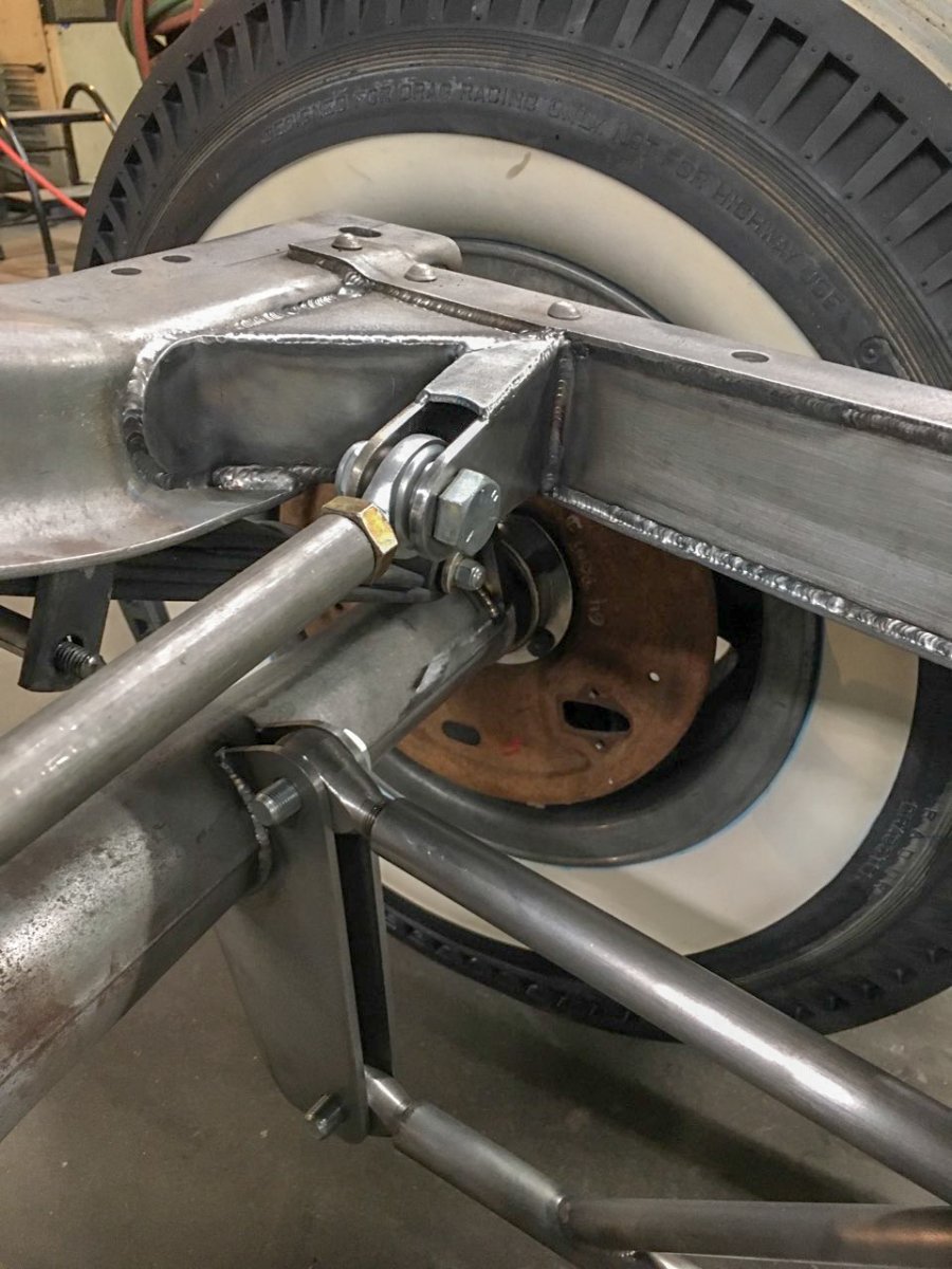

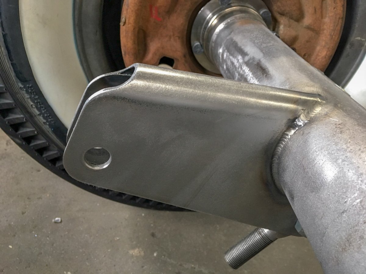

    Ryan split some tube and grafted it into the back of the ladder bar brackets. Nothing goes untouched.
    I love details like this.

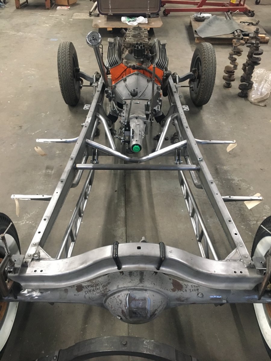

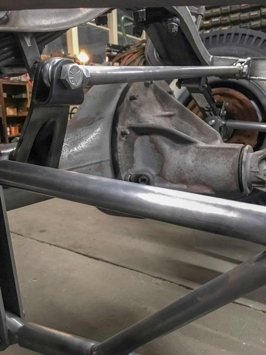

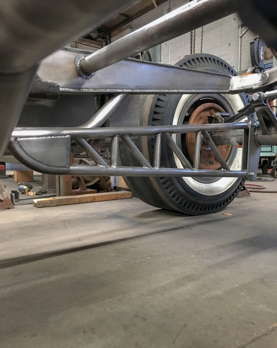

    A view from the top/back.

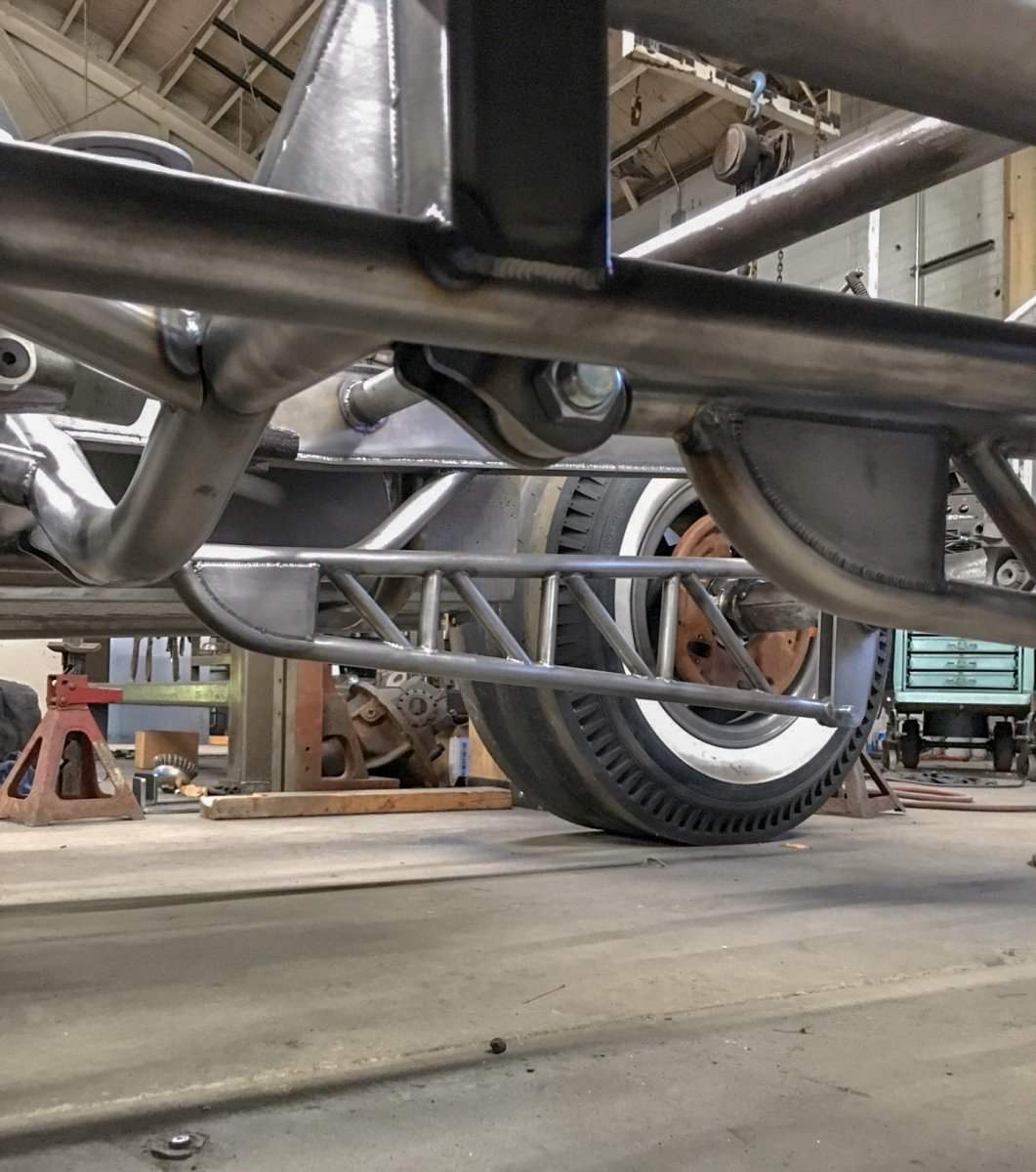

    From down-low, looking in.
    That front gusseted area is the way Ryan drew them as a kid.
    I love seeing the bars from this view!

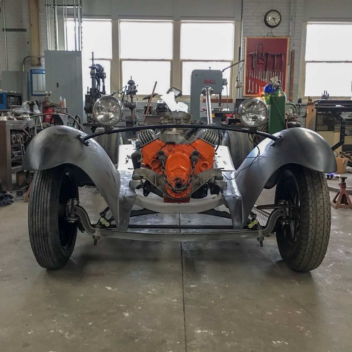

    Front Wheel & Tire Comparison:
    The first time I saw the 16x4.50 Firestones, I was pretty surprised at their small size. Mounted up and certainly in the pics, they don't seem so small.
    Here they are mounted on 16x4 steelies. I had them blasted when I did the frame and before we left, I sprayed them with epoxy primer. Last week, we dropped them off at an autobody shop for some gloss black.
    When it comes to finishing the car, these wheels will get some pinstripes. I think another inch out of the front is needed.
    Here's a comparison, side to side. The steelies land in the same place as the spindle mounts.
    In this pic you can see the heavy axle isn't in place. That's because it's sent out to get some attention.
    I'm looking forward, again, to seeing it back as a roller with the dropped 32 and steelies... and a few more items from the list.
