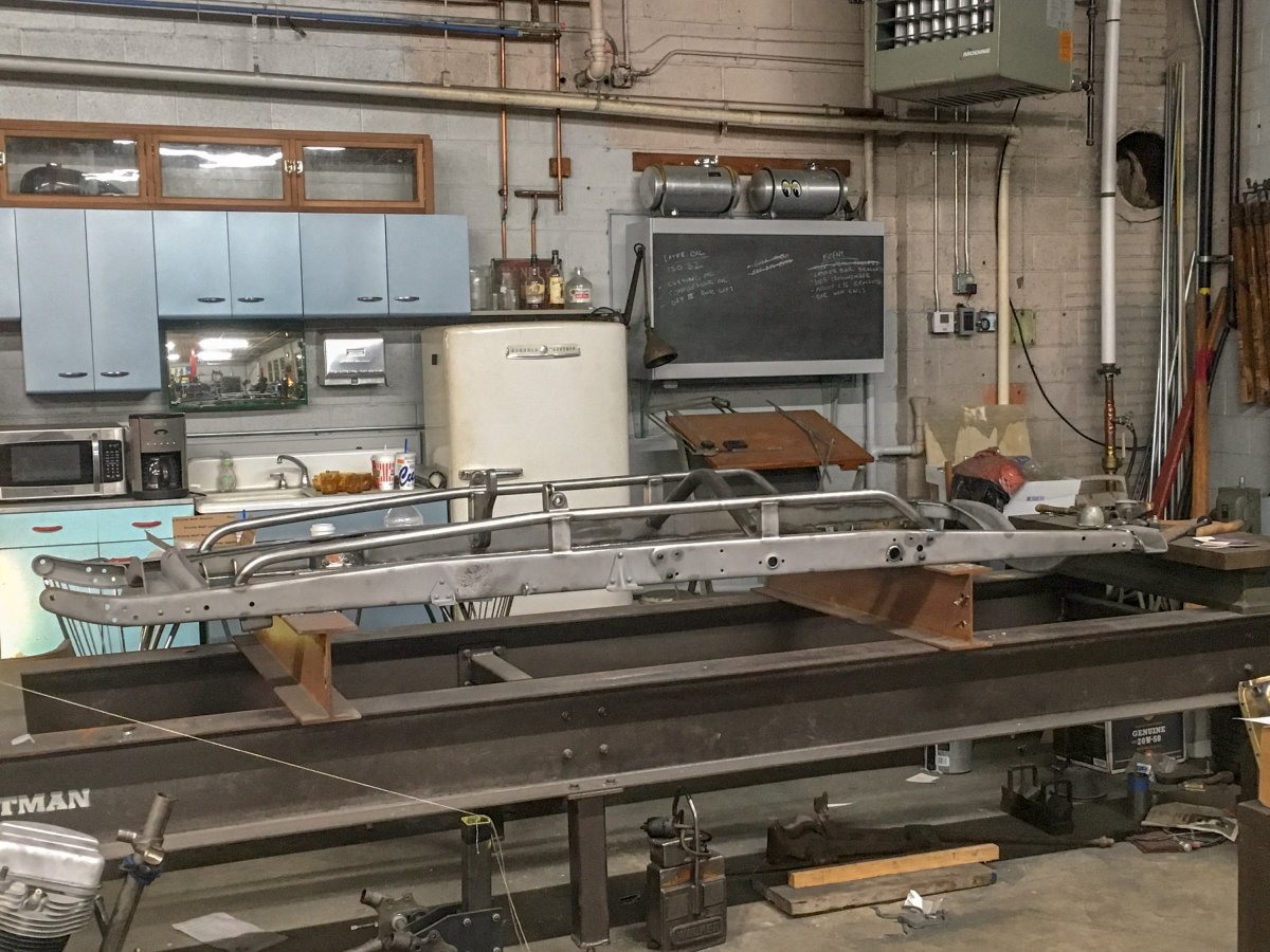

    Pulling the Body Off the Chassis:
    It's time to get the drivetrain mounted, so the body is coming up and off and the chassis is going to get all the attention.

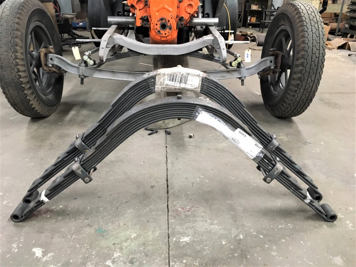

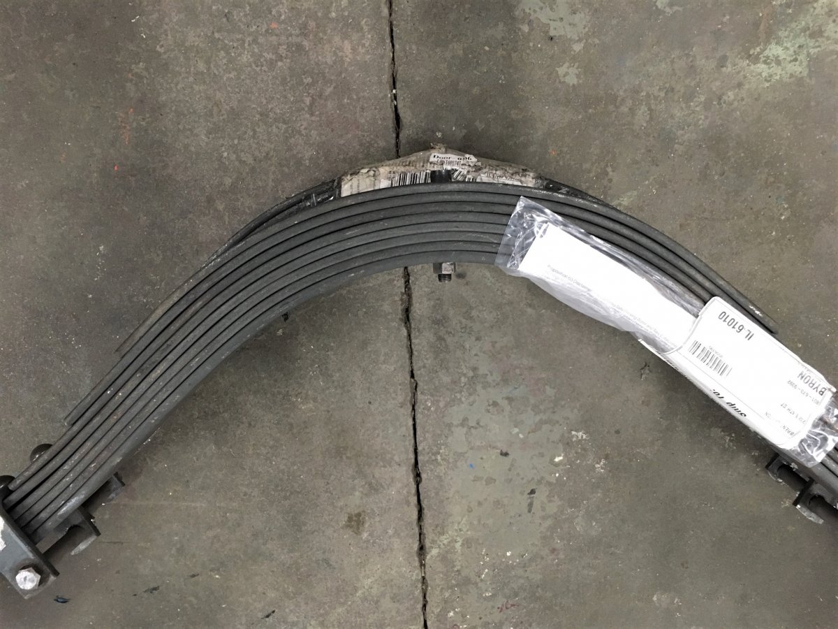

    Both are Posies narrow width springs. We ended up choosing the reversed eye spring to get the car closer to the ride height. Posies has been very helpful.
    Here's a spring comparison:
    The reversed-eye spring will be 2" lower.

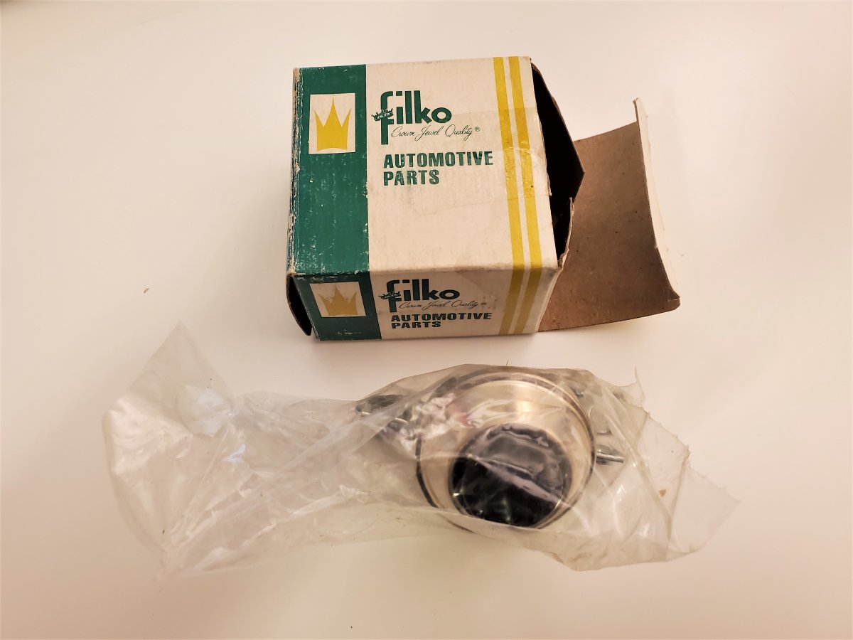

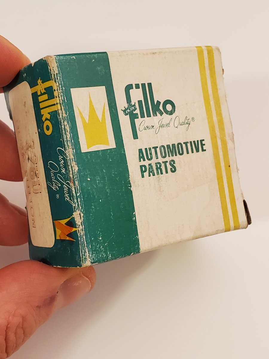

    I love searching for and finding old parts. So, when this NOS column-mount horn button showed up in the mailbox, I was probably more excited than I should be for such a simple part.
    I doubt modern imported equivalent buttons look any different - or that anyone would know BUT those are easy to find. This one took a little work. The cool thing, I got it for less than the others.
    NOS Filko Starter Button.jpg NOS Filco Starter Button Made in USA.jpg NOS Filco Out Of Package.jpg

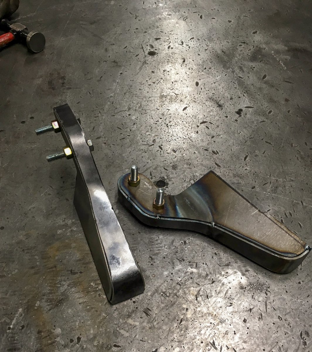

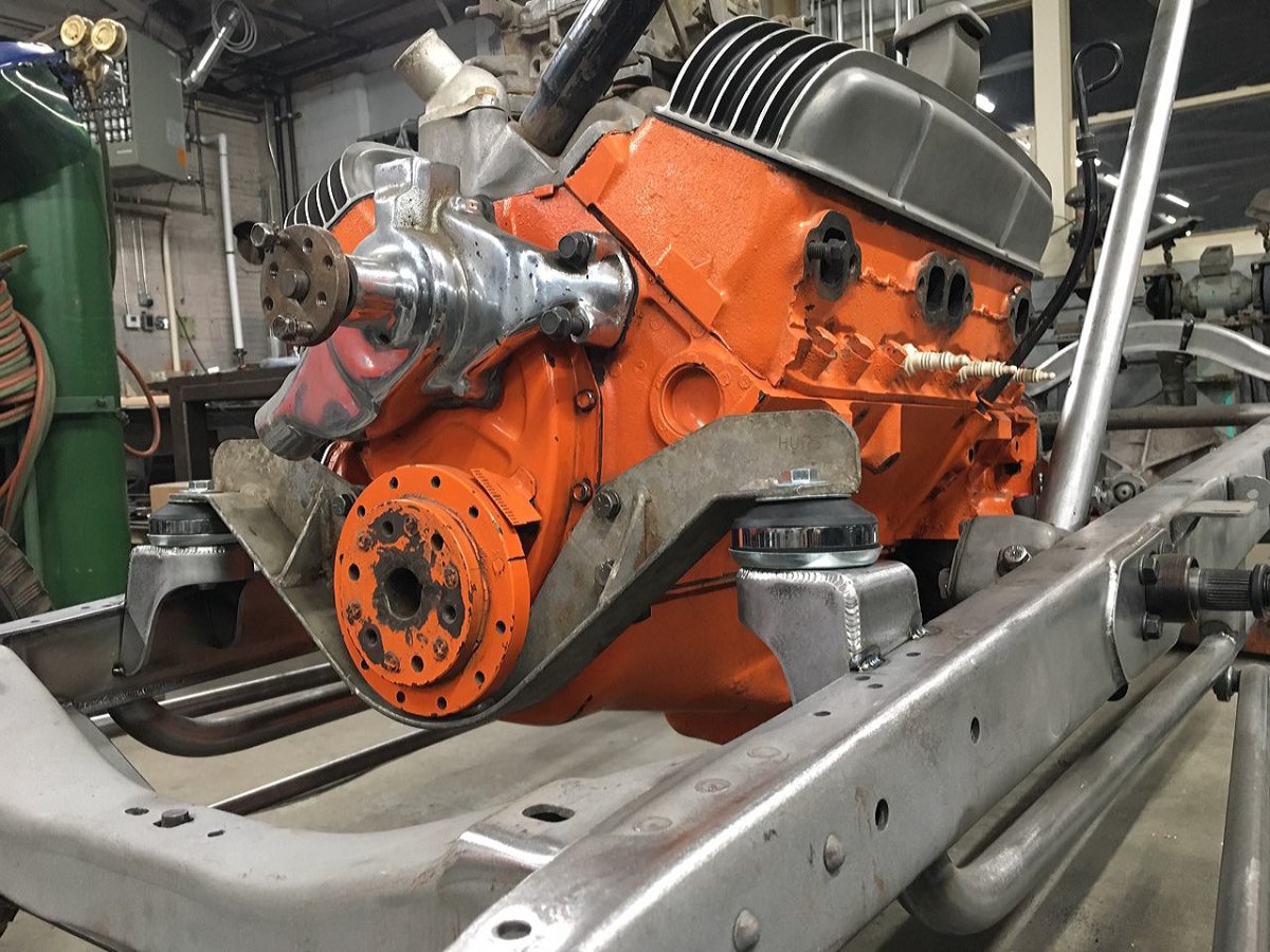

    Hurst SBC Mount and Frame Side Mount Fab:
    I didn't have time to write all that much the last time I posted about the front mounts. I'll drop some info and pics in.
    The engine mount biscuits (Competiton Engineering calls them Universal Engine Cushions - the part number is SS-011) were something I've heard to be careful of. The inexpensive ones are known to be really poor quality. Either they squish out or they deteriorate.
    Most guys that build their own mounts, smooth them over so they look really slick. I like the look but I love seeing the welds. I mean, this chassis is pretty fancy and all but I'm not a very fancy guy. I prefer exposed welds, especially when they look this good.
    Each mount was fabbed from two pieces. Here's the side piece that eventually was heated and wrapped around the top.
    And from above. They'll get finished welded when the rest of the stuff is fabbed.

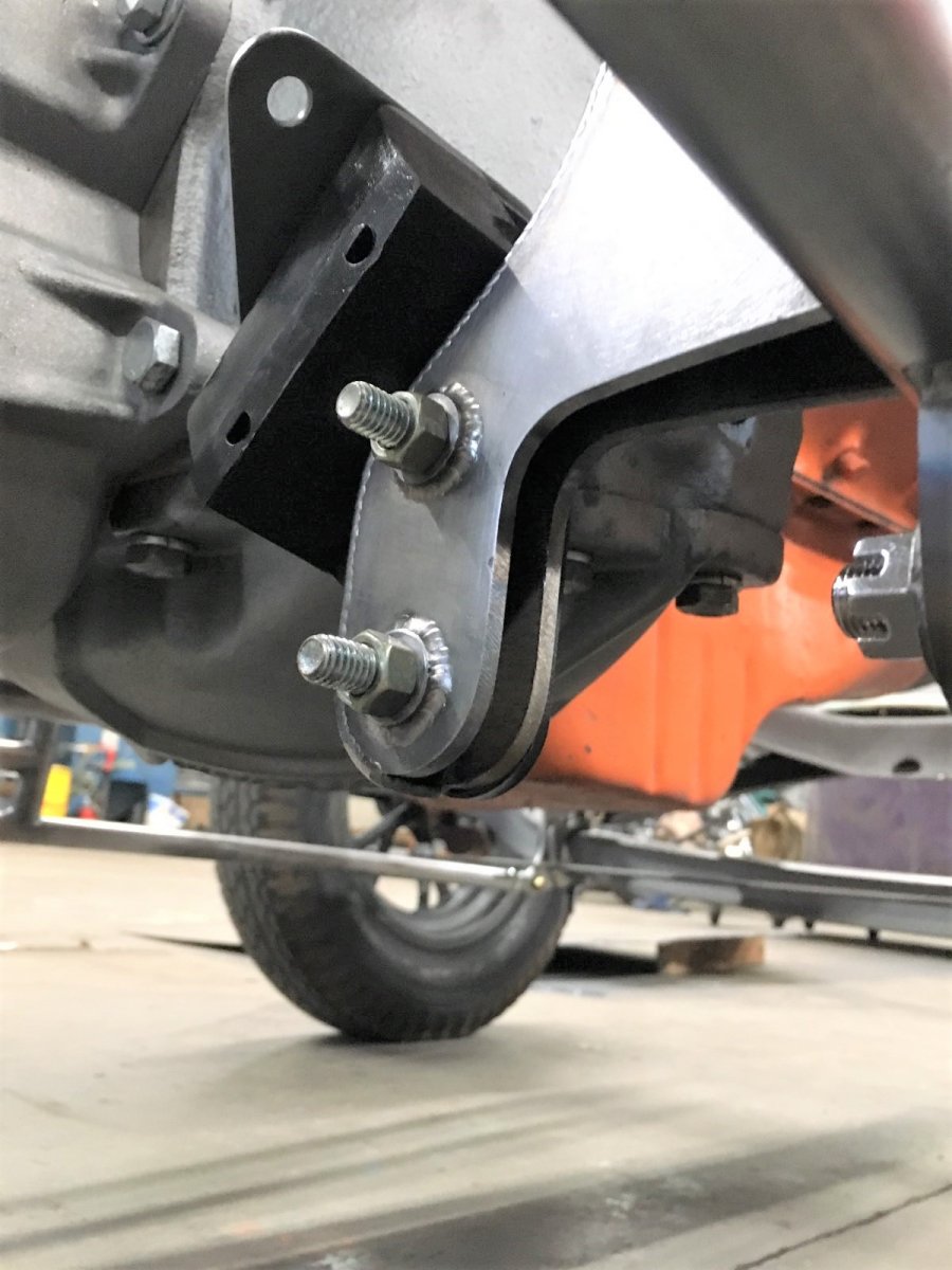

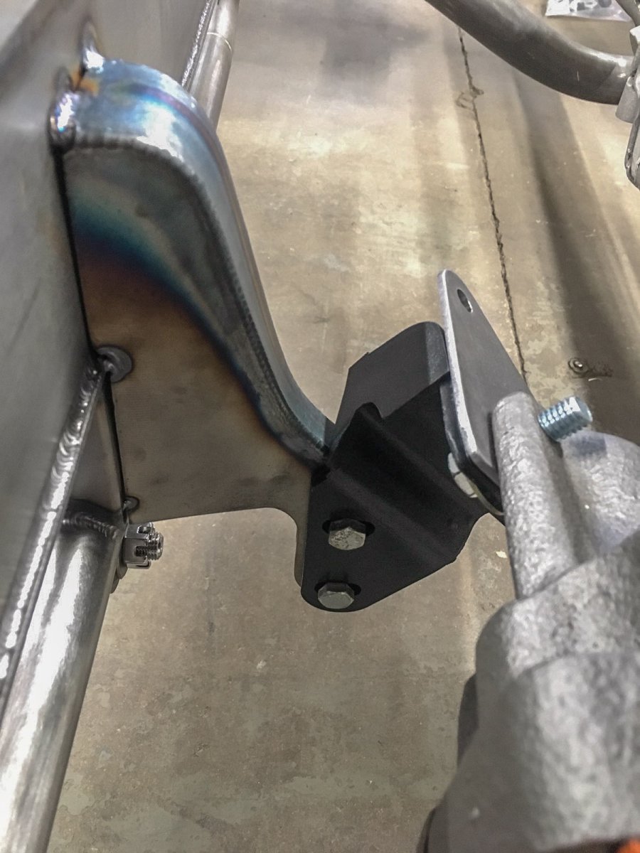

    Tri-5 Bellhousing Mounts Part 1:
    Since I am running an Ansen blow-proof bellhousing with the early SBC mount ears. I thought it would be neat to run OEM style bell housing mounts.
    This is Ryan's creation. They're pretty slick.
    Here they are tacked together.
    And finished welded. You can see the "step" on the frame side. That's because they weld to the boxing plate AND to the leg of the truss. These things are BEEFY. 3/16" sides boxes with 1/8".
    Crush sleeves were inserted.
    What they look like from either side.
    1947knuck, catdad49, AHotRod and 9 others like this.

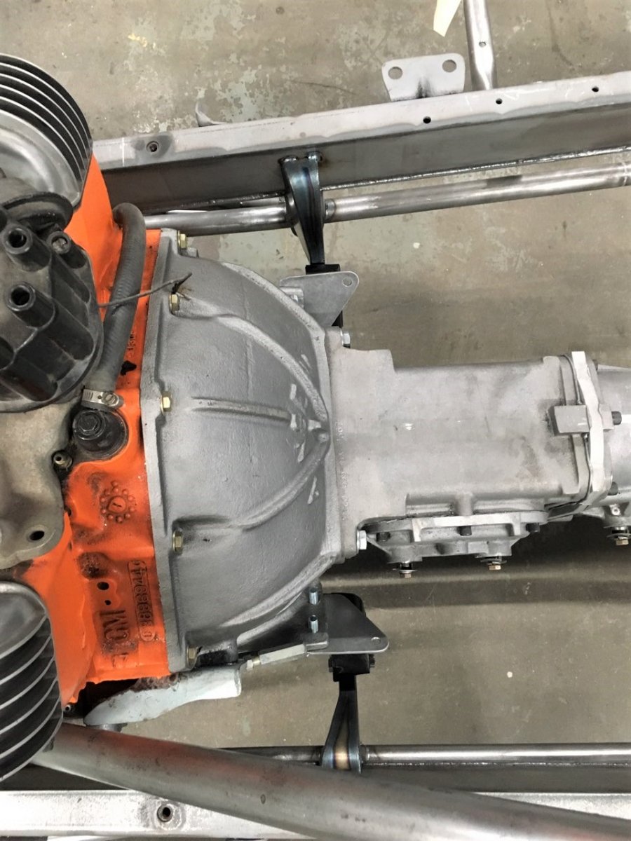

    Tri-5 Bellhousing Mounts Part 2:
    The mounts tacked into place.
    Looking at them from the front, you can see that they run along with the boxing plate to the truss leg.
    View from the back.
    This flat plate, below, is for the engine limiter rod. One will go on either side and mount to the ladder bar/trans crossmember.
    The mount is one of the odder-shaped mounts, for sure.
    And from the bottom.

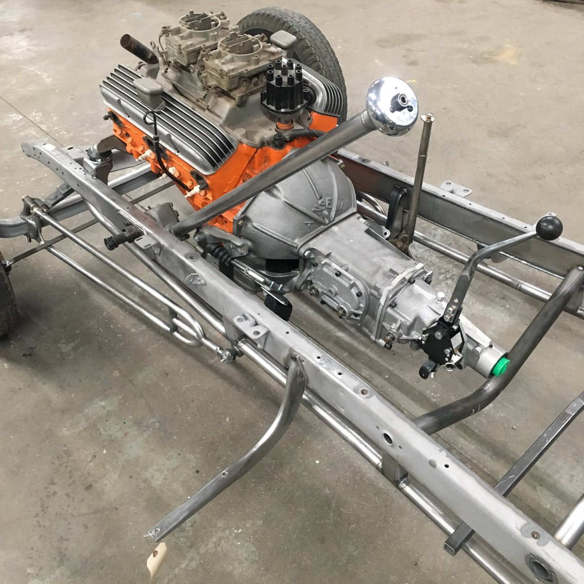

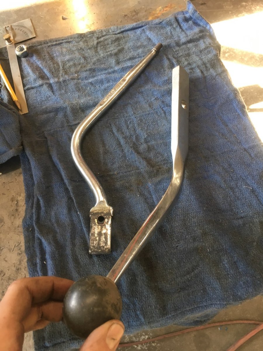

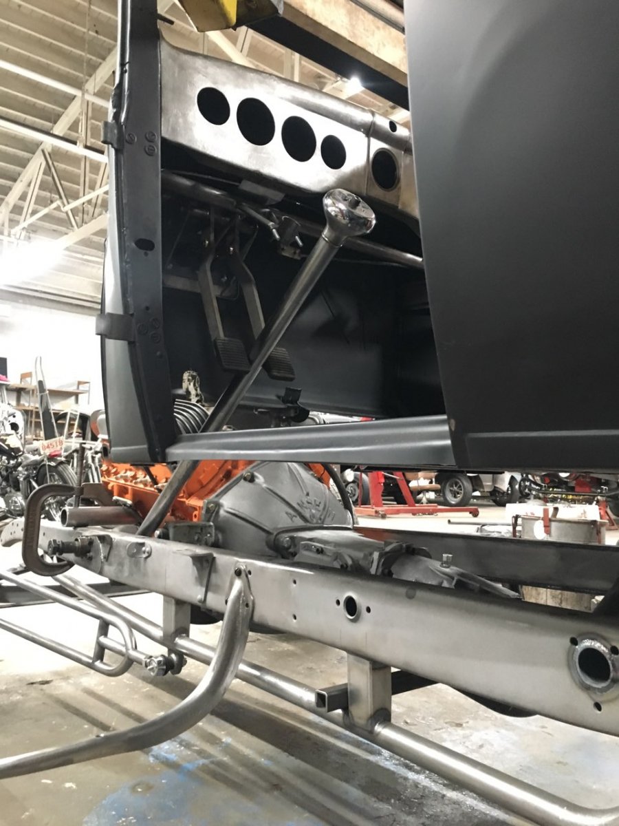

    Shifter Handle, Brake Handle, and tear down:

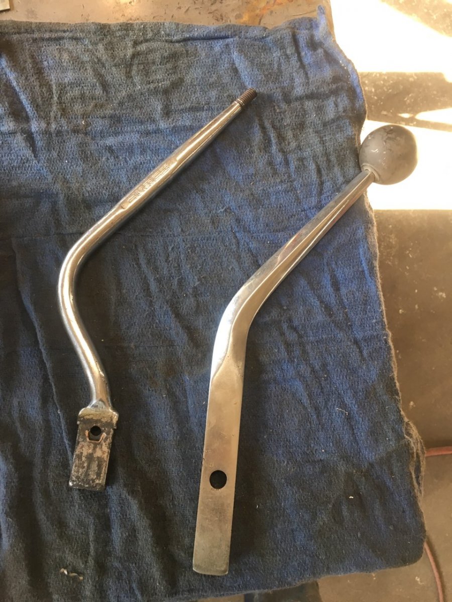

    The original plan was to modify one of the shifter handles I have hanging around my shop. However, Ryan had this diamond-shaped handle that never found it's way to the right project. it has a neat history about how he found it and the local shop that had it for decades.
    It will get modified to run in my coupe. What's cool is that I'll be running a Long shifter and it's a little sacrilegious to run a Hurst (what I was planning to run, because they just make so many of options). But, this one is unique in its shape and it fits the car's vibe.
    We're not sure what it's from, something early 60s... a Mopar maybe?
    There's enough stock to put a bend in it to locate it more toward the center of the trans. That'll help, so I can comfortably put my foot on the gas pedal and not have to bend my leg around a shifter.

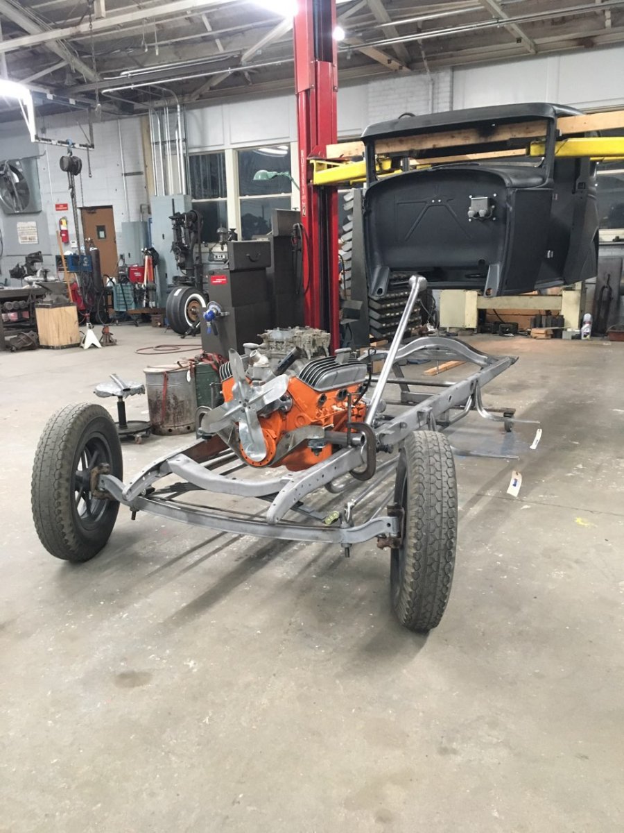

    Here are the shifter and the brake handle mounted. It's going to be a party inside this car, for sure. I'm probably not the only one who likes the look and feel of levers and functional mechanisms.
    Luckily, the brake handle landed in a good location and doesn't interfere with the dash bar. I was worried for a moment.

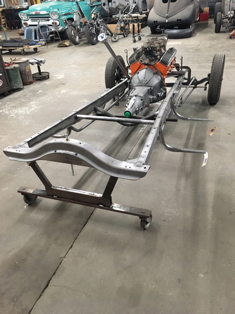

    Rather than risk any warping, it got broken down for some welding.
    Over the next week or so, there'll be a bunch of frame progress. We're getting closer.

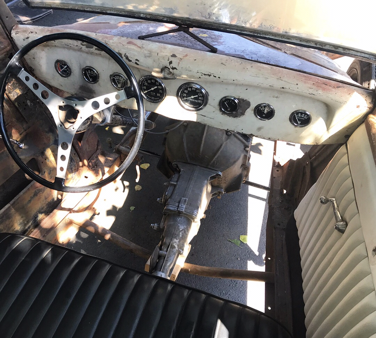

  28. I like that bell mount idea, I thought of something similar for my 34 5W, sort of the same build fashion... except mines a lot more shitty car. I also have that same Ansen blow proof bell for mine. This is mine very loosely mocked together, it’s currently getting a floor and firewall slapped back on it
    182D0C01-F455-4964-A5D1-6B051140261A.jpeg F46E2FDE-70B2-4621-8A02-F68AD6ECFEE2.jpeg
    1947knuck, enloe, BigO and 12 others like this.
