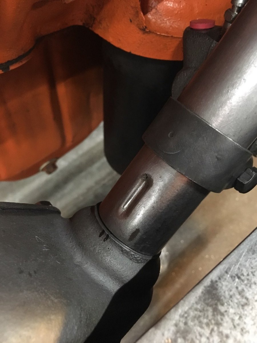

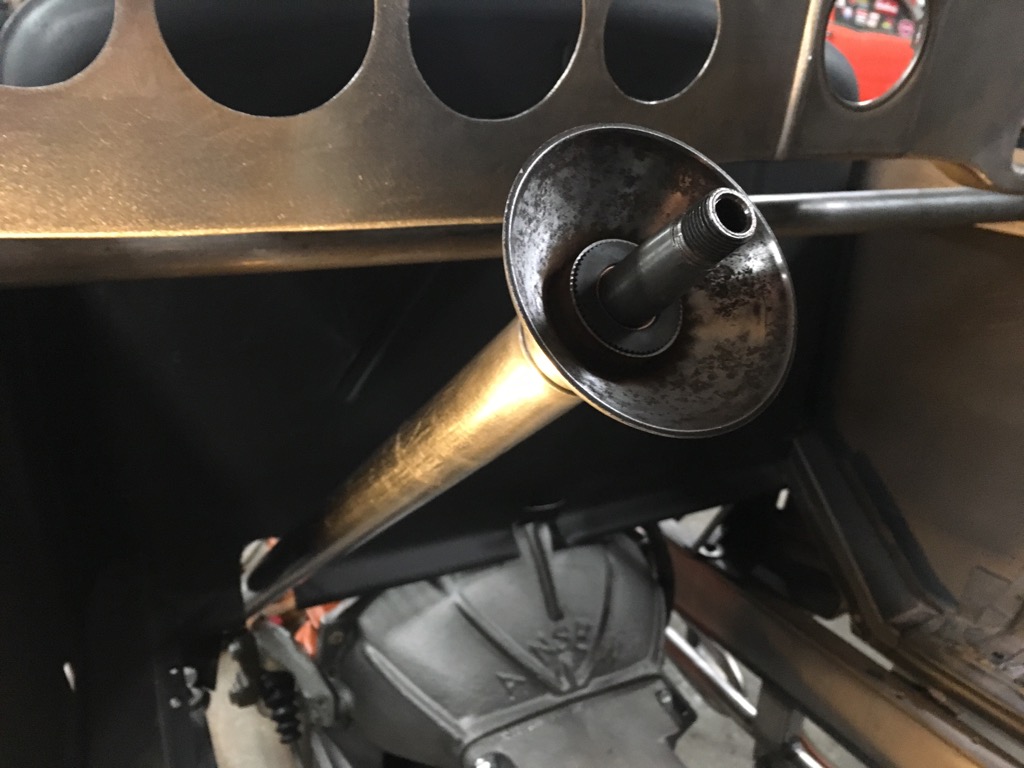

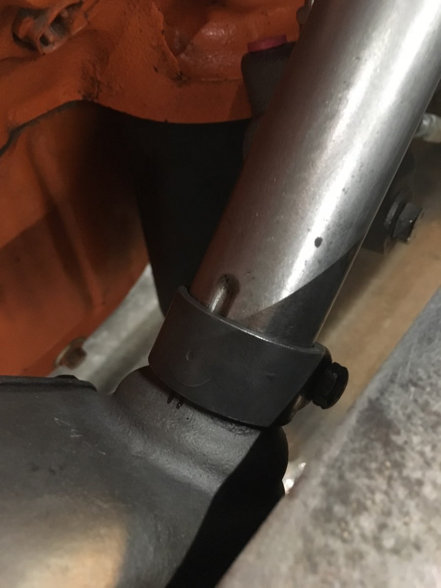

    Belled Column and Olds/Pontiac 3rd Member:
    The column needed to be shortened a smidge to allow fit the adapter cover. While at it, a few dents were pulled from the tube. Ryan went ahead and added a dimple to keep the tube in position.
    How it looks clamped.
    A new bushing was installed up top, too.
    Completed.

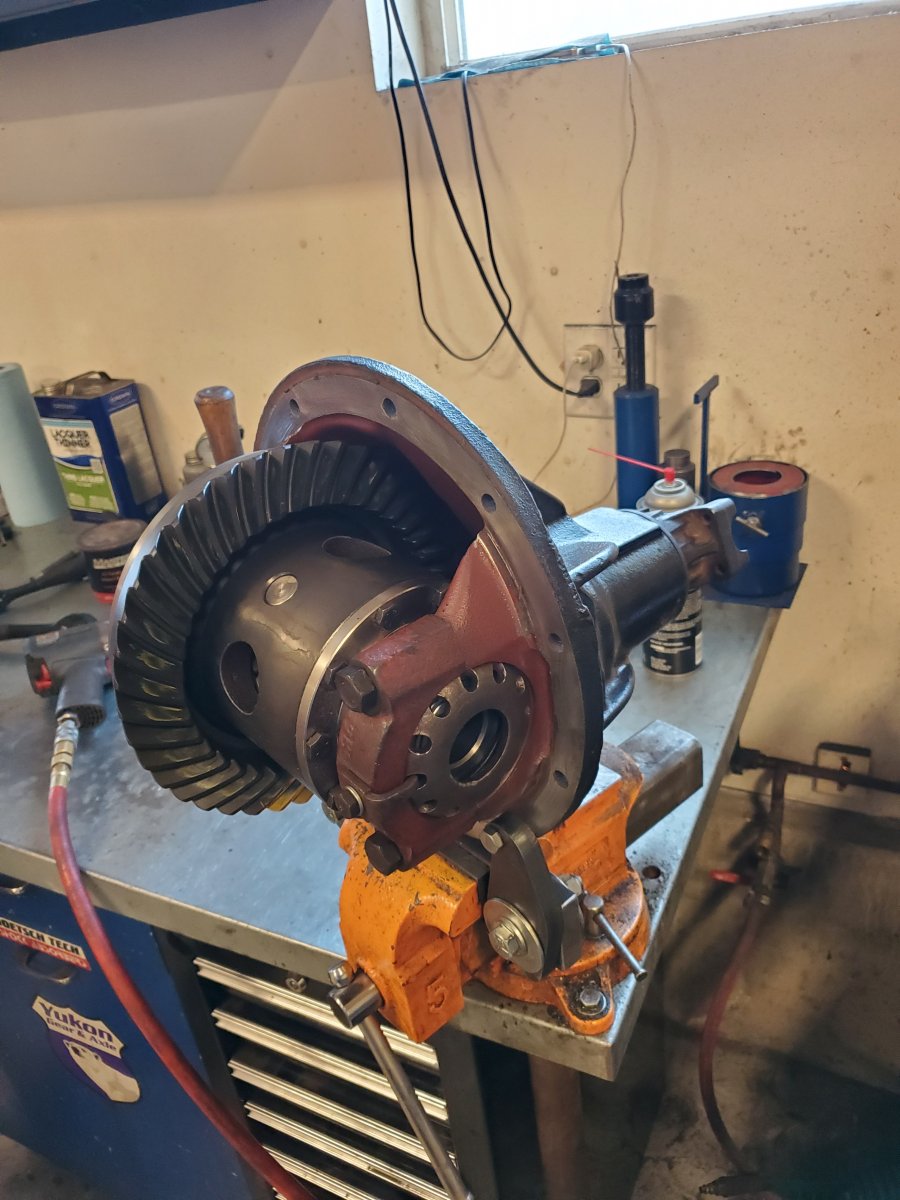

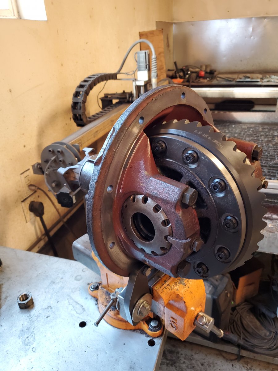

    In other news, I had a bunch of heavy parts sitting by the front door for a couple weeks. I'd been meaning to get them over to my pal who assembles 3rds and axles and plasma cut parts for a good portion of the offroad community out here.
    This was his first Pontiac/Olds 3rd. It was neat chatting with him about it as he sees a lot of heavy duty 3rds. We were one washer short, somehow, so he used a Toyota part. Seems fitting, I've been an OT Toyota guy a long time... and he's built OT Toy 3rds for me in the past.
    The details: The case was a spare that came out of a collection from a gentleman about an hour north of me who retired from racing. It was pristine. I held onto that a while and we loaded it up with 3.64 gears, posi, new everything (bearings, races, shims, ARP bolts.... yada yada yada), and a Toyota washer...
    I'll have some bigger updates, soon. Good stuff coming.

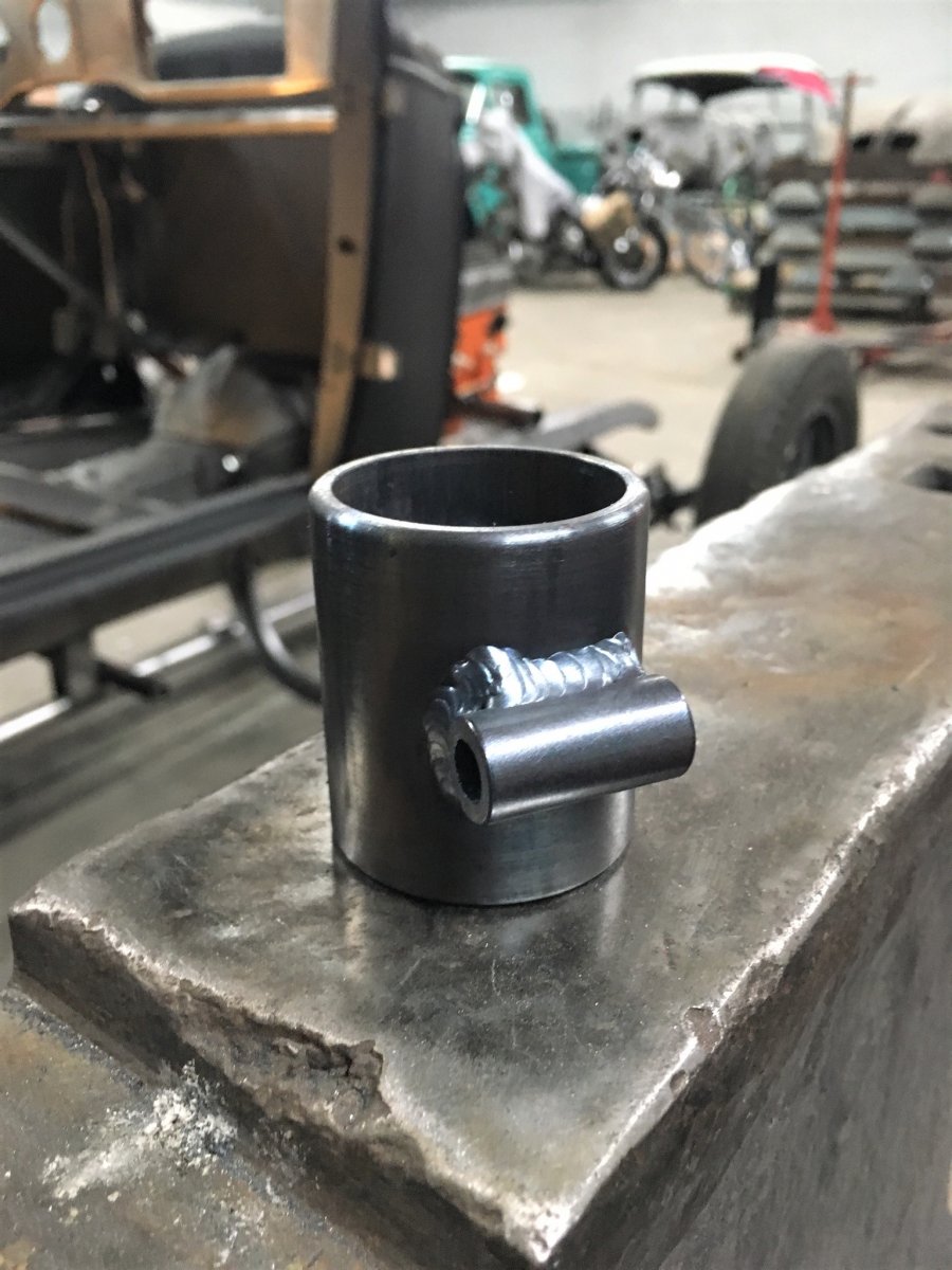

    Column Mount:
    Alright, back on topic.
    @Kiwi Kev posted these pics a decade ago and I've had them saved in my inspiration folder. Kev's work is honest, no BS. The plan for how we'd mount the column was directly inspired by Kevin.
    Here are a couple pics of the column mount from Kev's Nasty Habit Willys build:
    Simple, to the point and great looking.
    Here's our variation on the same theme:
    The finished piece, below.
    We've added so much to the car that we're being conscious about material weight. So, instead of solid bar, here, we used tubing.

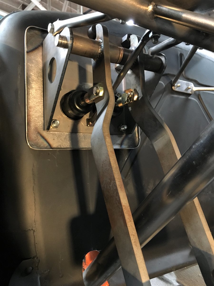

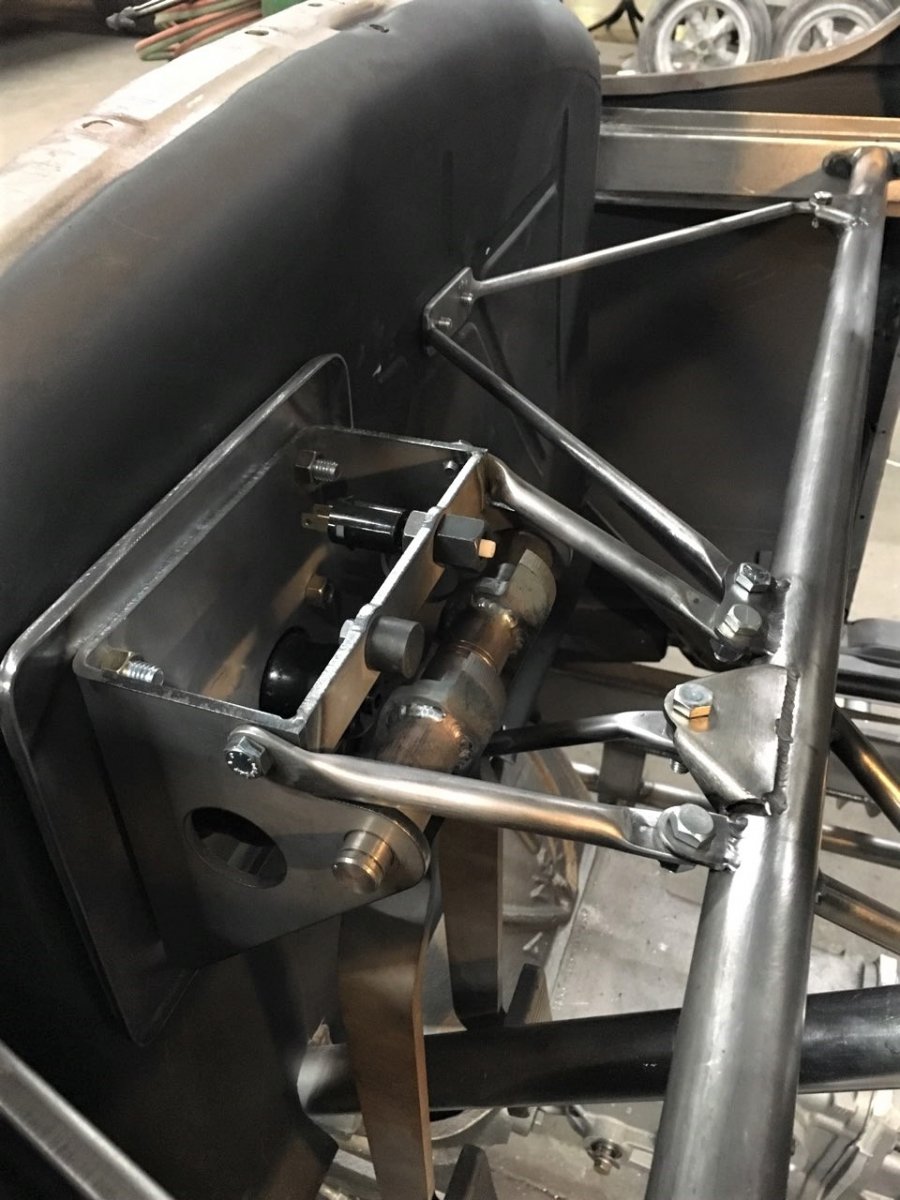

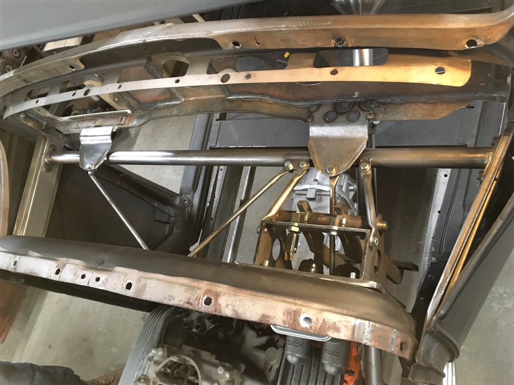

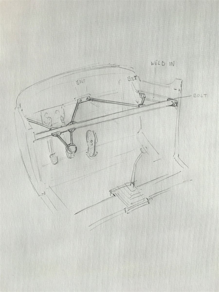

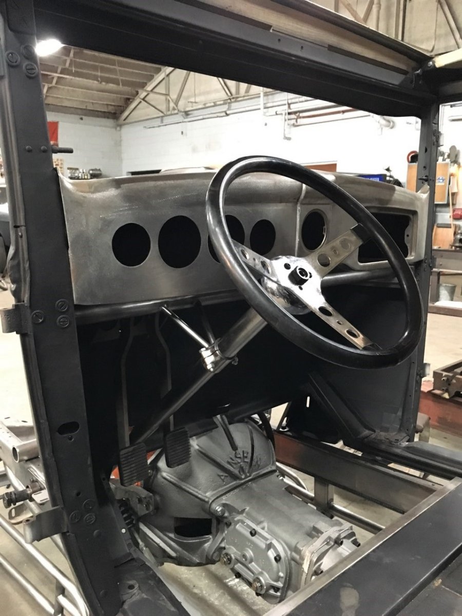

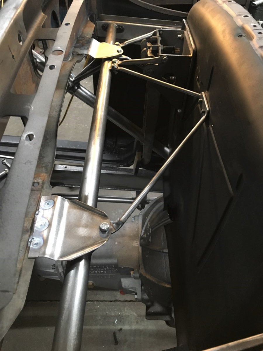

    Model A with 1935/36 Dash, Hanging Pedals, and Reversed Firewall - Reinforcement:
    Just to refresh, here's the original, jotted idea. We diverted a bit as you'll see.

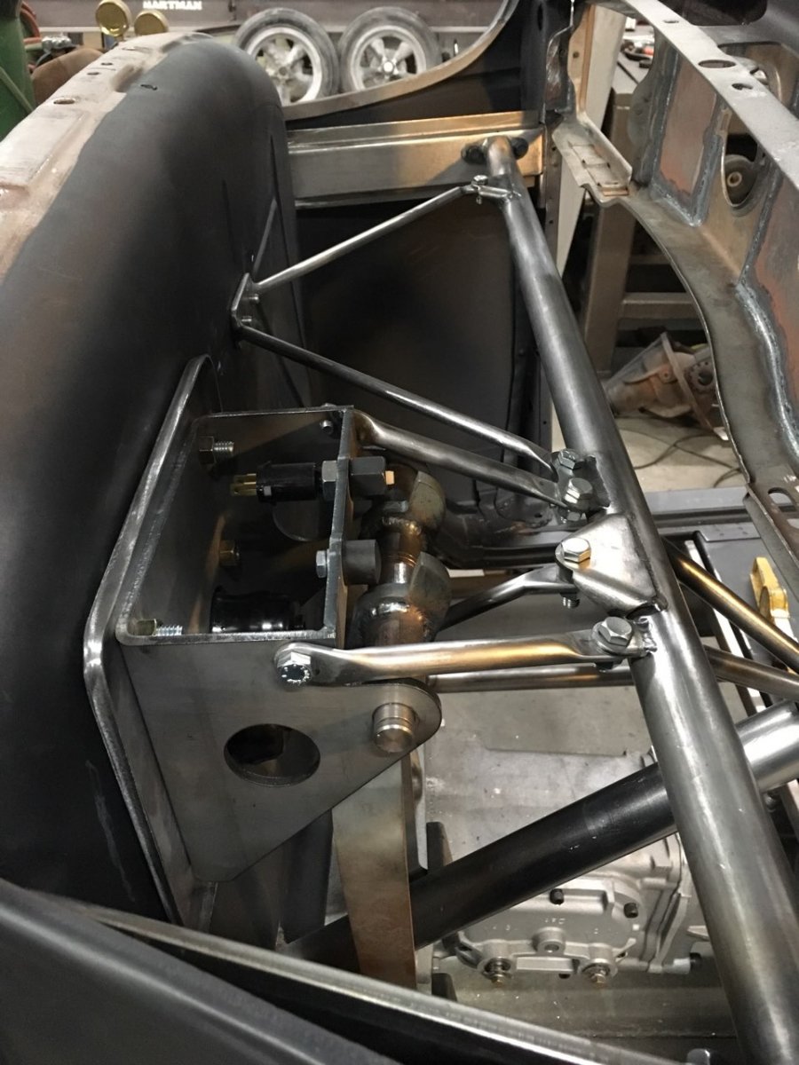

    It's not fully done but it's a lot closer. The dash brackets aren't installed. We decided not to run bars out to the cowl. We did, however run them to the hanging pedals, which was in the plan but not in the drawing.
    There's a 14g reinforcement piece between the firewall and pedals. It will be welded. I wanted something that made that surface around the pedals more substantial. We didn't go overkill and you can see, some shape was put into the piece to add some rigidity.

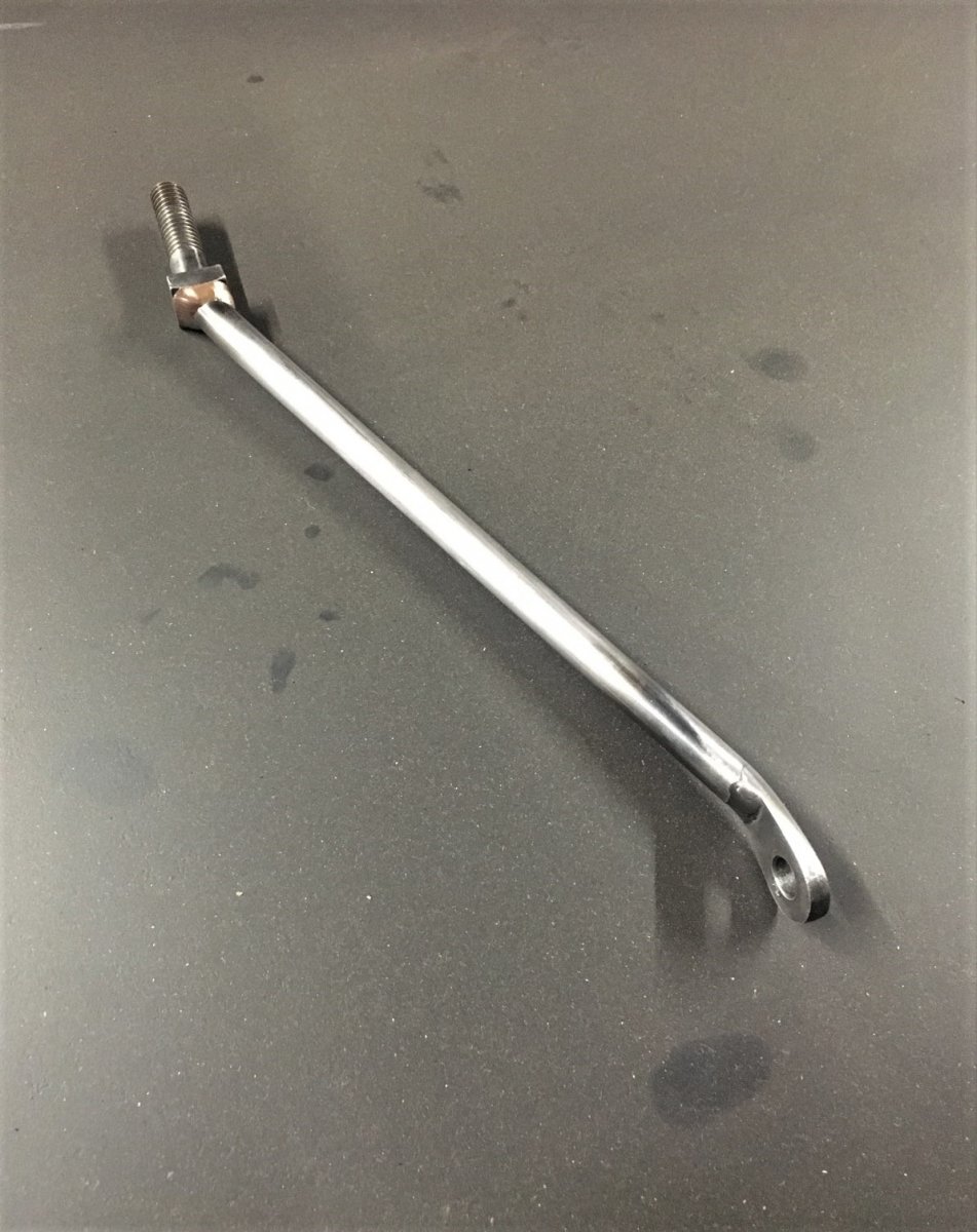

    The pedal bracketry is 1/2" tube that was forged at the the ends on the anvil. There were holes drilled and tapped in the pedal assembly frame for the rods to bolt to.
    The middle pedal/master cylinder reinforcement rod uses a mounting bolt (the lower bolt on the Chevy truck master) at the base and it ties into the top like the rest.
    Other than these pics, nobody will see these details. More than anything, I wanted to be able to drive the car hard, without worry. I want the firewall to be able to hold up to the stress/force that's transmitted from the hanging pedals. This Lucky's pedal assembly is WAY more stout than the Ansen unit their style derives from. I've seen plenty of Ansens or copies with cracks or broken tabs and a few cracked firewalls, too. So, we did what we thought could help prevent that.

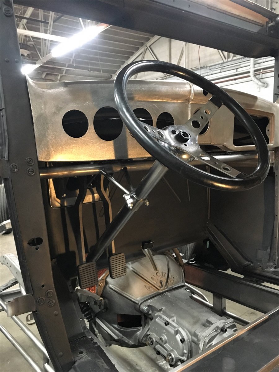

    Connecting the 1935/36 Ford Dashboard to the Dash Bar:
    The 35/36 dash is now fastened in the coupe in 2 additional spots. It's mounted in the stock Model A locations on the sides, on the top rail, and now on the dash bar.
    The tabs were formed from 16ga.

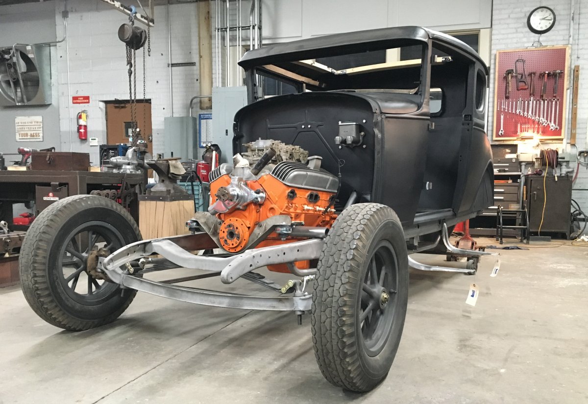

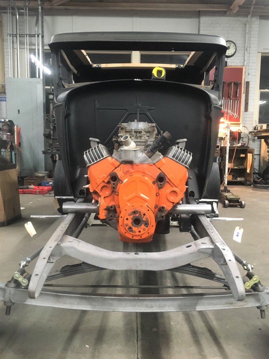

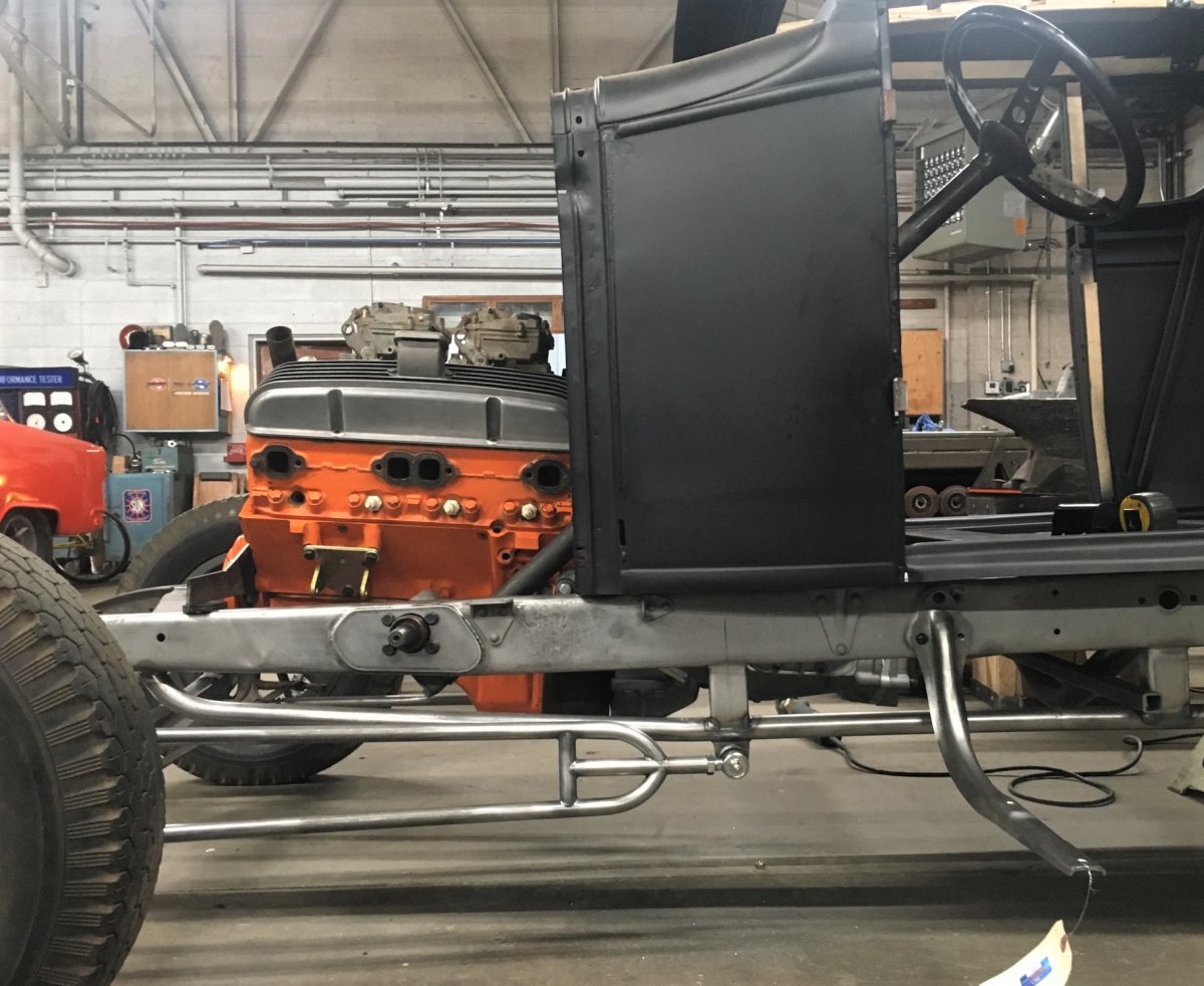

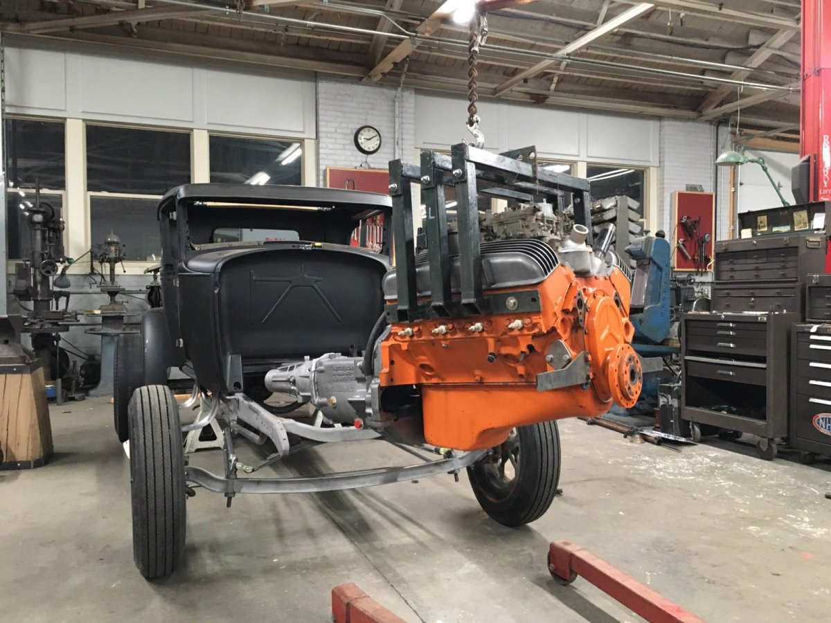

    Mocking the 327 SBC placement/Height in a Model A Frame:

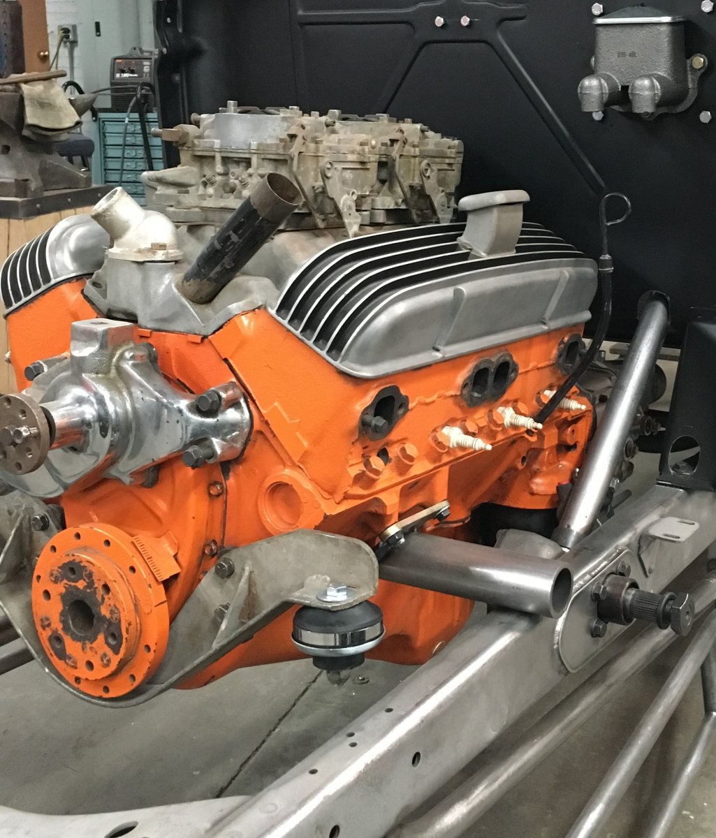

    I'll be using an old Hurst front mount in front of the 327. Not only do we need to figure the frame-side mounts but we also need to mock the engine height. Here's how it was done on the coupe.
    The Hurst mount was pulled off in favor of some flat steel mock-up mounts that Ryan uses to place small blocks.
    They're wide enough to span the rails. They make getting things centered and to an exact height without much hassle.

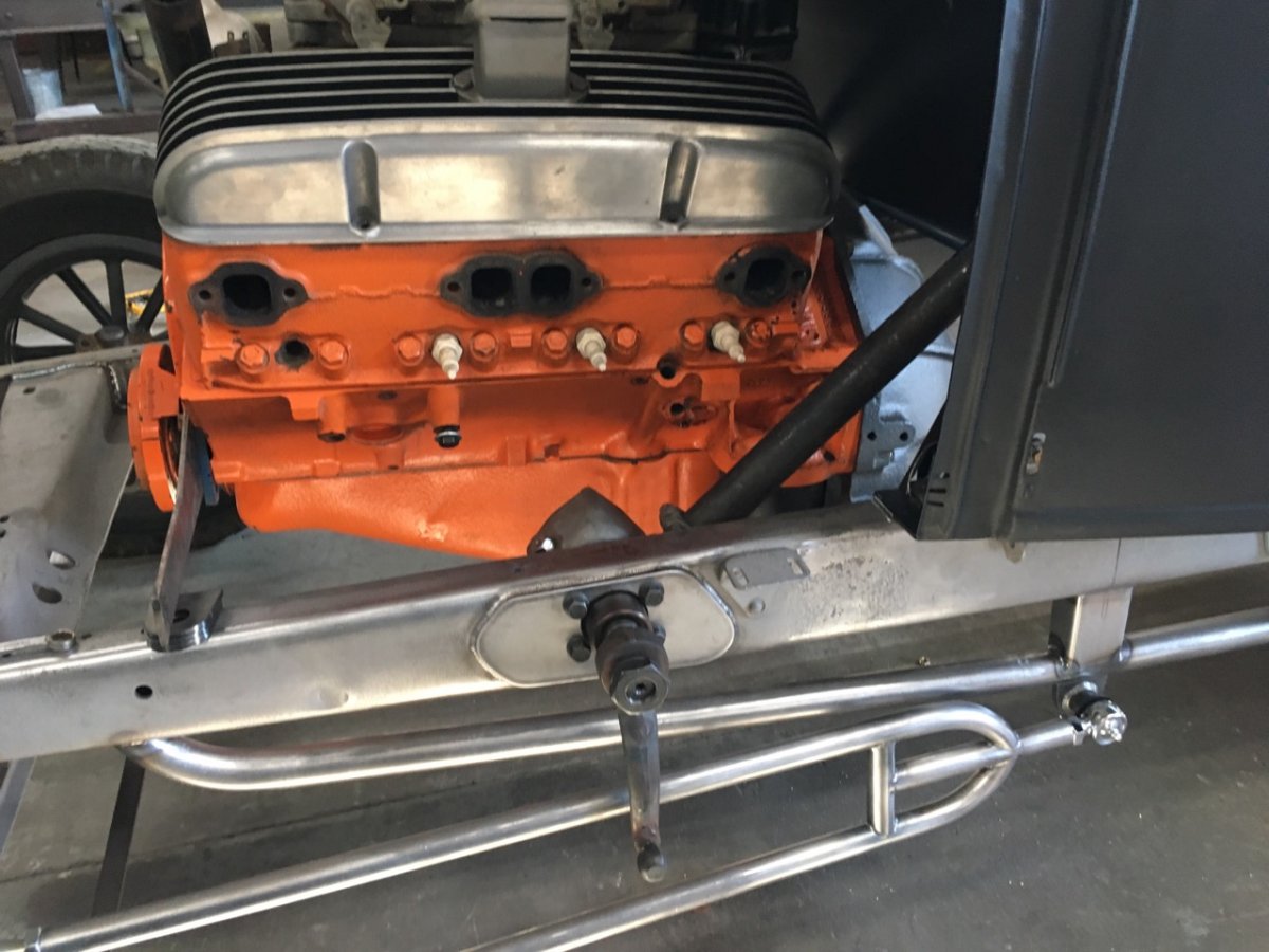

    Once we got the height and setback, Ryan pulled out a donor set of generic side mounts and welded some tubing that will allow the engine to sit in place.
    Now, the front plates can be pulled and the engine mounts can be fabricated... with plenty of space to work.
    And if the transmission needs to move up or down, it's simple.

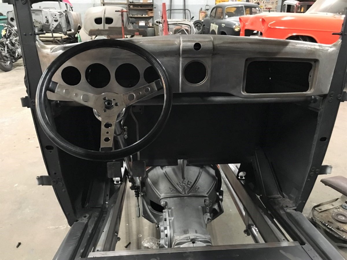

    Since we talked about it a bit, here is the pedal location. This will allow my heel to sit on the floor and the ball of my foot on the pedals.
    Hanging Pedals With Push Rods Installed.jpg Ryan took some new pics of the finished dash bar and reinforcements (and I cleaned up the pics further) but it's all stuff we've already seen. I'll wait to post up some new work when we get there.
