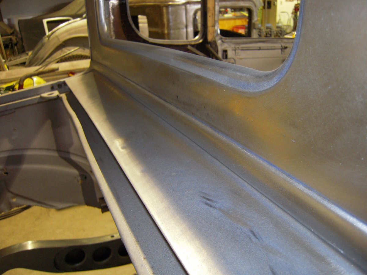

    Understanding that life is too short to not get EXACTLY what I want out of life, I changed directions.
    All that said, here we go.

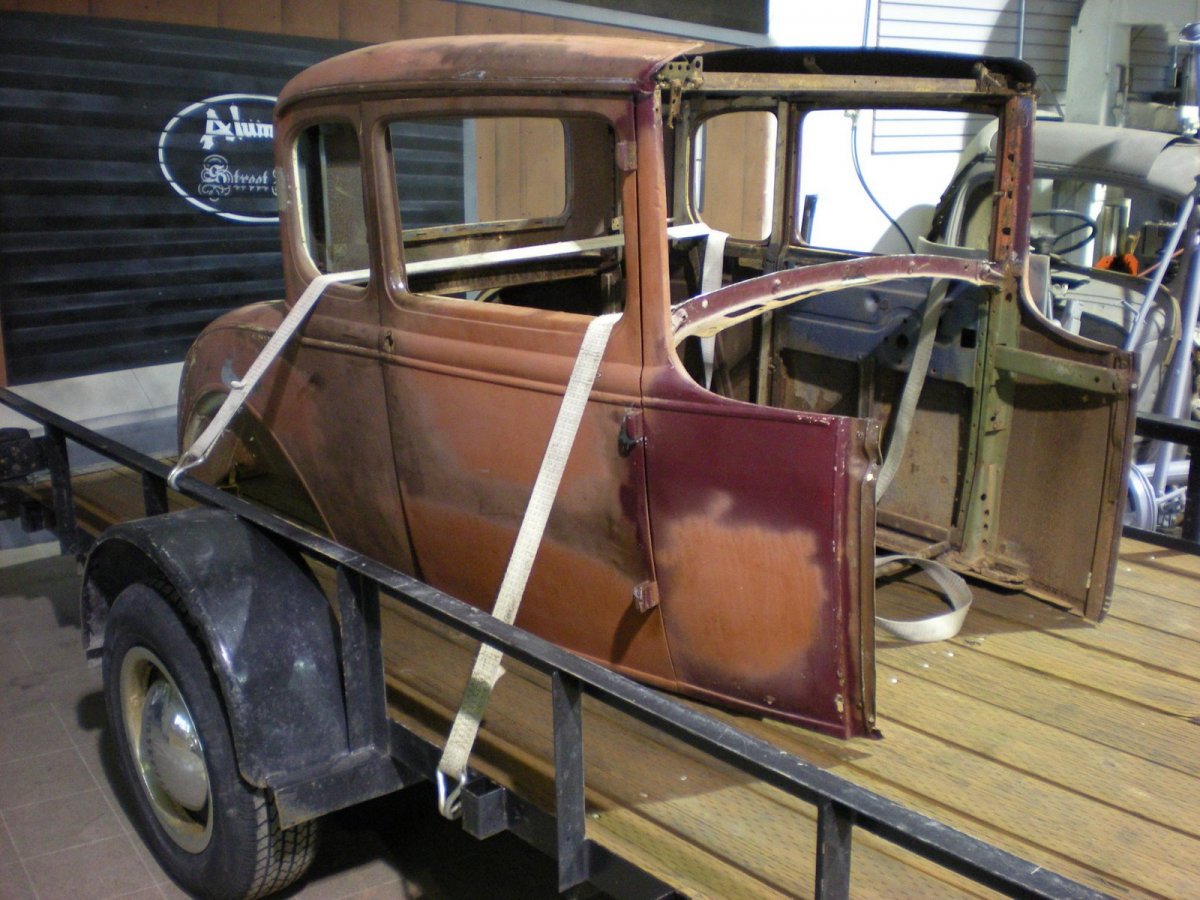

    I picked the car up in Adiar, Oklahoma from HAMBer @coopsdaddy. I didn't have all that much money back then. I had moved to Utah from the northeast and I was saving for a wedding ring. My girlfriend (whose now my wife) had just gotten back from a month in China. She slept all the way there, through picking the body up and having a beer after we loaded it, and nearly all the way back. Haha.

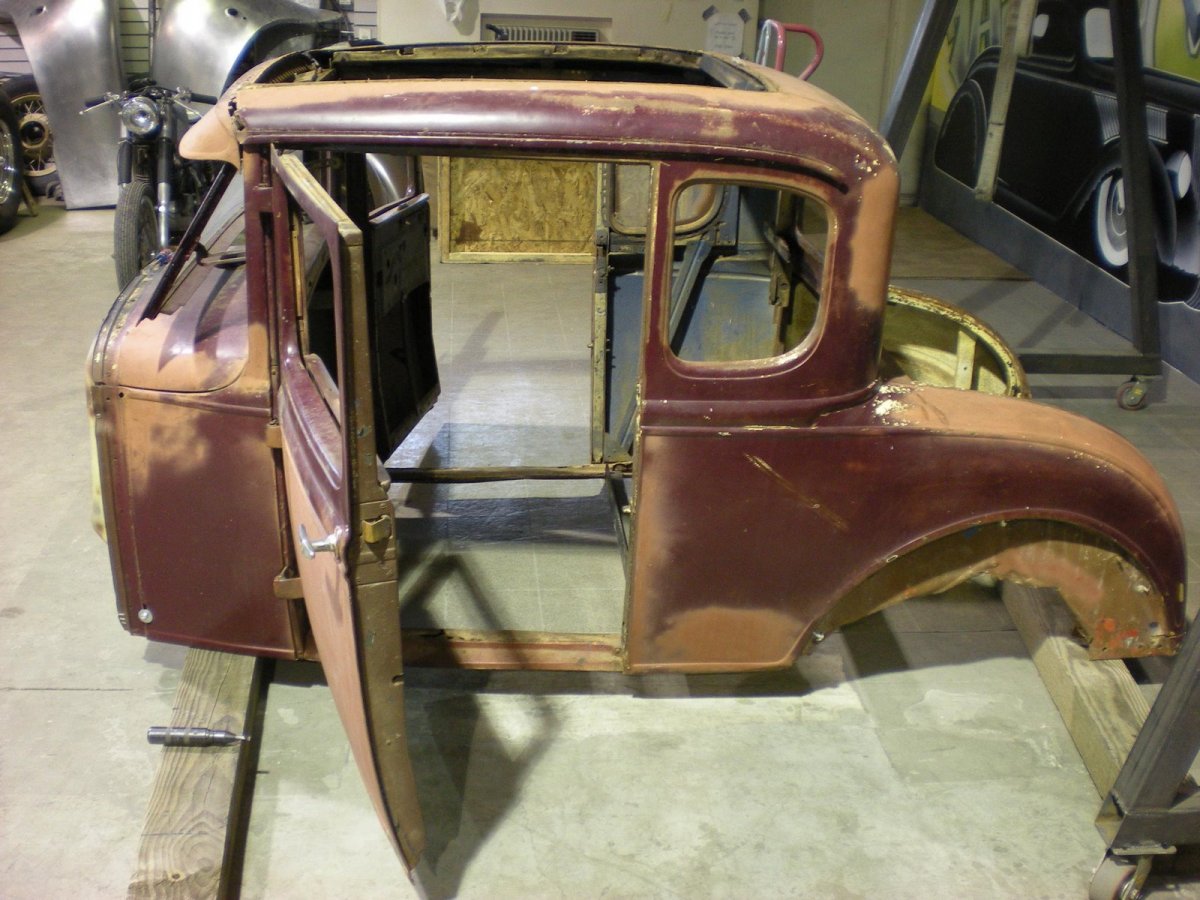

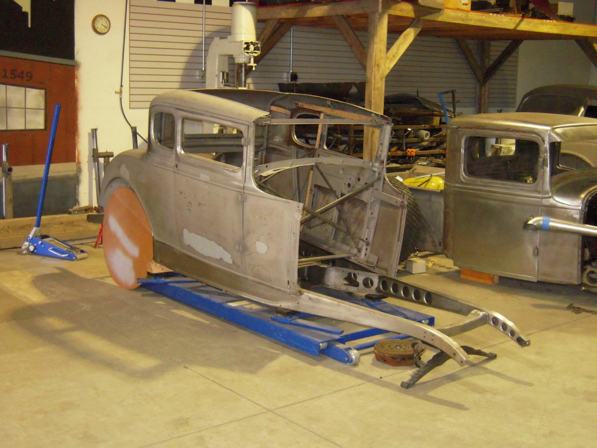

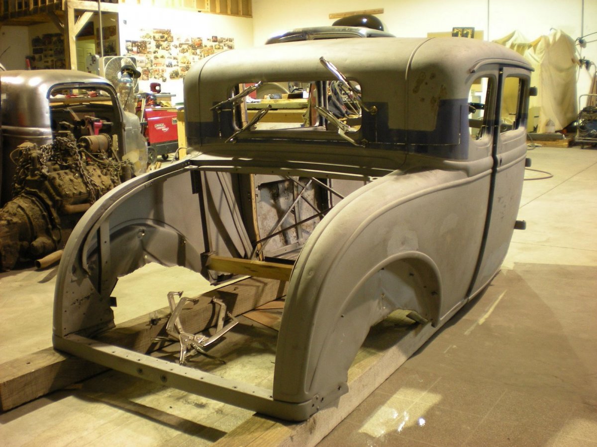

    Shortly after the car was in Salt Lake, it ended up at Chris Davenport's shop (Salt Flats Speed Shop). It was torn down and blasted.

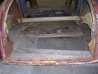

    Based one what I can tell about the car, it must have been a circle track car or a low budget hot rod. It was crudely channeled and there was evidence that a sheetmetal roof insert was screwed to the roof.

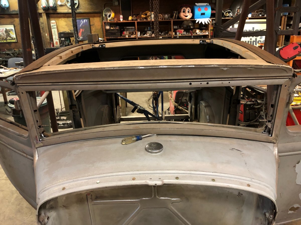

    -Brent-

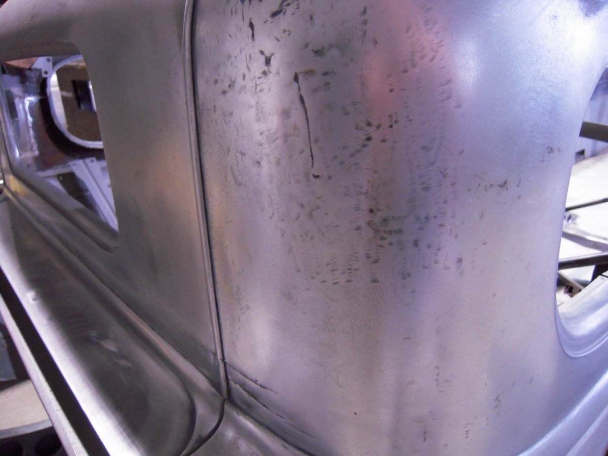

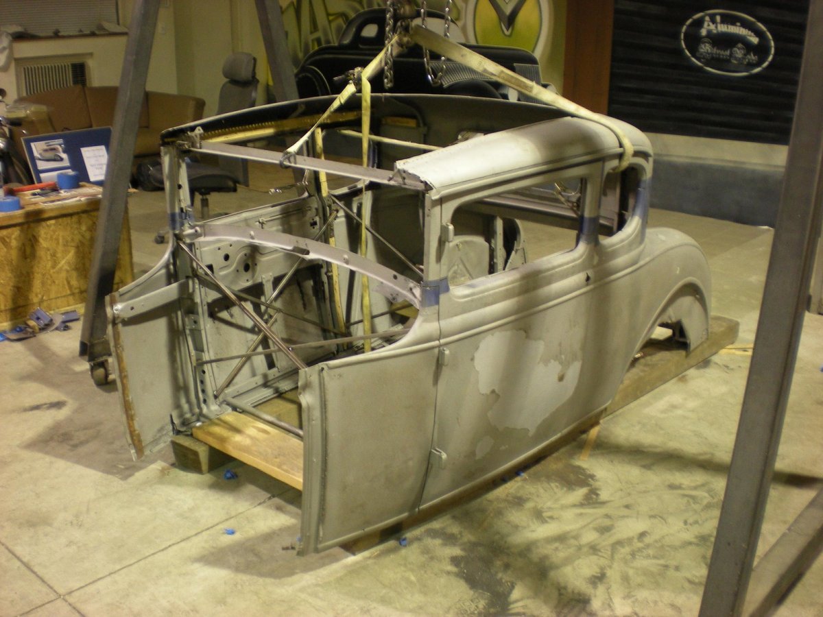

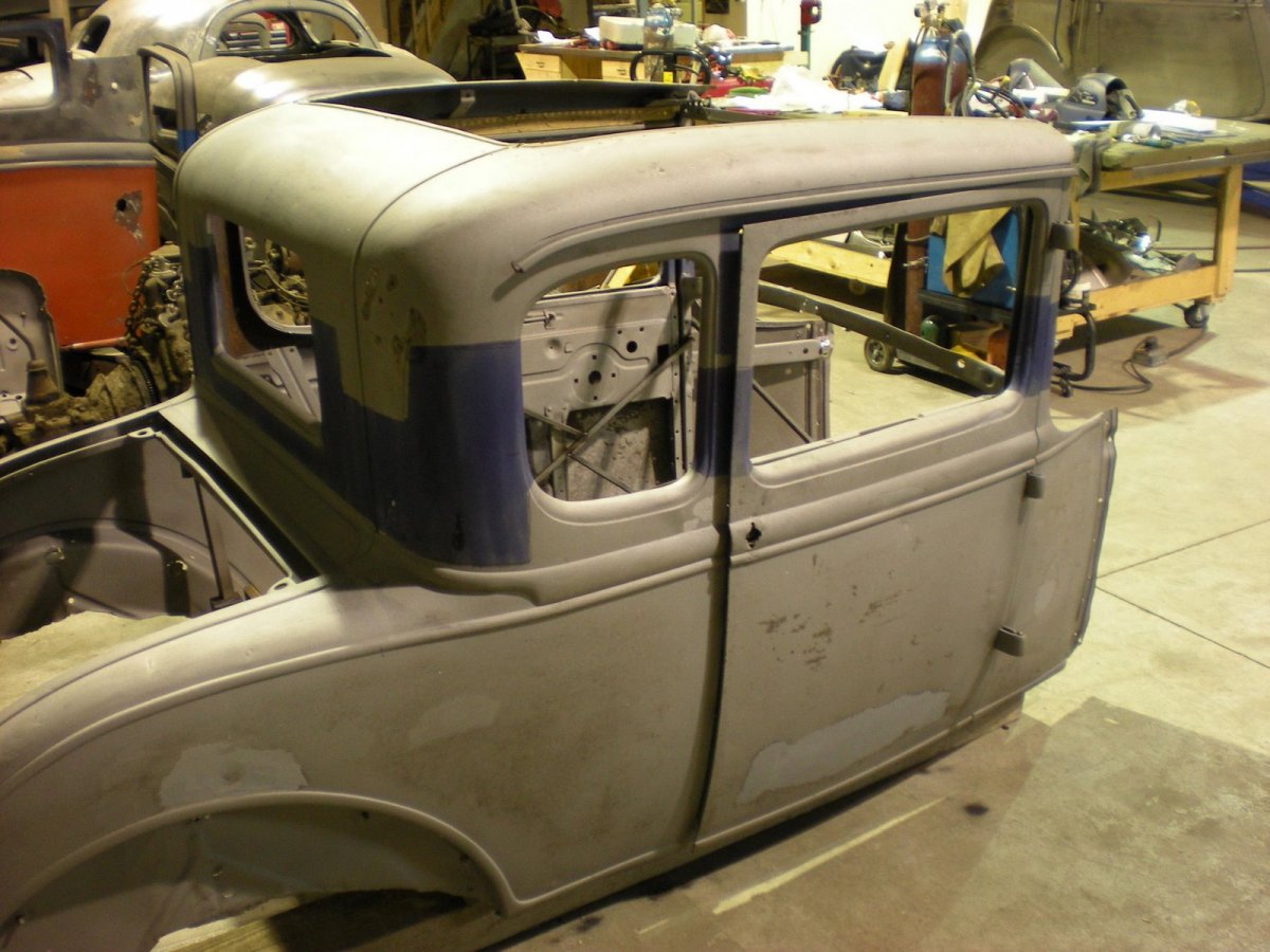

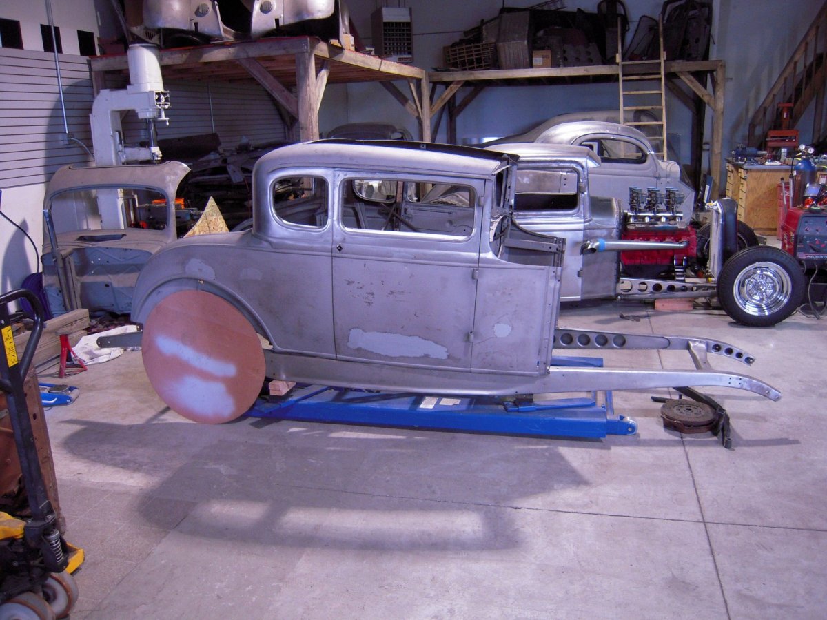

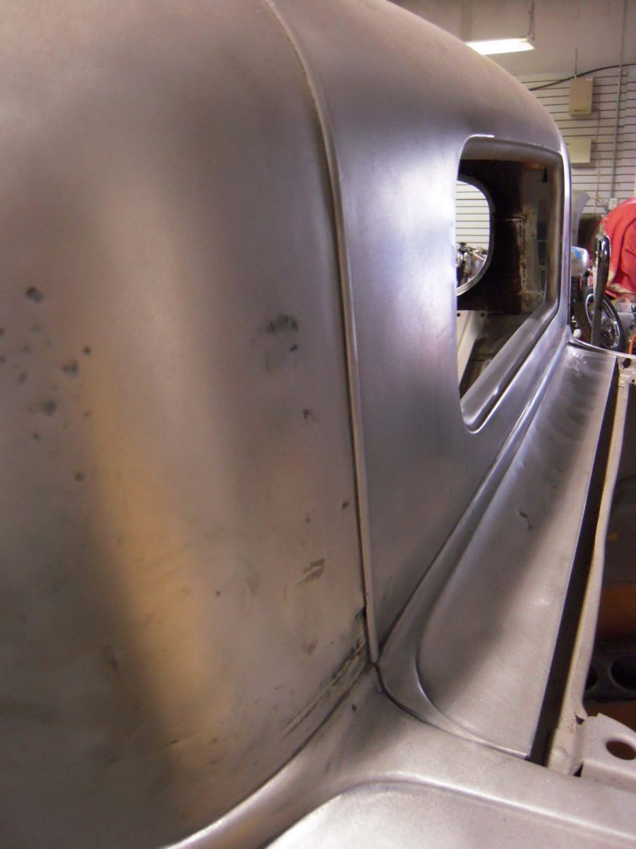

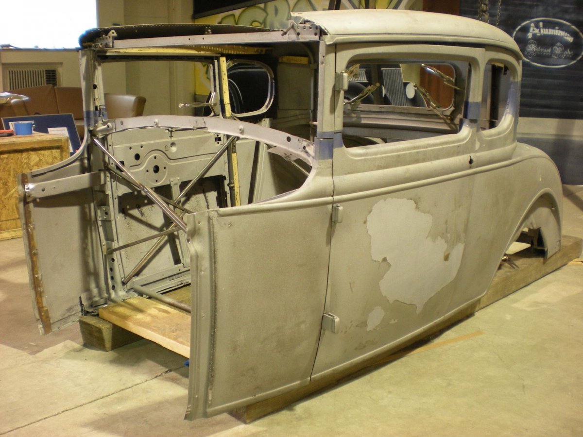

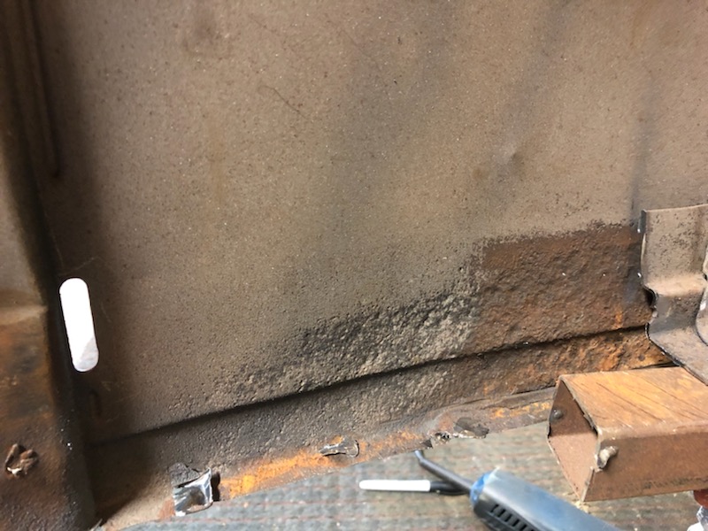

    When it came back from blasting it was a little better than I expected but it was still pretty rough. It needed complete subrails, patches, and a bunch of misc. work... but we were young and not experienced - so of course we did the chop first. HAHAHA.

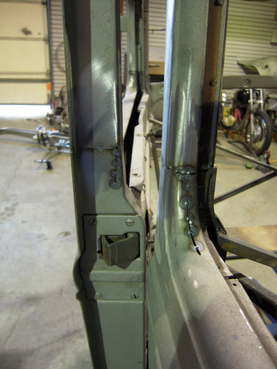

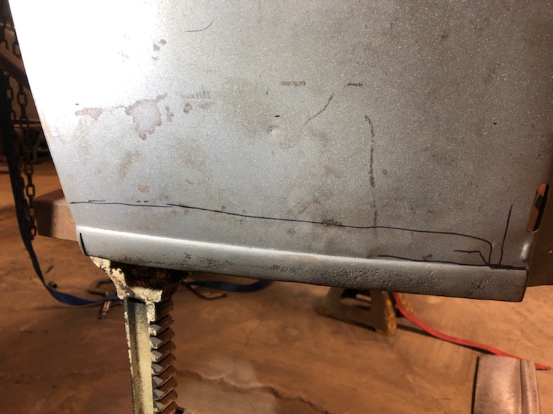

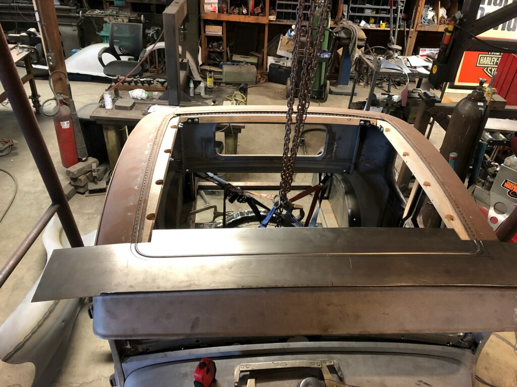

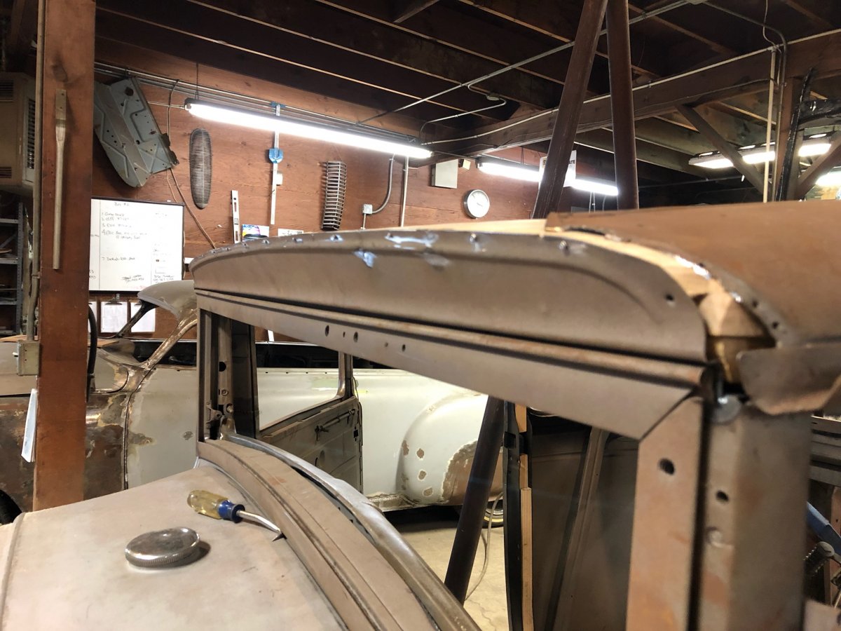

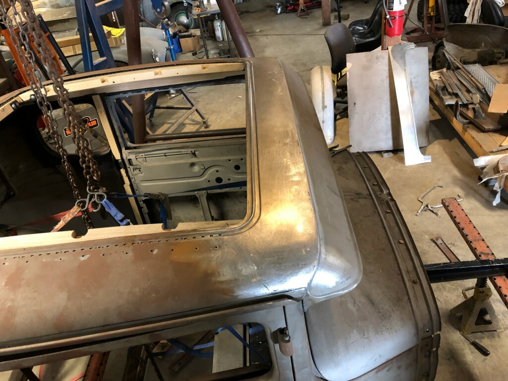

    Prepping for the chop.
    Laid out to take 4" from the height and 3" out of the rear window. These are choices I'm glad I made back then.

    Model A 4" Chop
    I'm sure I have more pics from way back saved somewhere and if I find them, I'll include them. Here are some of the detail pics of the chop.
    This was what I was going for, back then.
    One of my favorite pics from those days.

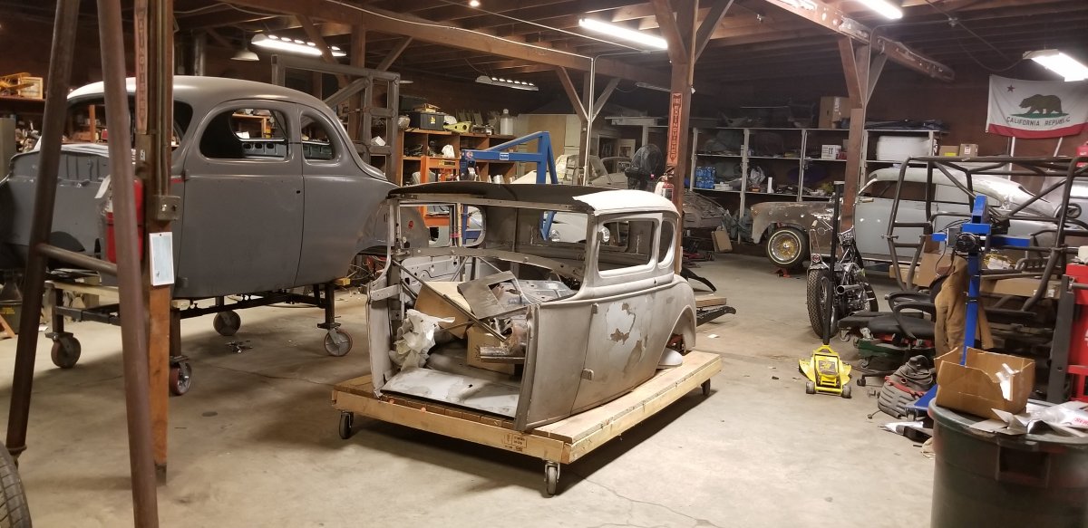

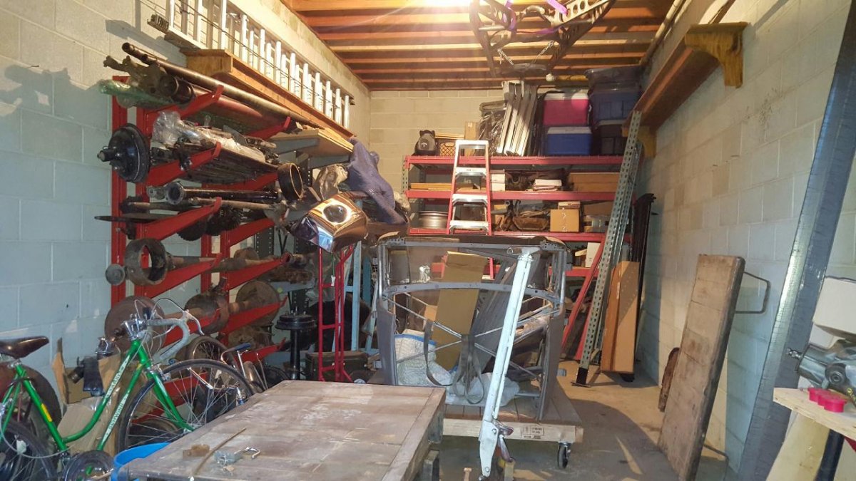

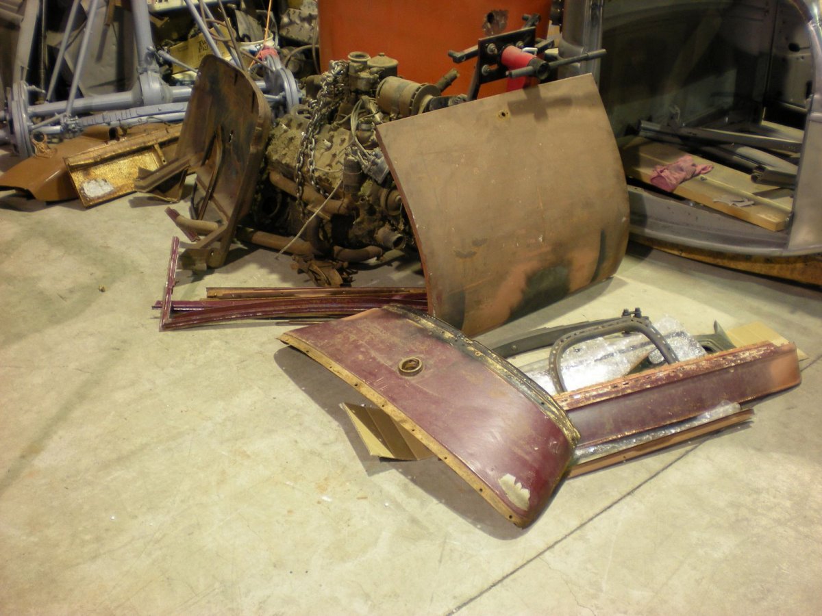

    Then... the car sat.
    This is when I put it in my garage, when it was just a couple light bulbs and an outlet. Couldn't really get any work done. So it sat, stored. It had already sat a while in a storage unit... kind-of in the same configuration.

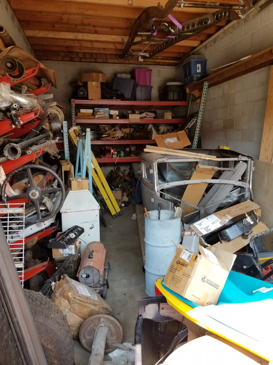

    Then, I remodeled my shop and moved the car to storage. This was about as good as it ever looked.
    It kept getting more and more packed... it got pretty bad. I need to find a pic at its worst! I was overwhelmed.

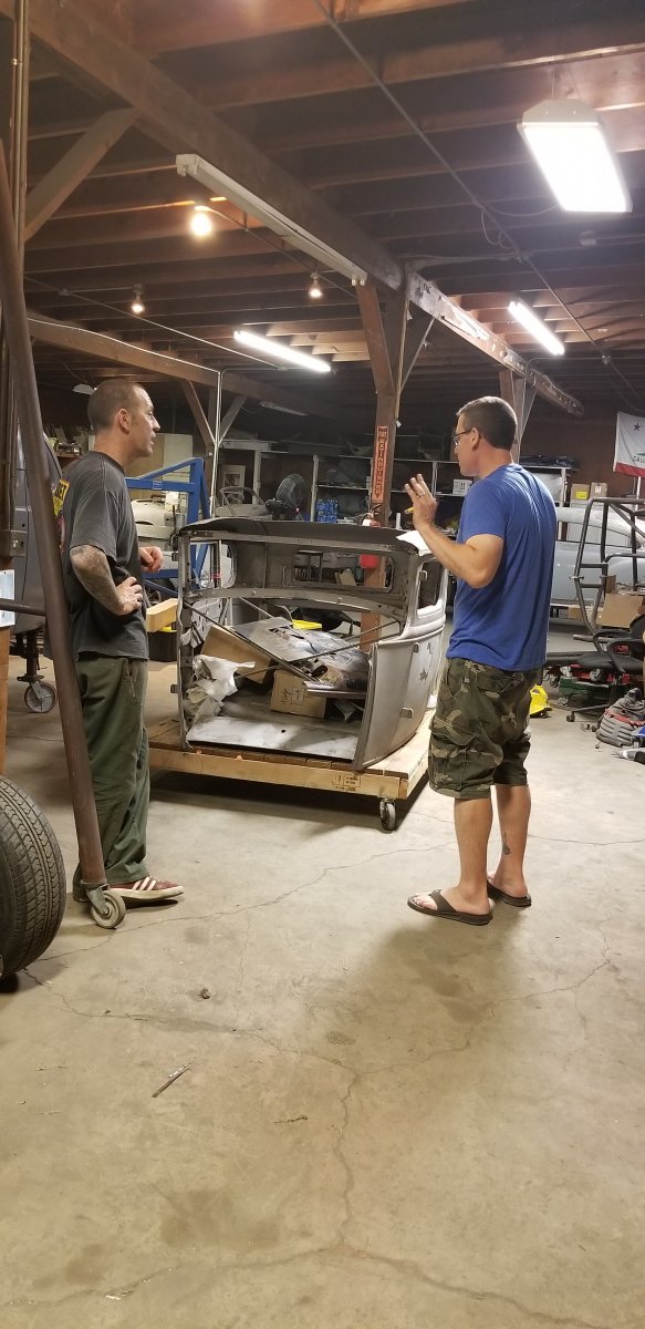

    When the choice was made to get some help with the car (let's be honest, the car wouldn't get done with the skills I have), I had a short list of people whom I shared the same vision with. On the top of that list was Matt Seret. I just plain old like Matt.
    A plus is that he completely got what I was looking to do with the car. He likes the era and he's one hell of a fabricator. He's also in Vallejo, California! I'm not one to shy away from a road trip (this car's frame comes out of Colorado and the fenders came out of Big Bear Lake, CA.), so I packed up the car and the family and we headed west.
    This is the first time it had been outside in years. It had some new dings and dents from sitting, getting moved and then getting junk piled on it, repeatedly.
    IMG_20180809_141730_037.jpg 20180809_195111.jpg 20180809_195122.jpg 20180809_203924.jpg
    Packed and ready to go.
    After a long trip on I80 west and 200 stops to use the bathroom... we arrived in Vallejo.

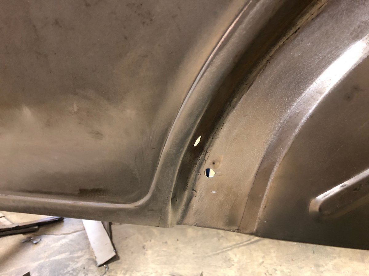

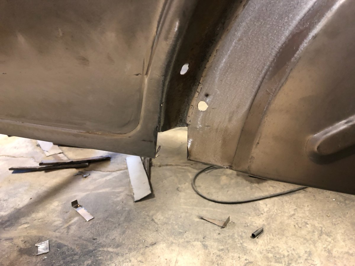

    Wheel well patch/replacement - Seret Style
    Here's the before:
    Matt scribed a line where the patch panel will sit.
    Notice there are issues beyond the perimeter of the panel. Those need to get fixed first.
    Patches inserted.
    Now the scribed line can be cut.
    Panel nearly done.

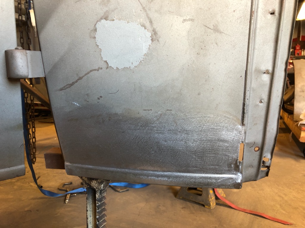

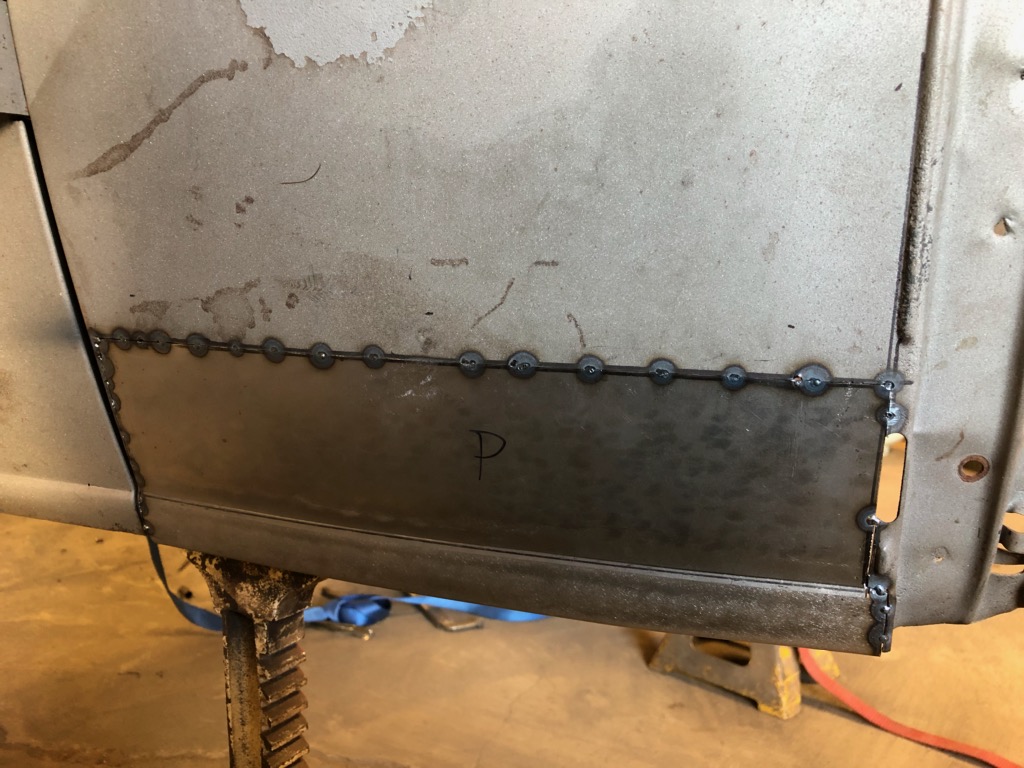

    The whole bottom of the car was replaced. I didn't buy and repop side patch panels. Matt hand made them all with 18ga.

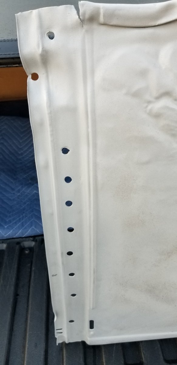

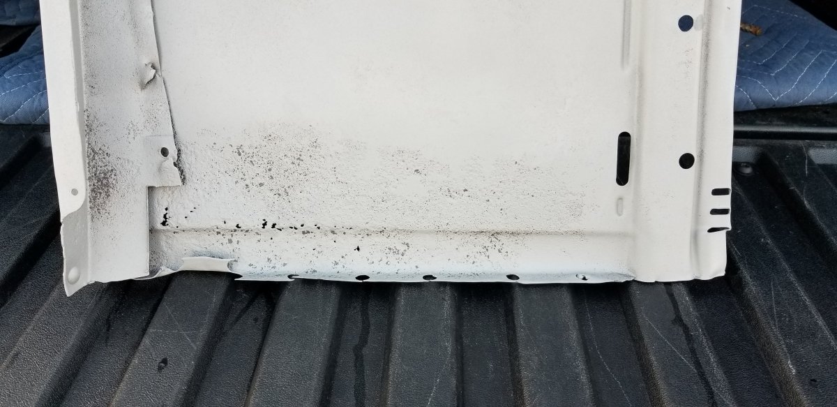

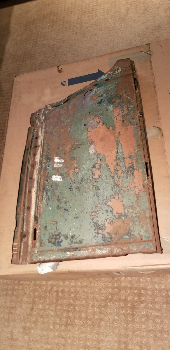

    Driver's Side Cowl Repair - A Bit More In-Depth

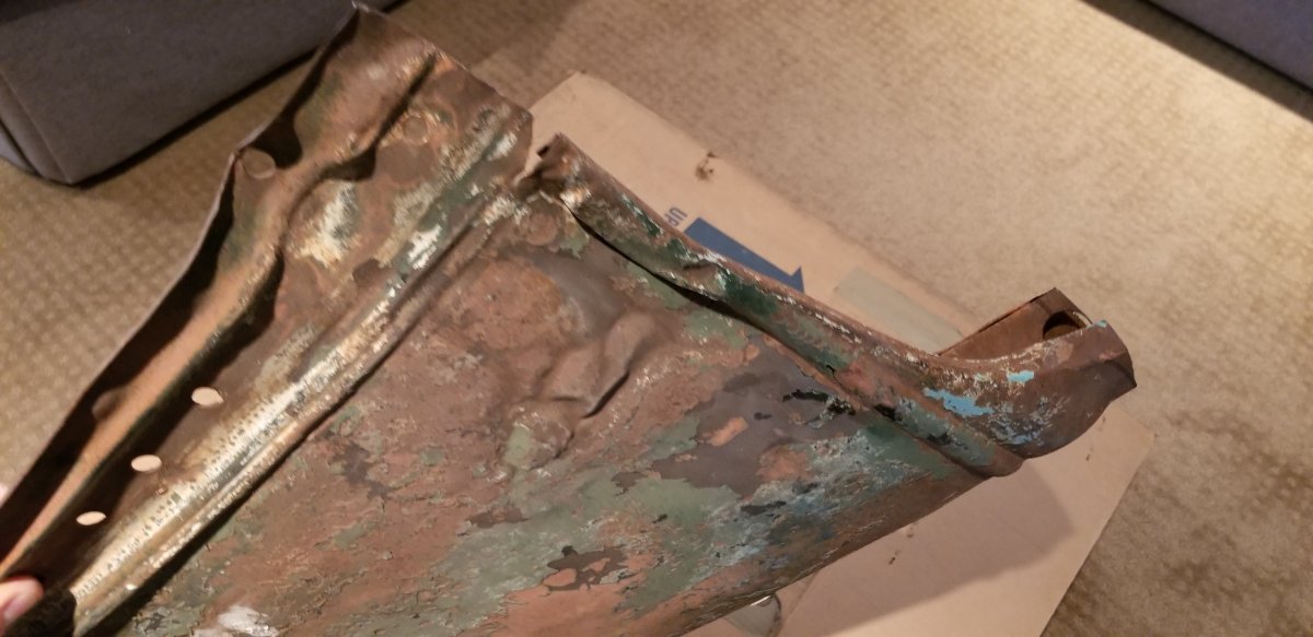

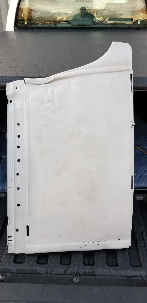

    The driver's side cowl was in rougher shape than the passenger side. I looked for a decent cowl that was affordable and within a decent driving distance but I struck out or was a fifteen minutes behind a buyer (on two occasions).
    Matt fabbed a lower patch and waited for my patch.
    Not having any luck, I put a request out to a Facebook group and a gentleman out of TX had one that was a great deal. Obviously, though, it needed some TLC first.
    She was a little wrinkly but I though we could make it work. If not, I'd keep searching in hopes I didn't have to drive a state away to grab one.
    In a rush, I brought the piece down to a shop where I get some powder coating done. They handled my rush request and after blasting it looked like there was enough to make it work.
    That night I marked a straight line and trimmed it.
    It fit perfectly in my carry-on bag when I went out to visit Matt and the car and do the body wood.
    The pitting on the top wasn't nearly as bad as the rest. The body guys can neaten that up.

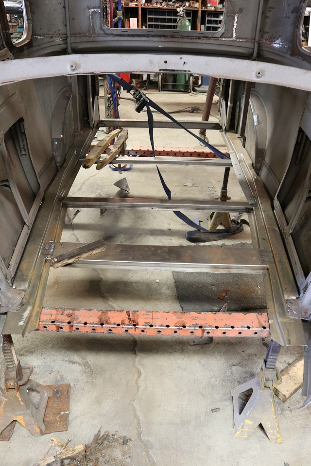

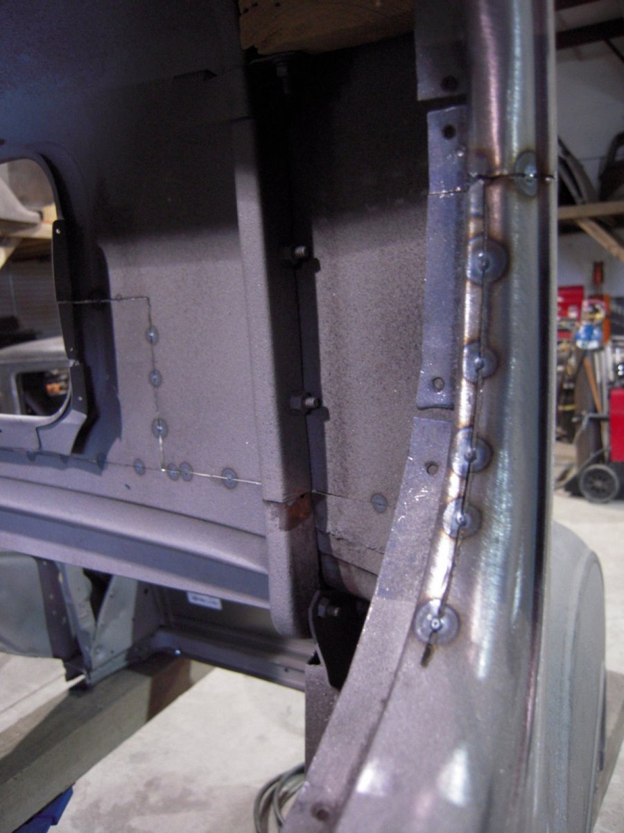

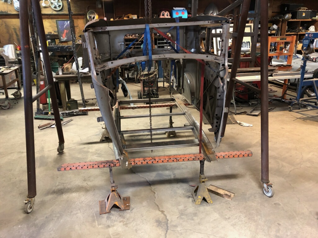

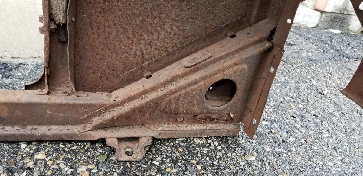

    Model A Subrail Installation

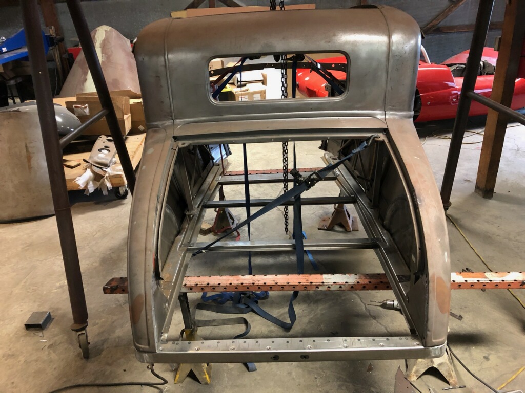

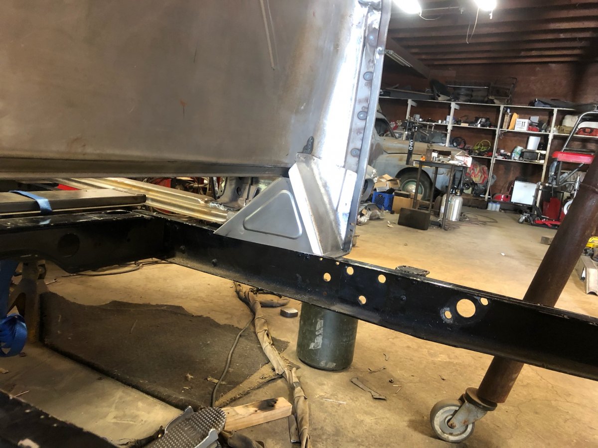

    On the morning of the subrail install we found out that the Internet doesn't have all the right answers. There's not a whole lot of subrail dimensional information on the web and some of it that we'd referenced was wrong.
    So it took a couple hours of the two of us working at it to figure it out.
    The next day, a pal had all the pertinent information in an old restorers book of his. Turns out, the Internet doesn't have ALL the answers. Hahaha.
    Here's a good look of the install, completed:

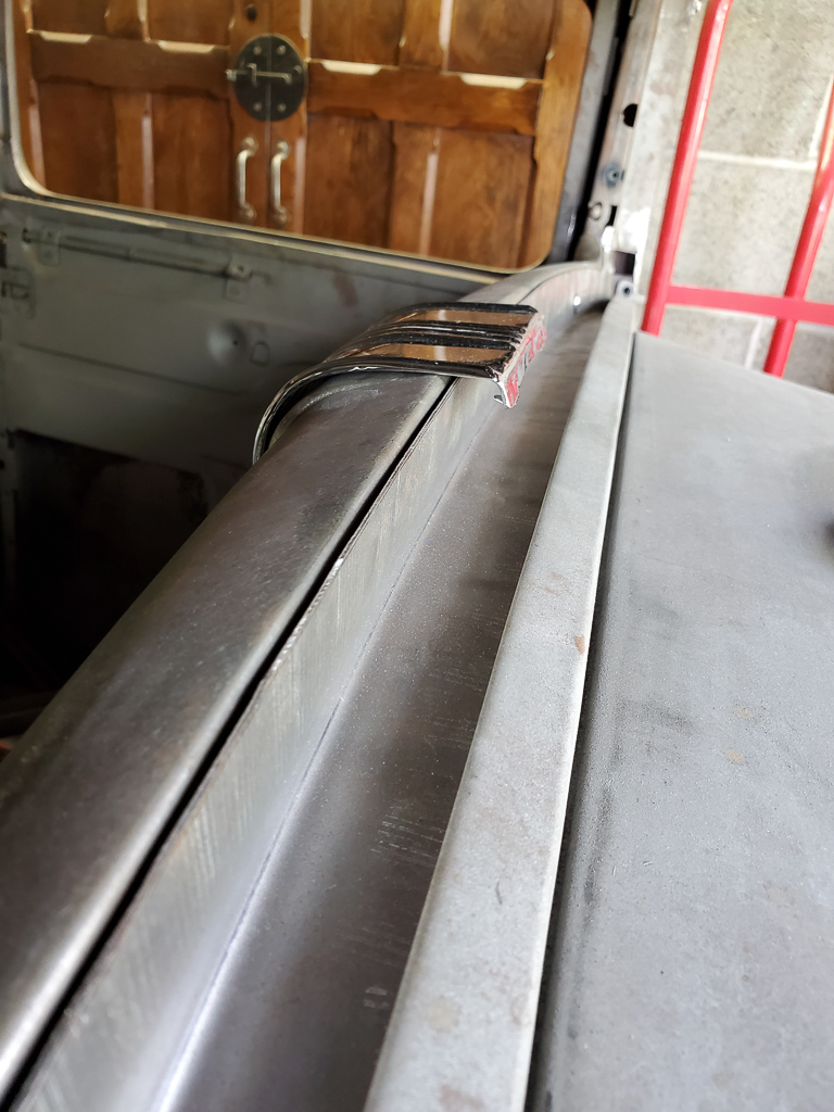

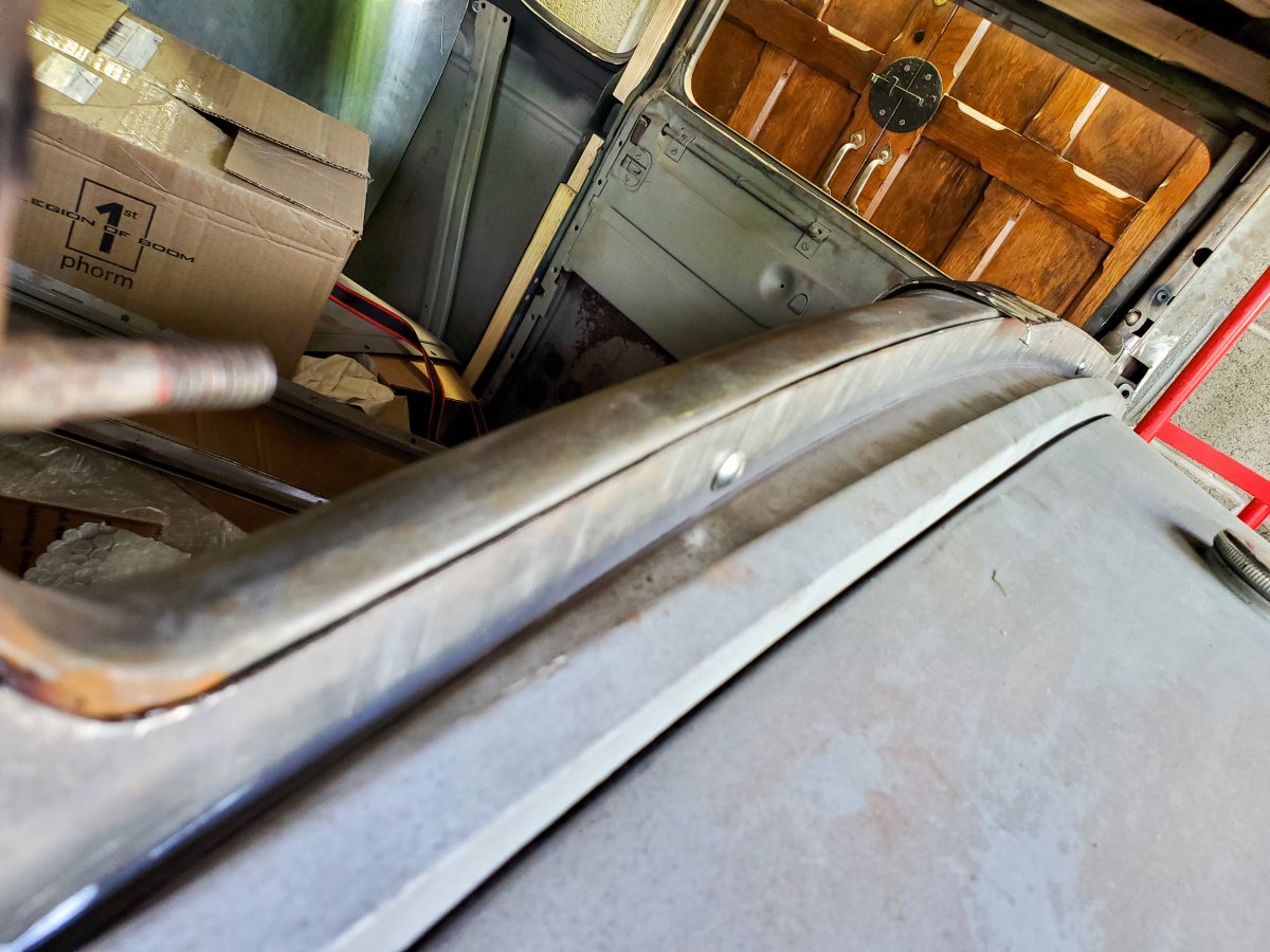

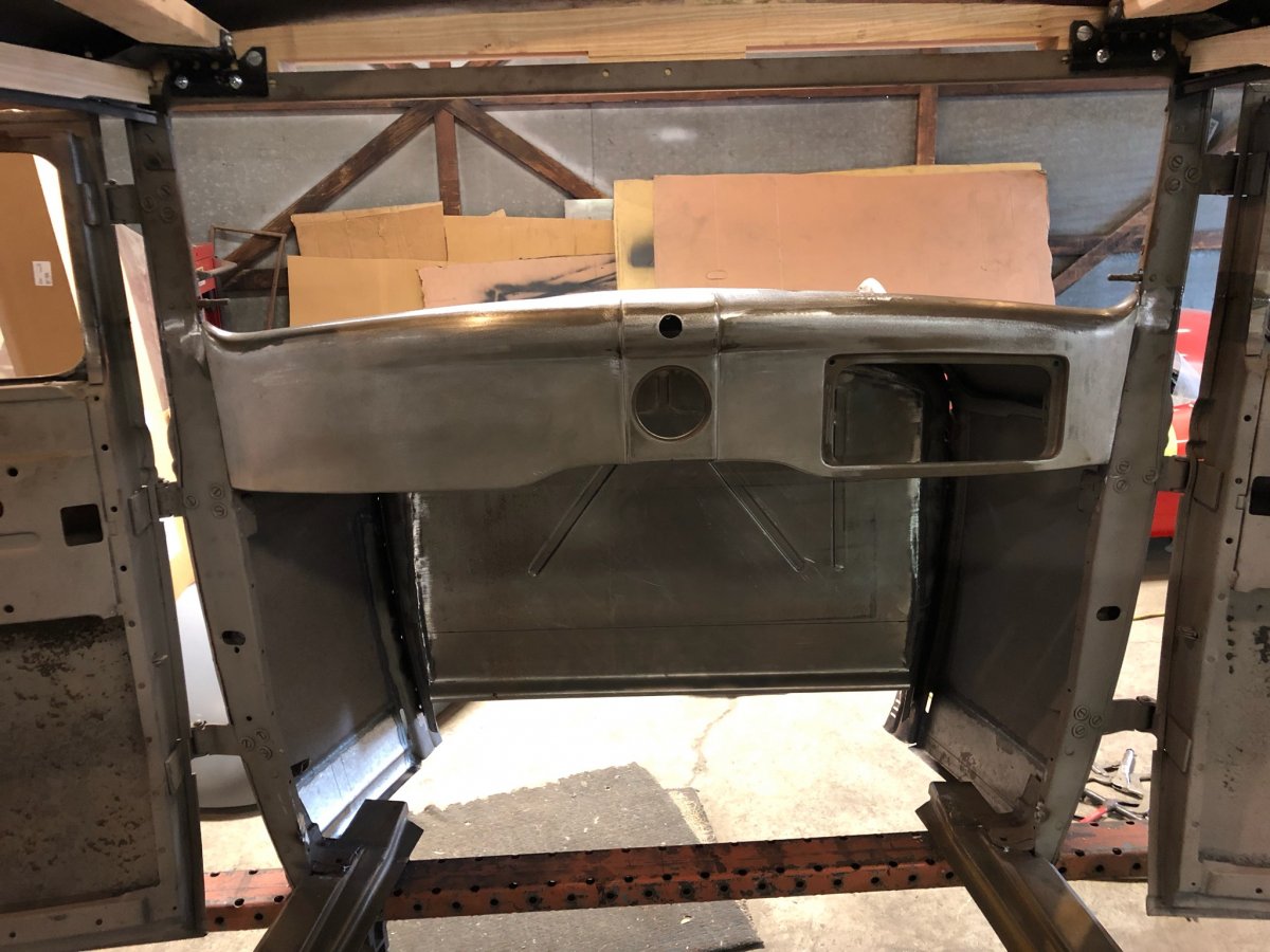

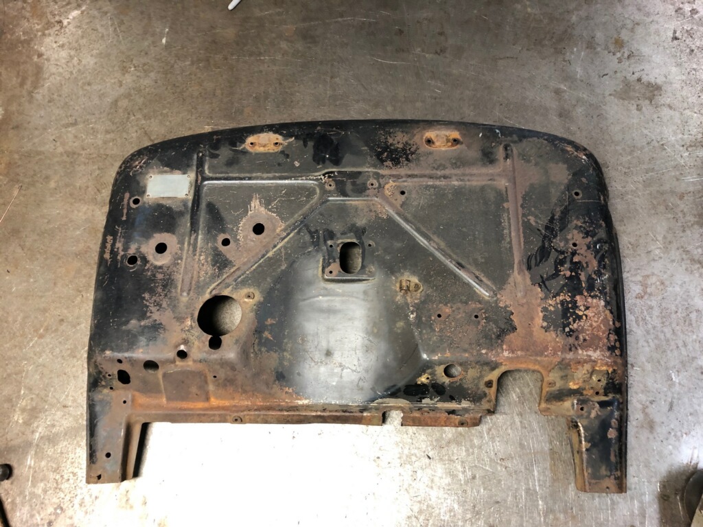

    Model A Reversed (Flipped) Firewall
    Up until that point, the coupe could've gone in any direction. The repairs were your standard Model A fixes.
    Now that the car had the subrails and patches pretty much done (the doors hadn't been done at this point)... now we could put some of the creative/distinctive plans to work.
    The plan was to reverse the firewall. However, I wanted a blank space where the hanging pedals mount. Matt and I bounced a couple ideas around on and he knocked it out. I tell you this, it's really important to be on the same wavelength.
    A spare firewall I had brought along. Good thing too, it was way better than the other.
    Trimmed away the perimeter and added some metal to the bottom.
    Created a new blank with a similar vibe to the A. However, it looked off, so Matt through in a bead that jutts up.
    Tacked in.
    In its home.
    Getting the feet situated.

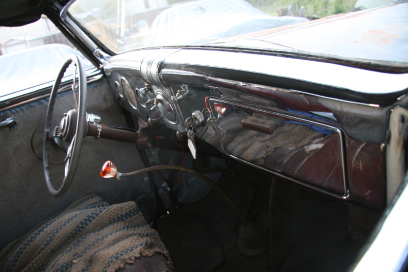

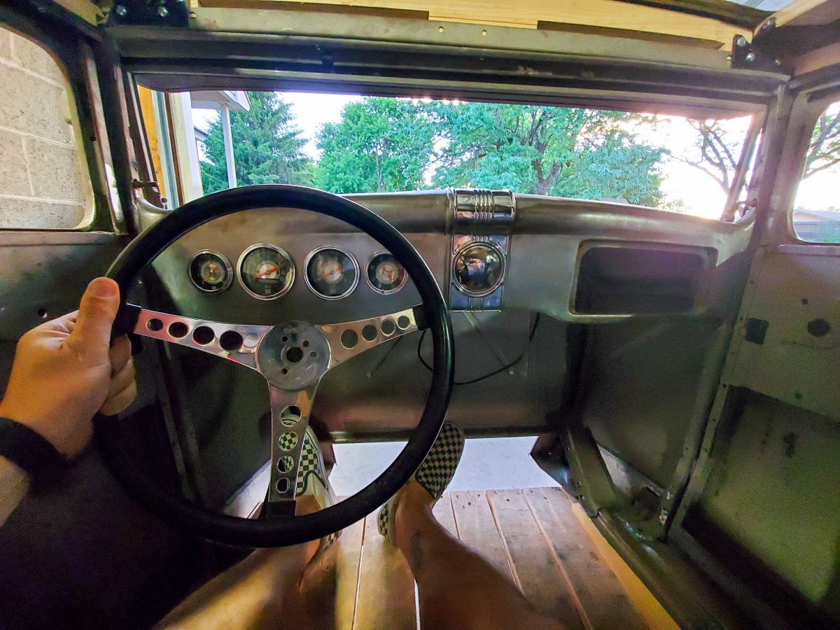

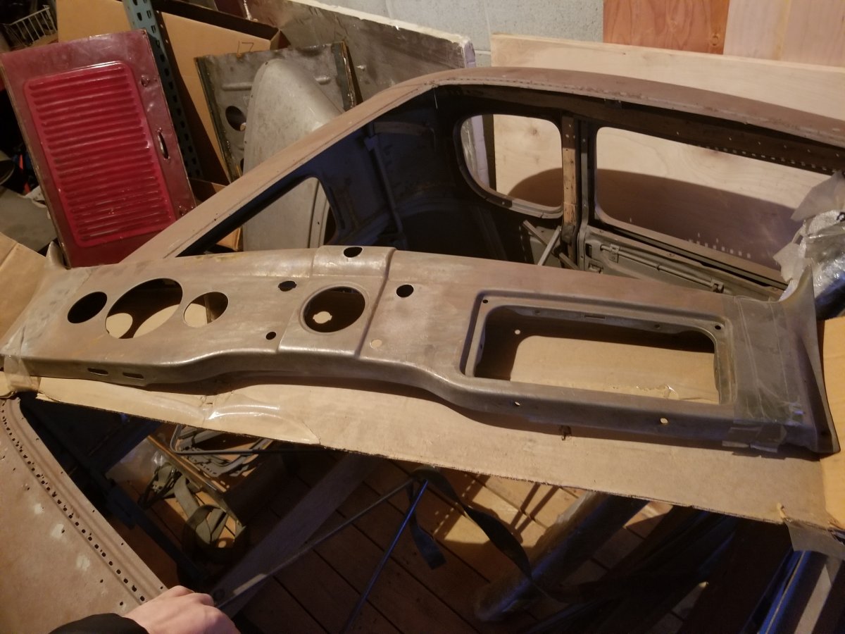

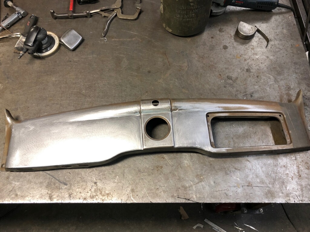

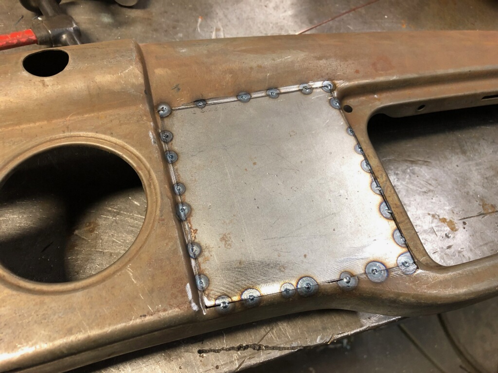

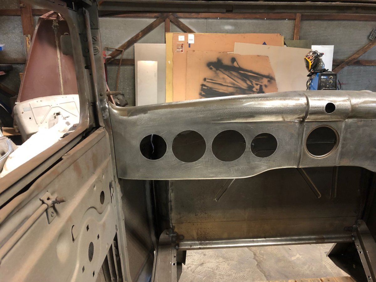

    The Dash: 1935/36 Ford Dashboard Swap in a Model A
    There are two cars that made me fall in love with 35/36 Ford dashes. One is John Joyo's 36 Cabriolet with the chrom dash and the other is @MR. FORD 's Model A. Mark was actually gracious enough to send me some detail pics a while ago.
    This pic doesn't do it justice. This old custom is such a killer car.
    When it comes to 35/36 Ford dashes in Model A's, it's not uncommon. Rather, it's pretty common. However beautiful these dashes are, it's easy to make them look a little off in a Model A. Mark's car nails it and he insists they just trimmed it and slapped it in.
    After studying dozens of Model As with these dashes, I had a pretty good idea of what I wanted to look at during all the miles I plan to drive.
    It's weird seeing it all blank like that.

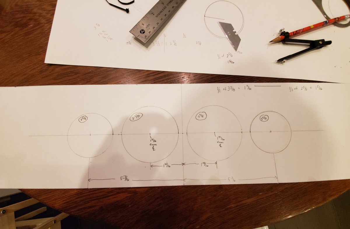

    1935/36 Ford Dash with Holes for Stewart Warner Greenlines

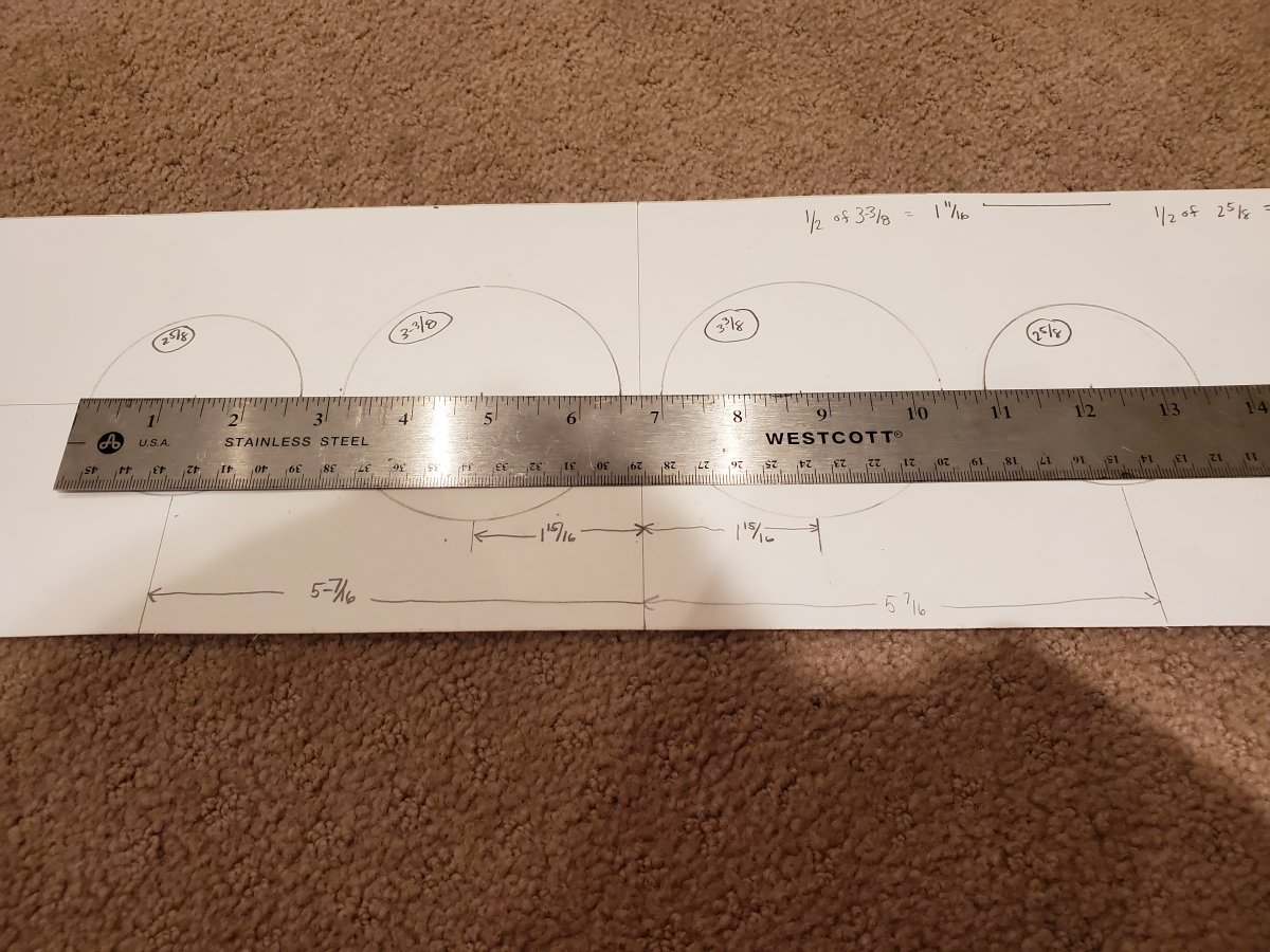

    I messed around with gauge layout one night when everyone was asleep and came up with layout spacing that I liked best...
    I'm not fancy or high tech. I just measure things out and figure it out.
    Holes cut in.
    Every other 35/36 dash in a Model A I'd ever seen has this gap and you can see everything behind the dash. Plus, my windshield was modified so the lip the overhangs this area has been removed (more on that, later). This filler strip will be chromed along with the dash (and windshield frame).
    This was our first attempt. The second piece goes all the way to the A pillar and sweeps up, like the dash (on either side). As well, the dent in the dash was removed.
    How it all fits and lays out.
    Daydreaming behind the wheel.

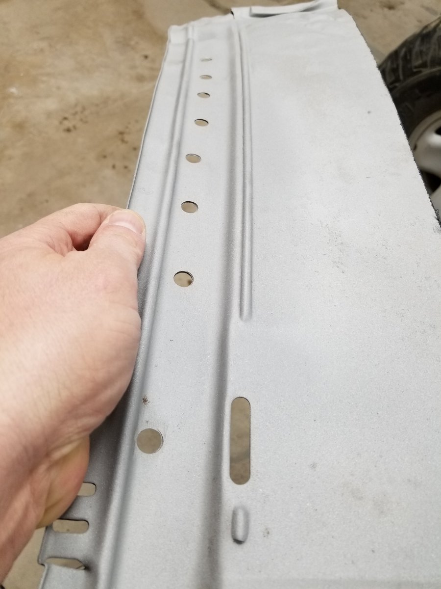

    32 Style Header Panel Insert
    From early on, I wanted a top insert. I'm still uncertain if it will get upholstered, paint or polished.
    I chose to go with a Flop style 32-style header insert. I originally bought one from Tom but didn't use it (it's been sold, fellas). Matt ended up fabbing one from 18ga.
    For some reason, the sheet metal that covers the wood header was too tall. I swear it was the one that came with the car, too.
    Who knows? It got trimmed and fit to the car.
    The windshield (and garnish moldings) were chopped around this time, too.
    From this vantage point, you can see the holes from the sheet metal top had been fastened. We should have filled them before I put the wood in.
    With every added part the car is getting more and more rigid.
