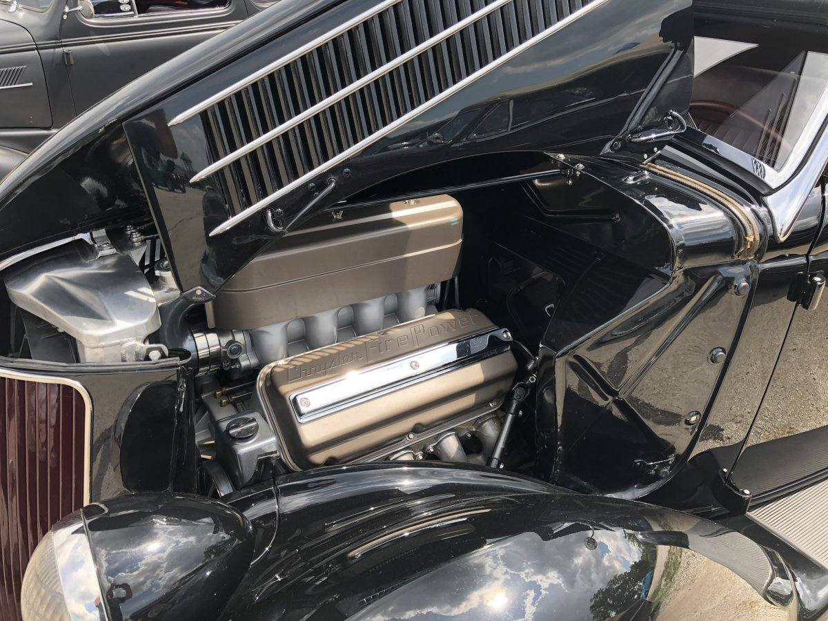

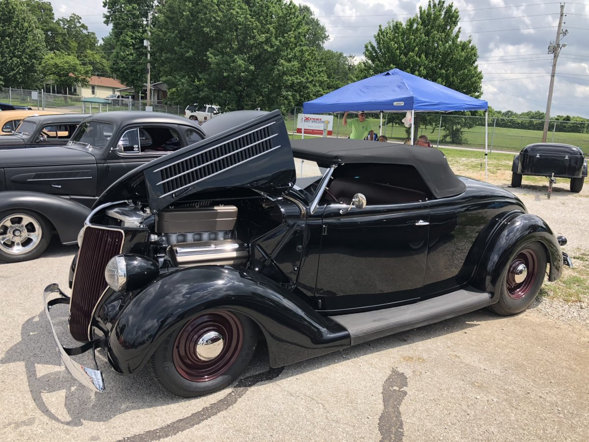

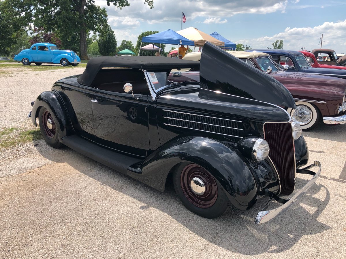

  20. spurgeonforge

  23. Fake hemi? Oh man, that broke the yolk. :(

    Yes he wanted an LS in it and and ask me to try to make it old. It was a lot of work to try and hide it. Thanks for noticing.
