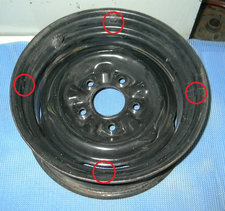

    jbh
    The wheels must be pre 63 and have the nubs around the permiter that hold the wheelcovers on. If they are missing, a small spot of weld can be added on at least four places. Jay

  6. jbh - what he said - see if the rims have the little nubs - about maybe an inch....should be about four I think....

    Yes, as stated the wheels must have the nubs on the rim, assuming the hubcaps are original. Also check the hubcaps and make sure the rolled bead on the mounting lip is not distorted or dented.

    Use silicone...the kind that comes in a tube...!!!
    Squirt three or four beads, almost in the same spots as on the wheel illustration above...let dry and they won't ever come off...of course, when you have a flat and want to remove them, you'll play hell getting them off...but of course, that's why you only squirt small 'beads' of it on.
