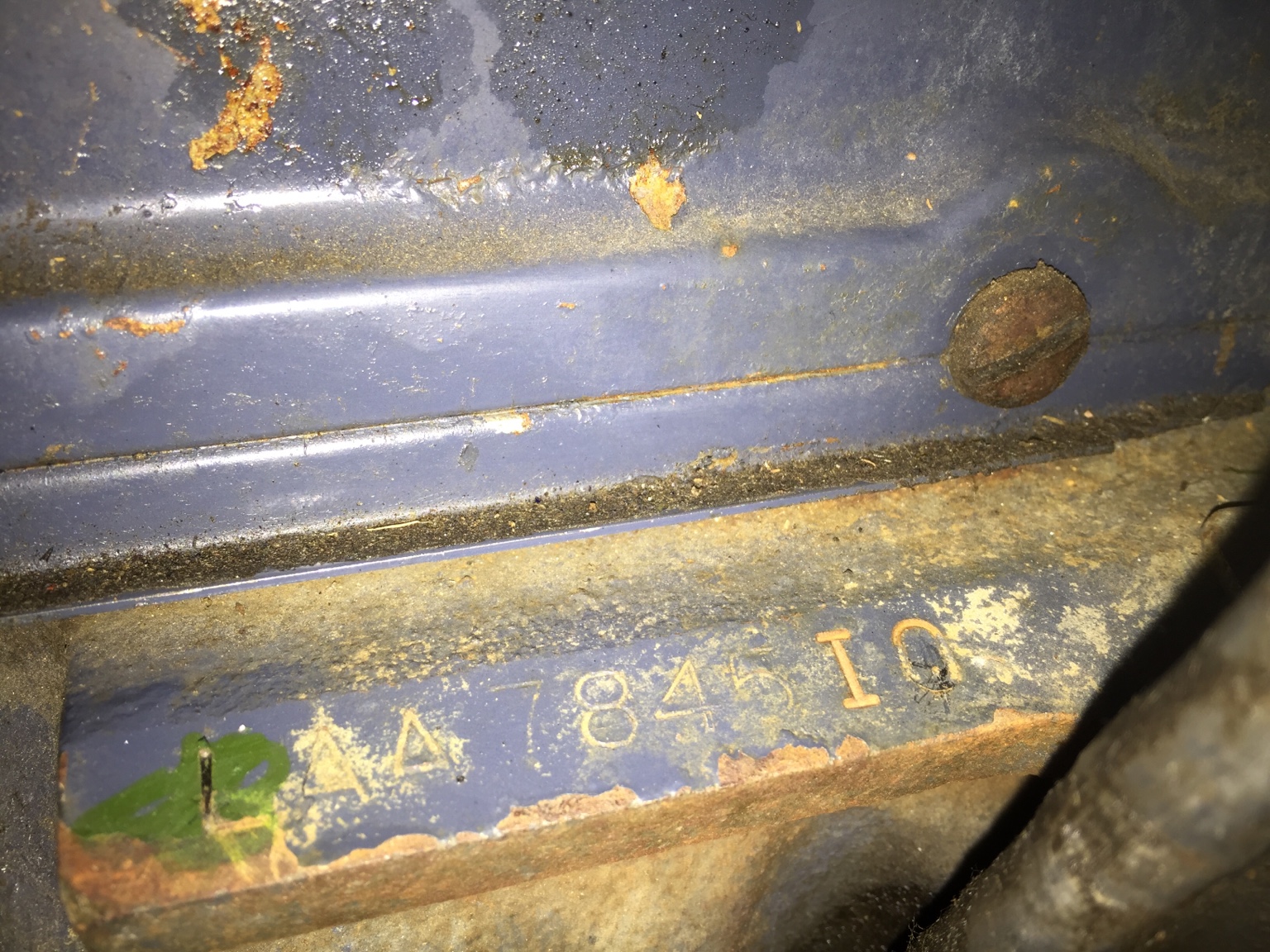

    Was told this came from a 50's Chevy truck. I think 1953 with a powerglide were the first for the full pressure oil system. Any gurus out there about to tell WTF this came from based on these numbers?

    you are correct about '53 235/PG being the first of the full pressure lube engines. Look at the passenger side of the engine. If the tin side cover goes all the way up to the top of the head, it's a 216.
    If the the tin cover stops at the block/head joint it's a 235......though maybe a dipper system.
    The driver side of the engine at the center bottom is a telltale for dipper or pressure lube....but I forget which is which.

    something about a pressure valve cover on the side of the block if it's a dipper? but I forget.
    Does that say LAA on the engine stamping?
    if so, that makes it a 1953 235 manual trans engine, which should be a dipper

    It does say LAA on the stamping. I'll take a closer look to verify the above information. Thanks fellas.

    Search for : Inliners International website. On the left side of their home page is a tab for a list of block and head numbers. Use the last six digits for the pics you posted. Look for casting # on head also, near #2 cylinder on driver's side. K6

    I am pretty sure that pressure oil 235 engines in 53 only came in cars with the powerglide. Trucks didn't get an automatic until 54 and then it was a hydromatic 3 speed. I learned to drive in one.

    Pretty sure this a 53 truck engine like Squirrel thought
