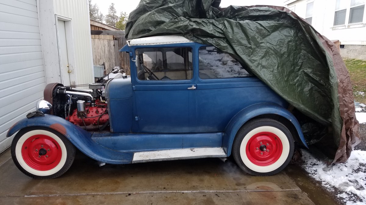

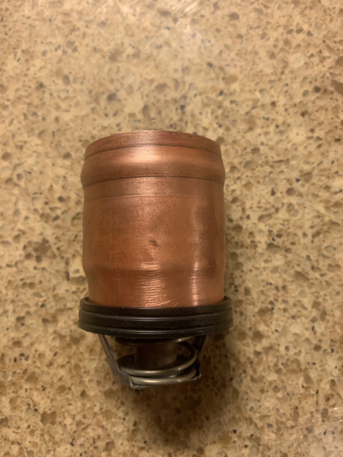

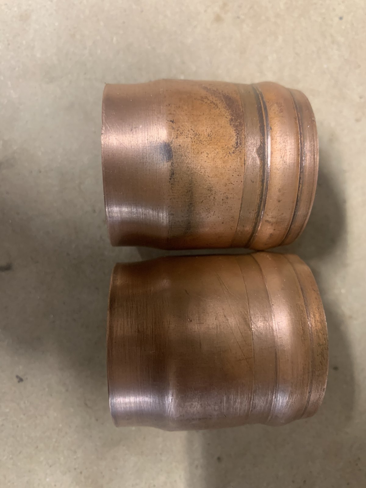

    Okay, I couldn't stand not going ahead and fixing this so I got out a big tarp and covered the car and rolled it outside. Drained the coolant, AGAIN, and pulled the upper hoses. Took the stats in the house and heated up some water in a gallon can, avoiding using the wife's pots of course! Both stats started opening at 170 as they should. Cooled until they closed and repeated. Both work perfect. Drilled an 1/8th inch hole in each and reinstalled, being careful to even locate the holes the same both in the stats and in their locations in the head. Filled it back up with coolant, noting that this time it gurgled as it filled telling me the holes were letting the air escape. Ran it for probably an hour or more and never got over 170 degrees and no blow-back through the filler neck! FIXED!
    Thanks again guys for the help. BTW, BJR, the tops of the water outlets on the 59AB are level so no problem with having hole at the highest point.

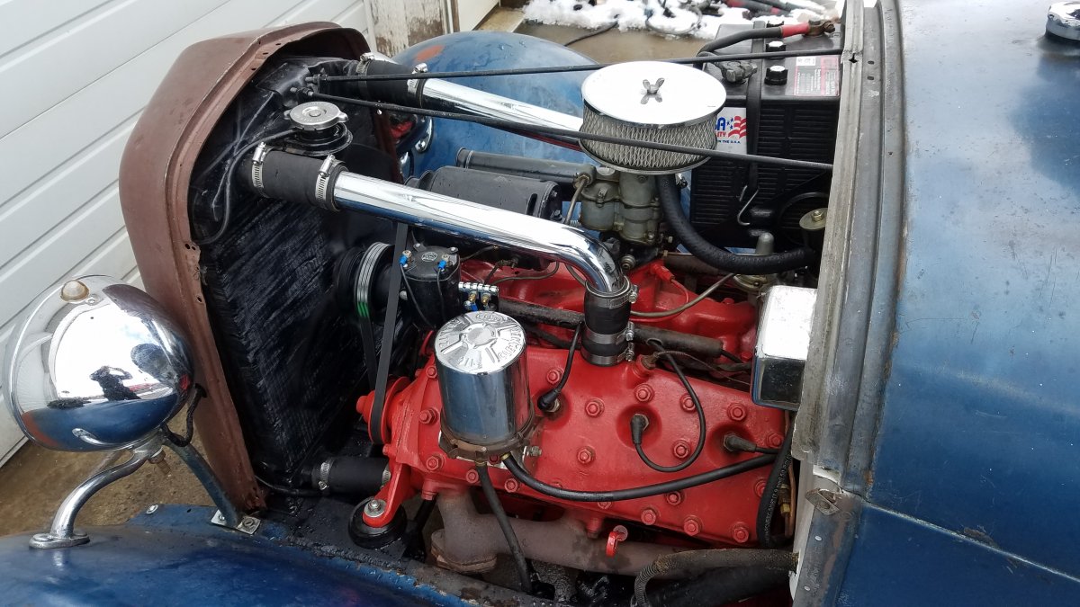

    Jeff34, yes I did. That's where I always put them. I use another hose clamp just above them to keep them seated.

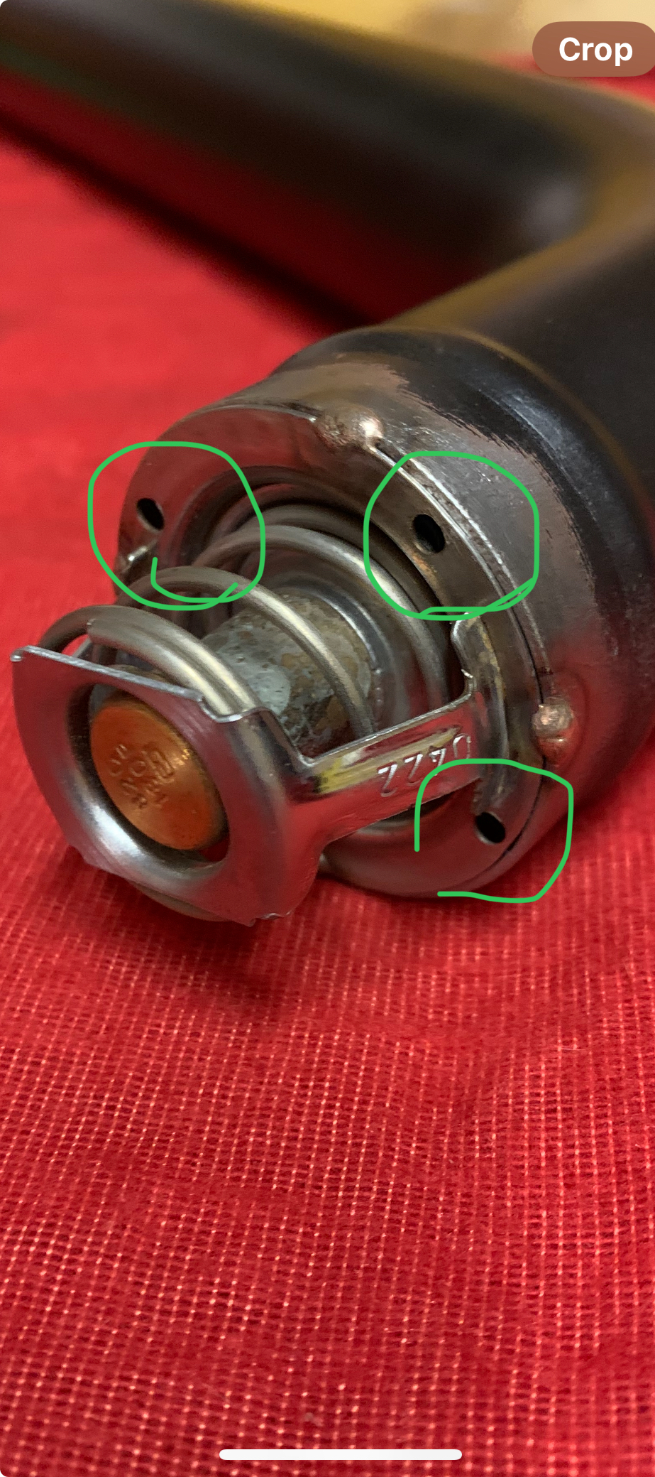

    Thanks, Dave. Been thinking about adding thermos to my 48 flatty. Just not sure how to keep them from moving around.

  22. sdluck
    Joined: Sep 19, 2006
    Posts: 1,930
    sdluck
    [​IMG]use 2 of these

    Jeff, if you look at the picture of my engine you can see the second from the bottom hose clamp just above the cylinder head. That one holds the stats in place.
    Also, I don't advocate putting the thermostats in the upper end of the hose or at the radiator as I think the coolant temp may be a little lower there than at the head. Who knows? Just my guess.
