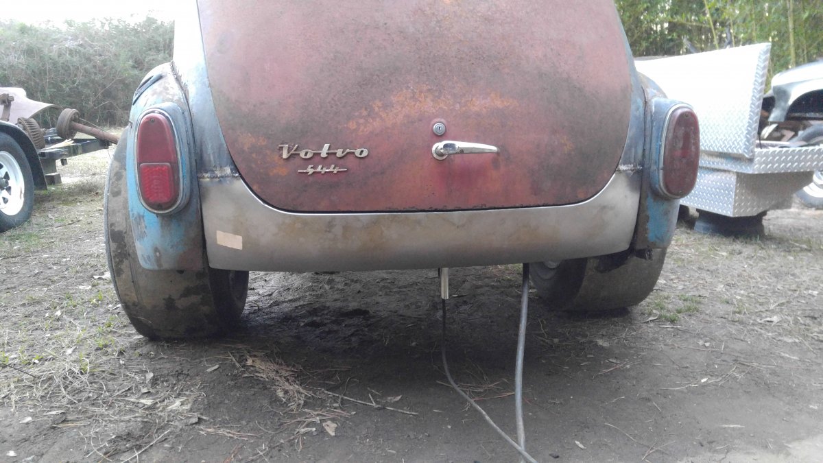

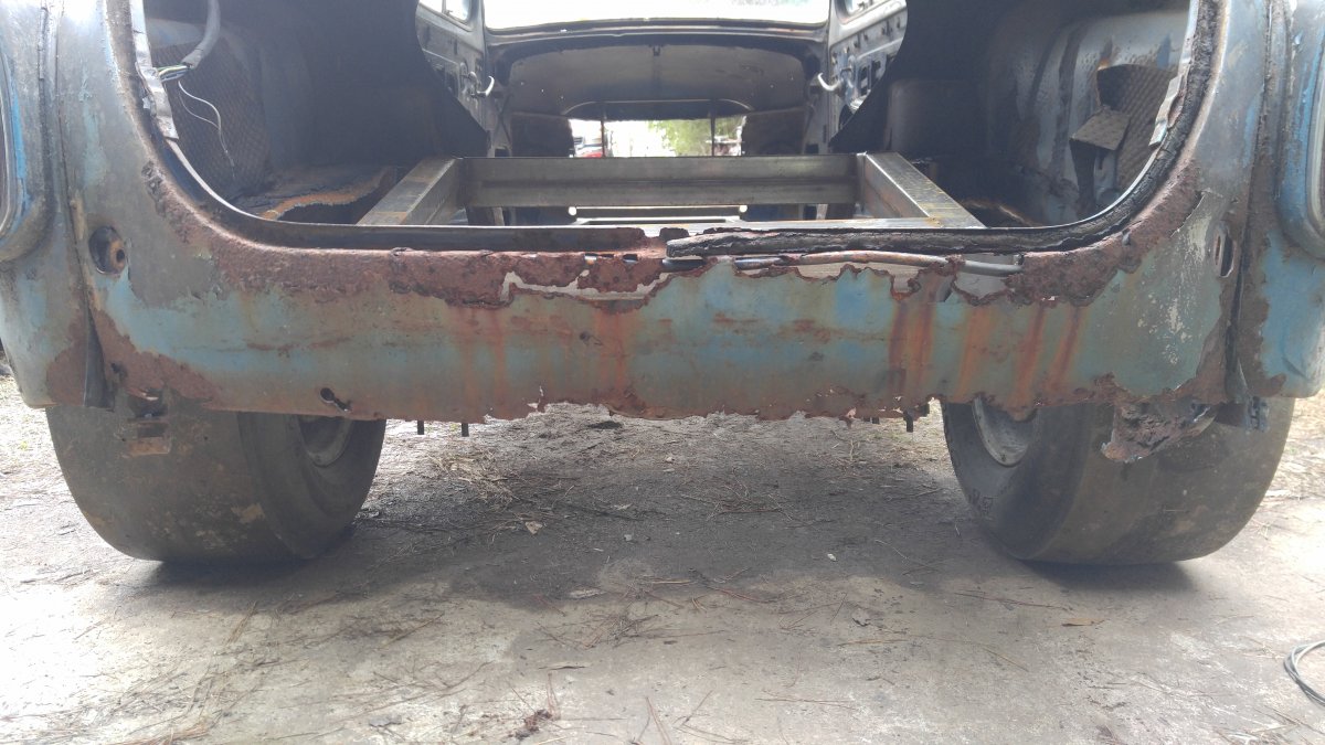

    Funny. When we bought it 25 years ago... it was absolutely rust free! Just had a little knock in the engine. Glad you decided to give it another life !
