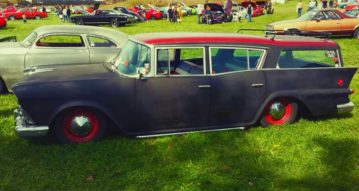

    Yeah actually project came together pretty good and I had it on the road in June 2019
    Motor fired and ran great. Ended up changed out the dizzy to an msd due to some issues with the accel.
    Got the interior done and in. In a very much AMC style red, white and blue.
    Wiring I did an all new painless style hot rod kit
    Painted the roof red metal flake but want to redo it so it's better.
    Overall still have some things to do this winter but it's on the road and driving. Something the car hadn't done since the early 90s so I would call it successful.

    Love the build, on the fence about buying a '59 wagon myself, but it's missing some misc trim, grille parts, and has significant floor rust, so not sure. LOVE these wagons, just so different, and funky!
  17. Rambler man Dan
    Joined: Mar 24, 2018
    Posts: 30
    Rambler man Dan
    Yep factory AC car. Was originally a southern cali car (apparently it's hot there lol) kinda funny they added factory AC but didnt pick an oil filter option on the original engine Priorities right? Yeah no compressor or condenser anymore.
    Thanks on the kind words. had alot of people tell me I'm nuts, like I don't already know that, for doing a rambler wagon. But I have enjoyed it so far.
    Just ordered all the control arm bushings and trunion thrust bearings yesterday so I can tighten up the front end. Also started fabrication on new lower shock mounts for the front so I can use regular shocks instead of special rambler, aka fairly expensive shocks.
    If your on the fence about a rambler just do it! You won't regret it... well you might but what the hell do it anyway
