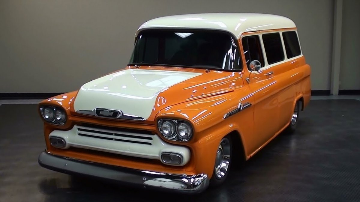

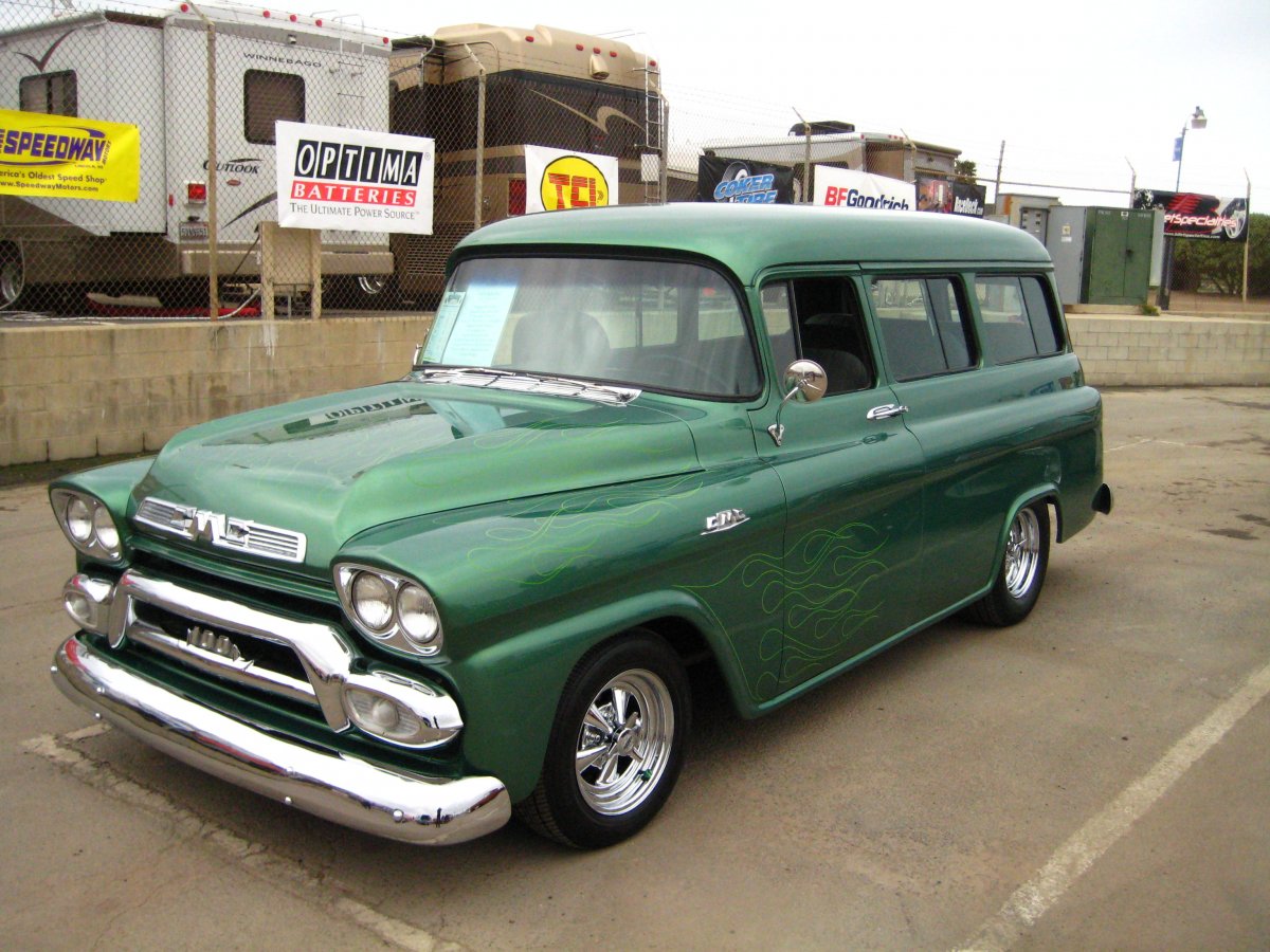

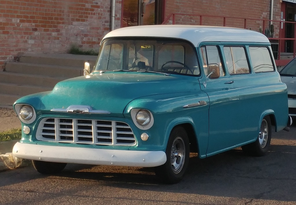

    I thought that Suburbans were all (or nearly all) 4 doors. Apparently not, as seen in the attached photos.
    That being said, Suburbans (if you can find them) are way more much money than panel trucks. Thus my thinking on adding windows to a panel truck.
    Squirrel, I'm seeing inset windows, but don't see compound curves in the side glass. Maybe the inset makes up for the curve? So in my case, plexi might work better as it could take the (apparently) gentle curve of the side panels?

    The metal panel has a compound curve, the glass is flat. Originally they had a fixed window and a slider, and the frames that hold this stuff tend to rust out. I put solid glass in my 57, got rid of the sliders. The mid 60s Suburbans were made with solid rear side glass and sliders in the front side windows, I had a 66 like that...so I learned that I could use the rubber for a later one to put solid glass in the 57, and it worked out pretty well.
    If you put plexiglas in the side panels, with a typical rubber gasket, it will look like crap. Seriously.

    It looks like the orange and white example I found may have started life as a panel truck, and had the side windows added? That glass looks more flush than the factory set-up. This is the look I'd be going for. So perhaps the key to pulling this off is to find the right rubber, and not use a universal seal?

    I think that one is a suburban, but might have larger glass, glued to the outside of the metal lip of the window opening. Like new cars are built. The rubber I used sets the glass behind the lip, as original.
