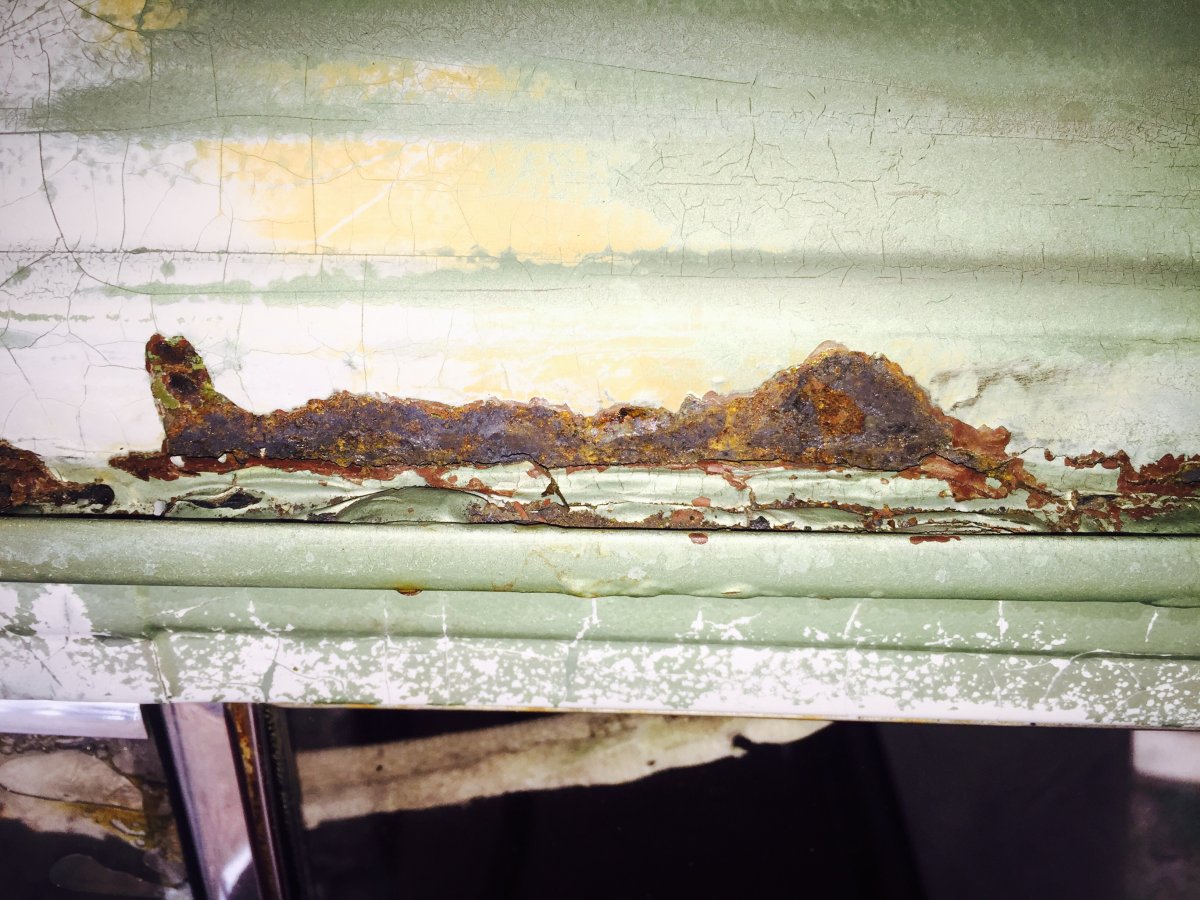

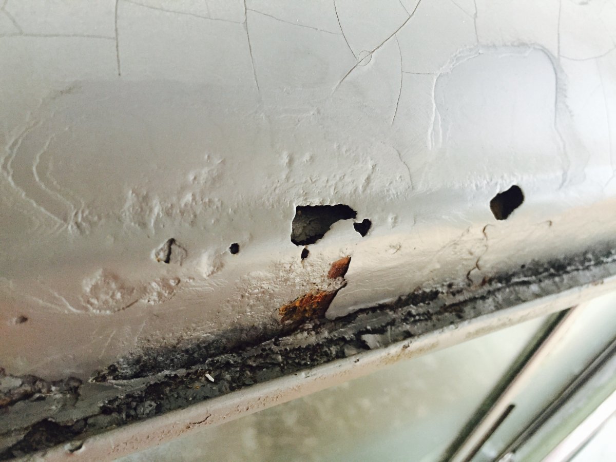

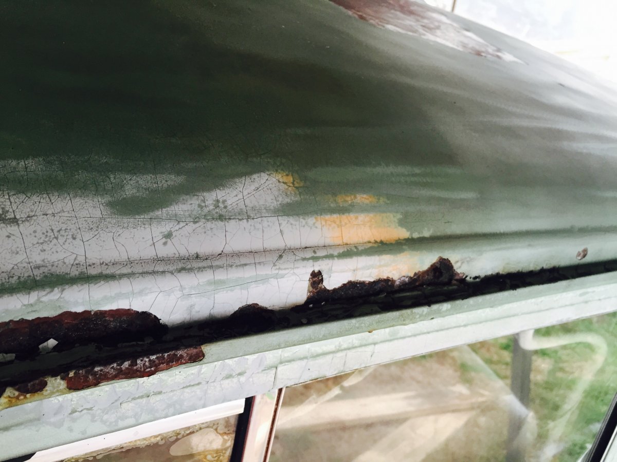

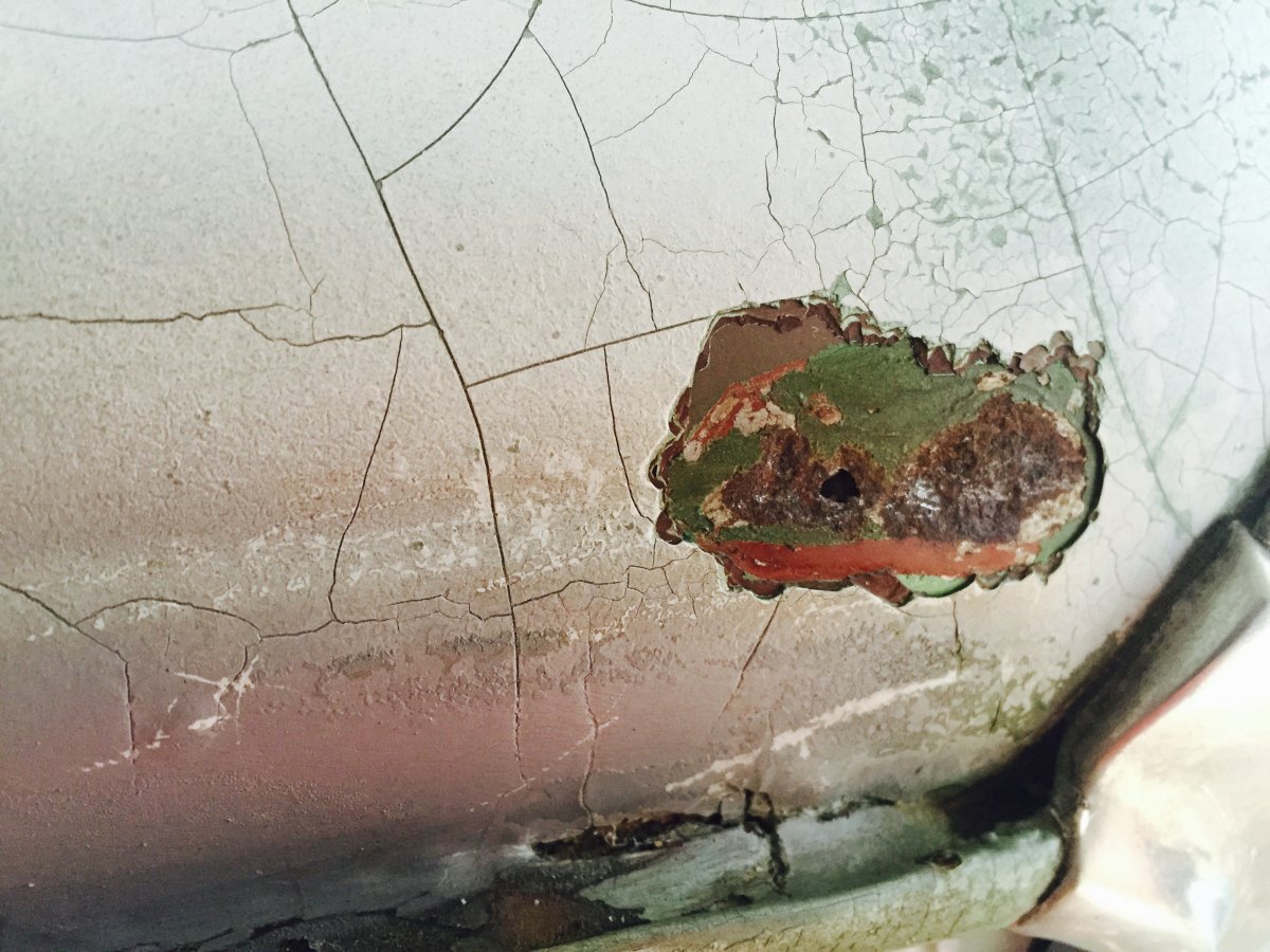

    Hello again all. I made a post back about a month ago introducing myself and this old gal... She's a bit rusty... But she's mine...
    I have decided to go ahead and jump on the work. I can't stand just watching her sit and rust. Now as I said before, I am a novice when it comes to working on classic cars... I appreciate them, I am mechanically inclined, and I know my way around several important techniques... That said, I'm not sure how good I am at evaluating the state of a vehicle body and what steps I need to take first... I'm not one for having to do work over again... I'd rather get it right the first time when possible... So I'm hoping some of you can offer me a little advice.
    Given her condition, it seems like a great place to start is the roof. (We won't even talk about pans or rockers...they will be replaced) image.jpg image.jpg image.jpg image.jpg image.jpg She has rust holes all the way through... A fact that was hidden pretty good by a not-so-good bondo job...Here you see what appears to be body filler smeared over what appears to be poorly treated rust ... If it was treated at all. Follow that up with what appears to be a drip edge filled with window caulk...who does that? Is that a valid repair?!...anyways, she won't be venturing out from under the roof until hers is up to par... Now the question... Given the damage and my entry level budget, would a glass repair be in order until I can either replace the roof (if I can even find one)... Or should I bite the bullet and have it cut out... As you can see in the picture, there are some body lines to deal with... Then the other question... This was my first classic... I think I got a decent deal on it... That said, is this level of rust on the roof an end game? Thoughts questions comments all appreciated. Thank you for taking time to ready and throw in some input :)

  5. First things first . Get a grinder going and grind off all the filler from around the drip edge area . That will be your starting point . You need to see what your after !

  7. I'd look for a donor roof... that one's pretty bad. And the 'caulking' is factory, Ford used sealer at the drip rails during that era.

  9. That repair may not be as bad as you think. I just did this over the drivers door on my truck, first scrape out the caulking, then grind out the old bondo so you can how big of a patch you need. Basically you need to make a patch with a flange on it that can be spot welded to the driprail. You will have to learn to make patch panels at some point,might as well do it in an area thats easy to access and see. Its intimidating at first but we all had to learn at some point. I screwed up lots of stuff, still do. But in the end try to do it as proper as possible and you can look back and be proud. Sweet car by the way. :)

    You can fix anything if you want to bad enough.When fixing rust like that remember to multiply what you can see by 4 or so.I had an OT car that had that sort of roof damage.I cut out all the rust I could find,welded in new metal and 6 months later it started to come through(this was long before POR 15).I should have taken the roof skin off and fixed the mess underneath first.You might keep that in mind.Live and learn I reckon.keep in mind that you can drive the car while fixing it.That (at least for me) helps a lot on big jobs like that.The people on this board are incredibly helpful.If you want to learn a LOT about sheet metal repair in a hurry read Big A and Finnrodders threads on their shoebox Ford builds.

  20. Oh man, thats alot of work but its doable. You will need to remove the front and rear windshields and headliner.
    Then buy a bunch of drill bits to drill out spotwelds.
    when the skin is off you would probably find that the flanges(pinchwelds) may need new metal welded in, at the very least have it sandblasted and epoxied.
    You can remove some interior panels and check what that area looks like before removing the skin. I usually do the screwdriver test on something that im unsure about

  22. Being it's a 4dr, I can't believe that finding another roof would be that difficult. You may have to do a bit of a search, but a rust-free unit will save you a ton of time. And I don't think I'd skin it either; that's rotted from the inside out, so you know the inner structure is every bit as bad as what you're already seeing. Better to pull the glass, brace the body, and just chop it off at the posts and weld a new one on.
