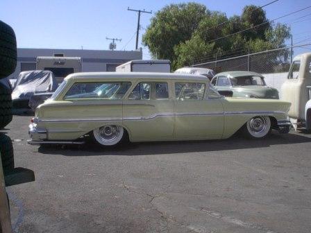

    On my 58, I have the Mcguagys (SPP???) spindle/disc kit and the turning radius SUCKS!! Supposidly, the kit is for 58-64 and the 58's have a .5" or 1" narrower track on the front. So with the universal spindle, it puts the wheel out too much. It takes a 2-3 point turn to get into a parking stall sometimes. But, looks kool though! Supposidly (again), you can make spacers to use G body brakes and bearings on your factory spindle. Might check into that though.
    Here is where mine sits with spindles and cut coils.
