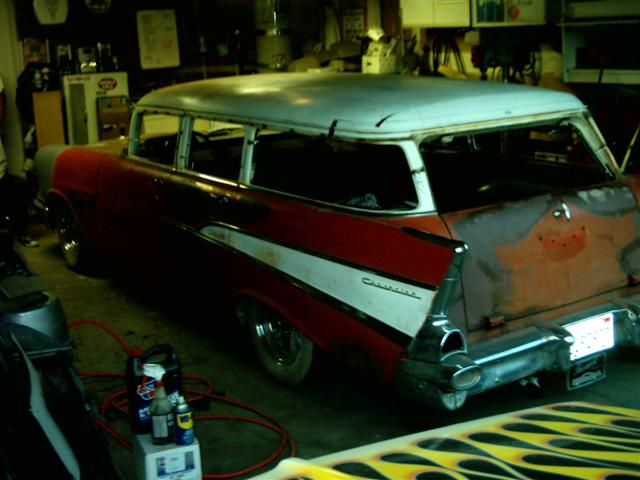

    OK the cats out of the bag...it's a weenie chop ...2" but I didn't want radical...I wanted classy and proportioned. Still have tons of work but it is all tacked together.

    Looks good, if it's a 2" chop you might be able to use a coupe/conv windshield...

    Very nice. Are you going to sink the windshield into the cowl ?

  11. probably all welded by now but the hardtop/conv. windshield is 2 inches shorter that the wagon. the quarter (the radius moves a little to the rear) and backglass are laminated and can be cut. all the rest of the glass is flat no problems.
    glad to help if you have any glass questions
    "The Old Car Glass Guy"

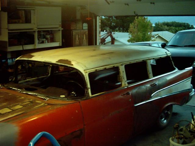

    A lotta guys say" hell, if you are only gonna chop it 2 inches, Why bother?"
    Your wagon shows why we SHOULD bother. Sometimes its the subtle stuff that really makes a car pop. BEAUTIFUL !

    Most Tri-Fives look like shit with chopped tops, IMO. 2 inches is perfect. A big chop on those cars just screws up the proportions. Great work, keep posting the progress pics!

    No not sinking the glass...I am planning on trimming the corners a little and making it fit.

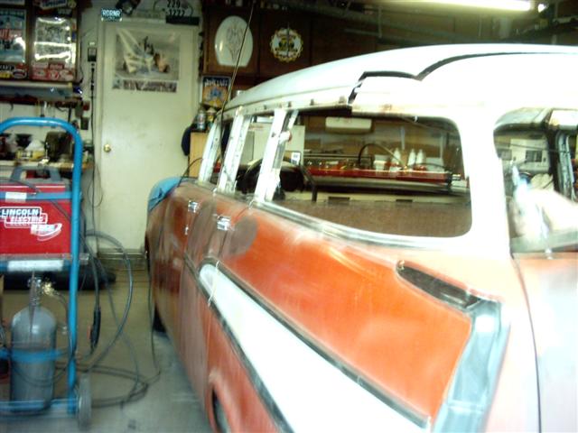

    ya know the funny thing is ..this was a very easy chop...I just had to move the windshield posts a little with the porta power (very little) and I just have to fabricate 2 filler pieces where I stretched the roof above the rear window. If I was doing it again i think I would have cut the ass end of the car off and slid it all forward a little over an inch...more work but it would have been a neat detail.

    I was always under the impression that the back glass(for the liftgate)
    was tempered? and couldn't be cut. Am I wrong here?
