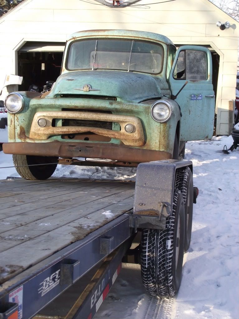

    I found this beauty while installing windows for a homeowner. I proceeded to swindle him and got a sweet deal.
    Roads weren't too great on the way home.

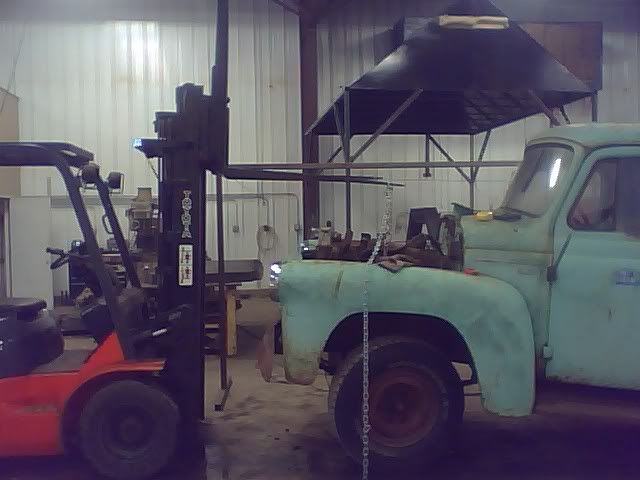

    Clearly I have more than one project going on this winter.

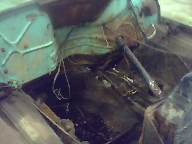

    Engine is wedged in there good. Is my truck floating?!?
    One large wack of iron. It is probably scrap since the third cylinder was full of water.
    Anyone think that old six cylinder is worth keeping around? or should I start getting some of my money back in the scrap world.
    The patient is all prepped to receive the heart transplant!

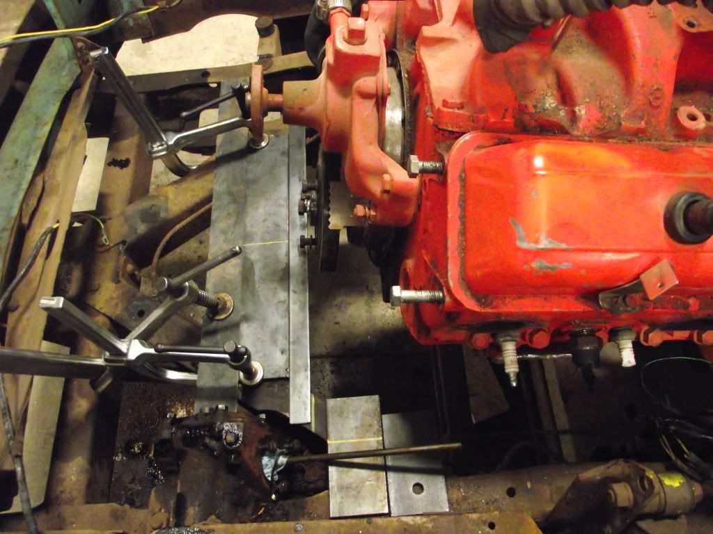

    327 Mild cam and high compression heads - nothin special.
    I finally got the engine centered, front to back

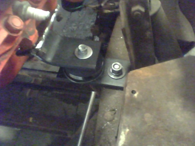

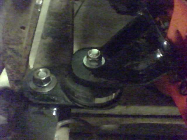

    The start of my mounts.
    Here is the rear cross-member. It still needs gussets.
    These are some of the pieces I have cut for my engine mounts. I still need to bend them and round the corners, but I am all out of oxygen. Should be here on Tuesday.
    These washers are a temporary mock-up of my rubber biscuits that are on order.

    First time I've seen an engine/trans pulled with the driveshaft still attached!
    The steering shaft can be routed around the exhaust with 3 U-joints. We put a Hemi in a similar 'Binder years ago, but we put a '39 IHC box behind the axle. Lots of room then!

    I'm not an International expert by any means, but I thought the '57 trucks had headlights like this:
  6. 1952henry
    Joined: Jan 8, 2006
    Posts: 1,365
    1952henry
    Just as Chevy pickups had a first series 55 (AD)and second series 55 (TF), IHC had a first series 57 (S-series) and second series 57 (A-series).
    The transmission may be a T98, could try to peddle that on the OLDIHC site.

    Yeah that's what i figured on doing with steering shaft knuckle over knuckle down knuckle back.The motor says 220 on the pan how much does something like that generally go for? Can probably get $125 at scrap yard.

    These are the pieces of 2 1/4 x 3/8 steel I am bending for my motor mounts.
    Here is the finished cross-member and bent motor mount pieces. Still have to drill holes. I'll need to cut the short side on an angle so that it can mate up to the plate on the side of the engine that is at a 5 degree angle.
