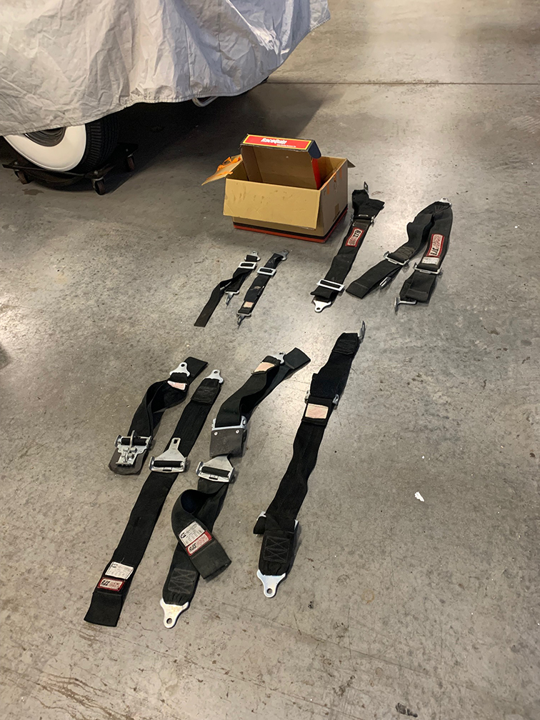

    Lastly,... Yours truly. Mr Cheap ass... is going to install seat belts.. and I have never used passenger car generic ones.... but I bought some used race belts..... that just recently expired.... I think I may piece together some lap belts.... I really liked @bobss396 placement of belts in his oh so fine 59.
    I spent a total of 5 bucks for them.

    The race harnesses expire after 2 years unless you send them back to the manufacture for a re-certification. I bought a set of slicks from a guy a few years back and he threw in a couple sets of lap belts like yours. I like the look also, rather than some crusty belts from a 45 year old Maverick

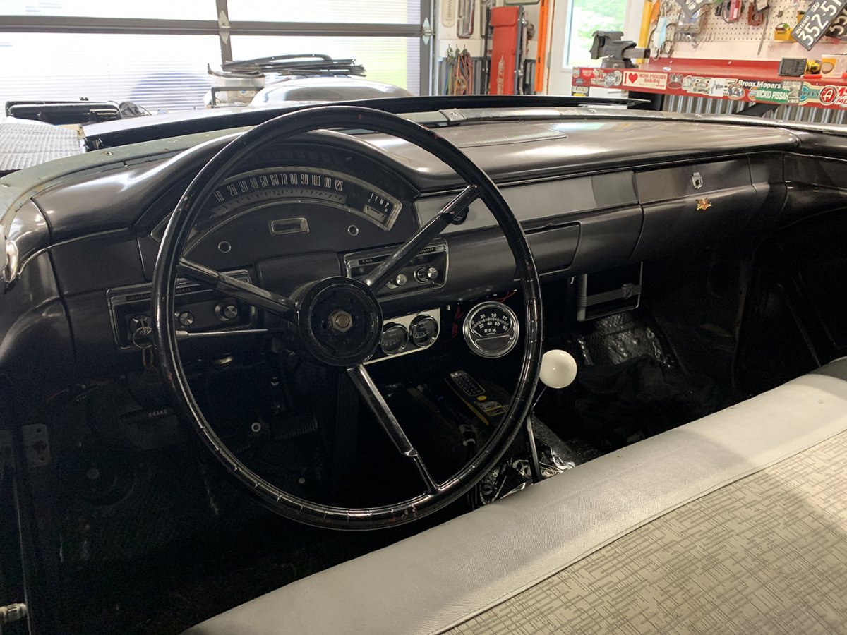

    chryslerfan55, enloe, Deuces and 5 others like this.
  20. Jeff Norwell
    Joined: Aug 20, 2003
    Posts: 13,936
    Jeff Norwell
    MODERATOR
    I sure wish I did,....I managed to get one for the Black 428 car....but I need one for this car.....
    are you teasing me?
    hahaha

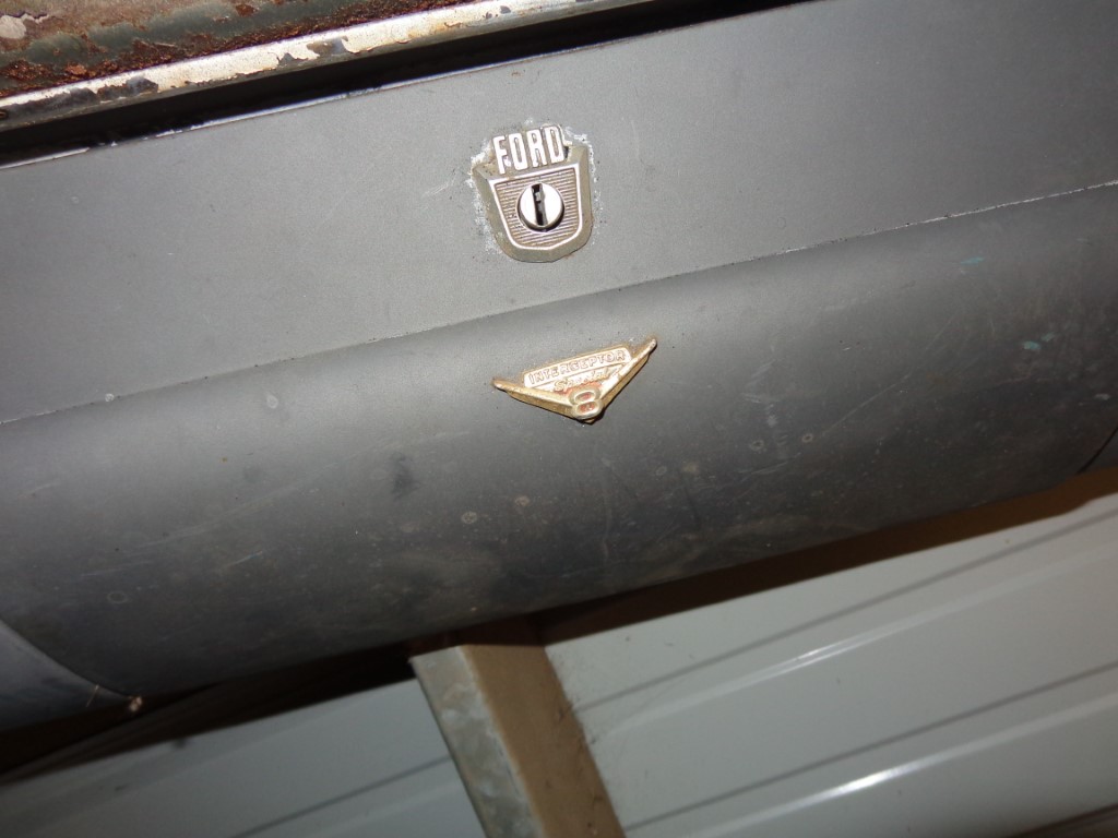

  21. Jeff, I removed that dash from a 58 4 door sedan that came with a 332, 3 speed od and 4.11 gears. I'm saving it for a project. I do know that there are 2 different emblems. The one I have is for the lower horsepower version. The other says police interceptor special. I have only seen the police special on 58's. I don't know if they were on 57's. My brother's 58 had the 352 and the police special emblem. I hadn't thought of selling it but if I change my mind, you will be the 1st to know. I didn't mean to mess with you. :)
  22. Seat can stay, at least in a ‘58 it can;).
    Unless my parts car is so rusty the seat has settled some!!!:D
    Jeff Norwell, tomkelly88 and Stogy like this.

    quote wfo guy: ".....police interceptor special. I have only seen the police special on 58's. I don't know if they were on 57's."
    The Interceptor designation was for the 352 (FE). The first year was 1958, so no, they wouldn't have been on '57s.

    Yes.. they made the dash emblem for 57....but of course it was for the 312 Police package.... A different styled one..... not really clear.... but I have a NOS one on my other 57 custom.
    @wfo guy
    All good.... I'm always on the hunt for the obscure details.
